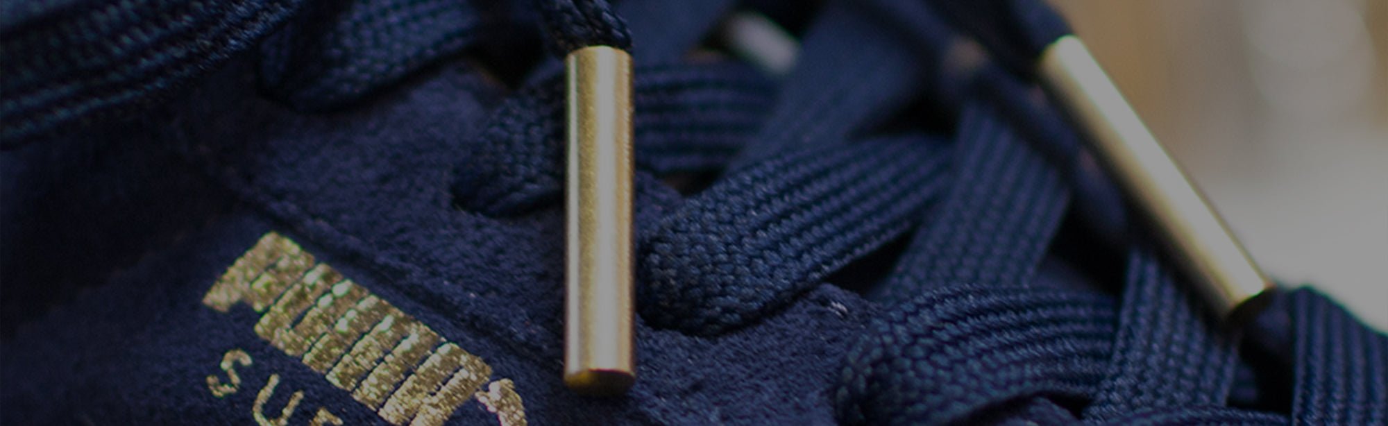

I’ve been looking into this, too. So far the cleanest option has seemed to be buying solid eyelets and gluing them on. I believe the ones Angelus resells work this way:
I have used some crimp-ready split aglets with a bit of rubber sheet in some large pliers. But they were pretty ugly to begin with, and didn’t get much prettier. Worked fine, but more heavy-duty than refined.
Thanks for the reply, I will try to post some pics of the way I do mine, unfortunately I keep a lot of materials in stock already. At roughly 1$ a piece these from angelus are out of my price range.
