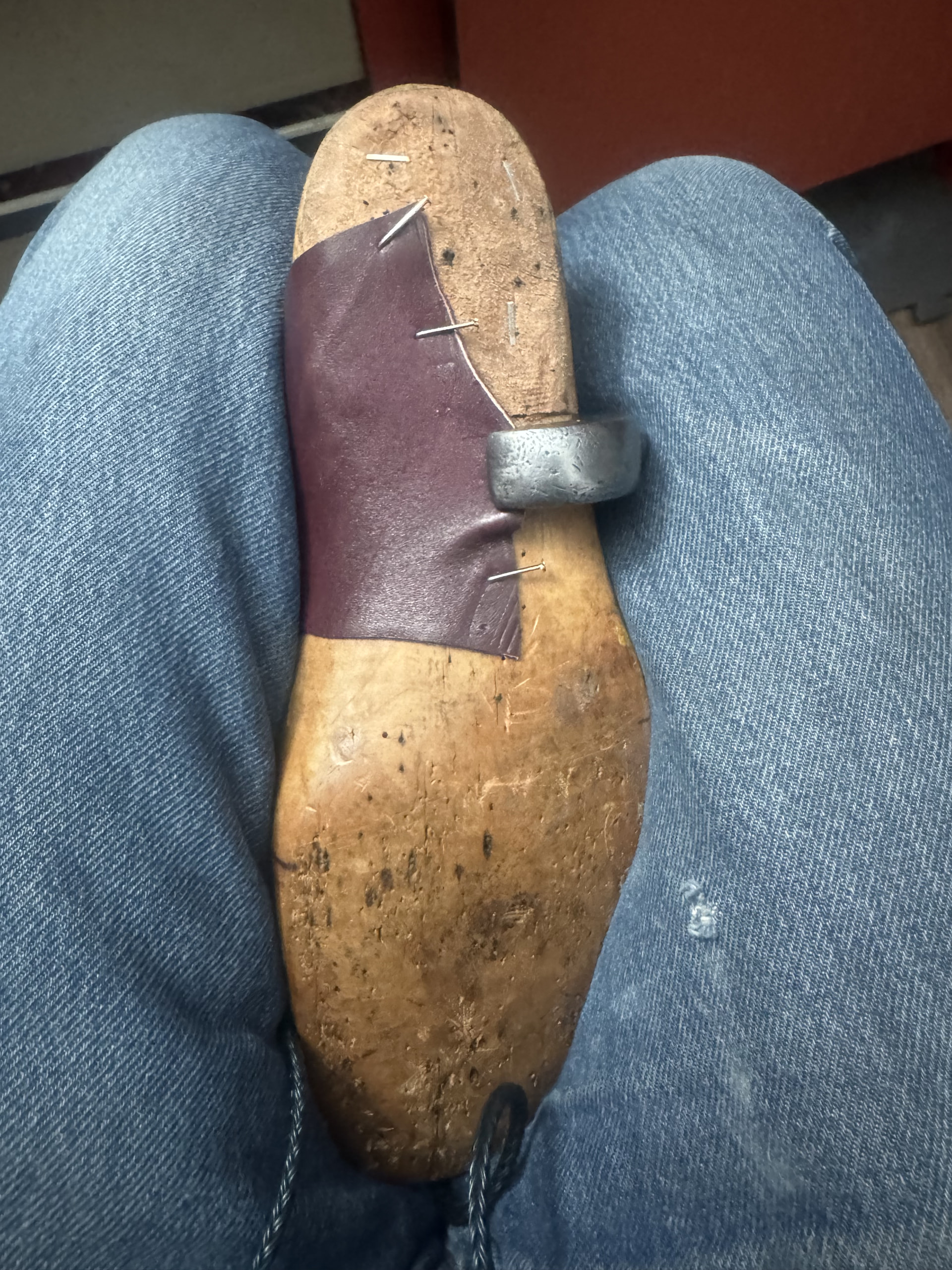

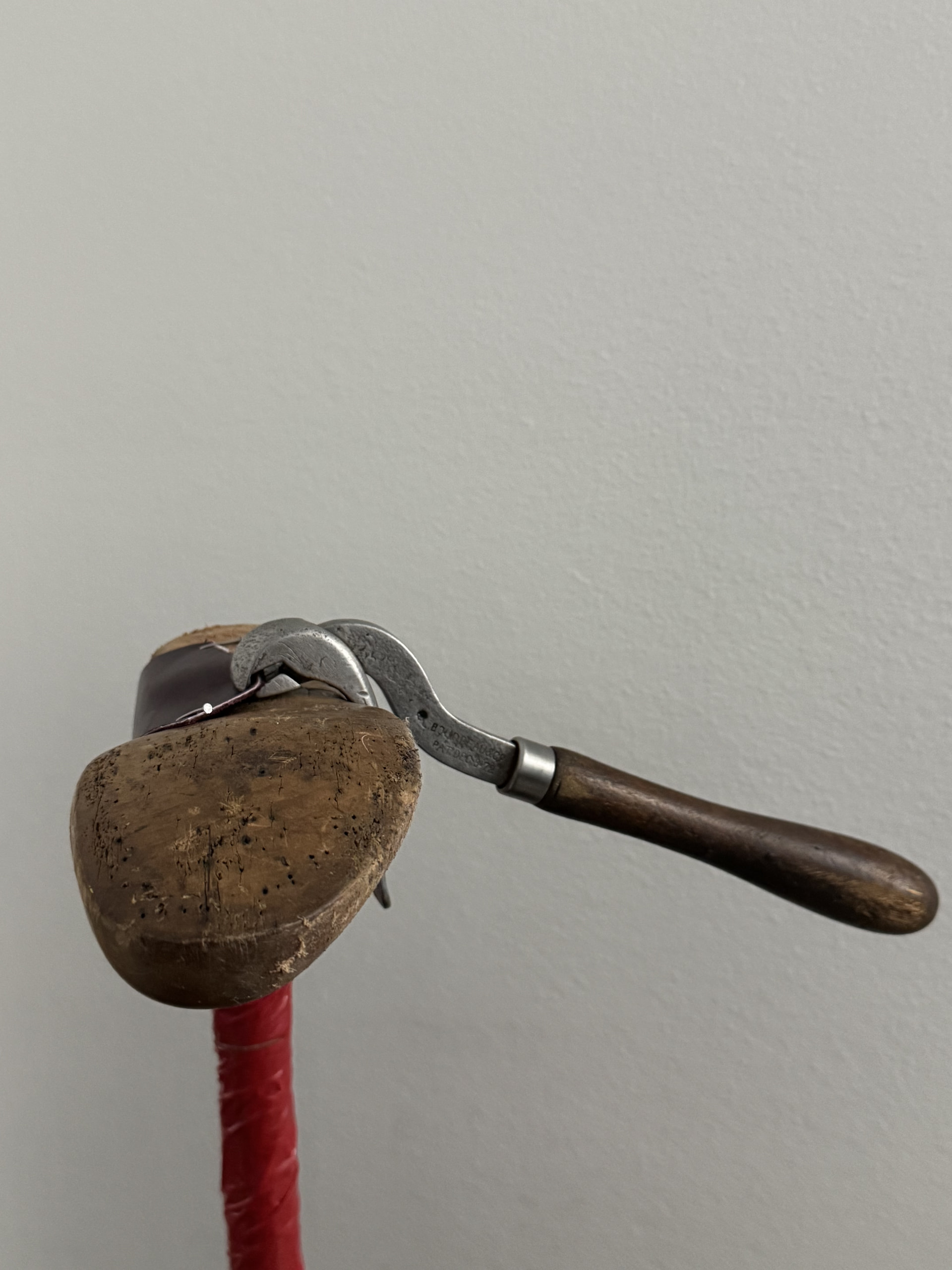

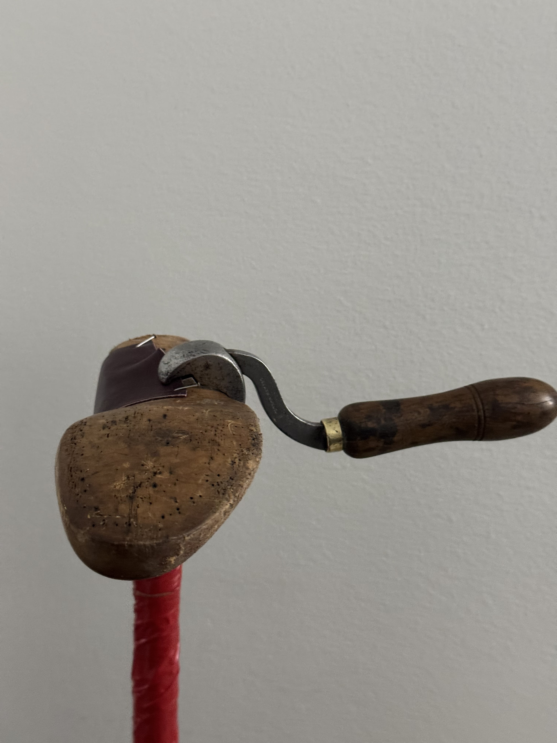

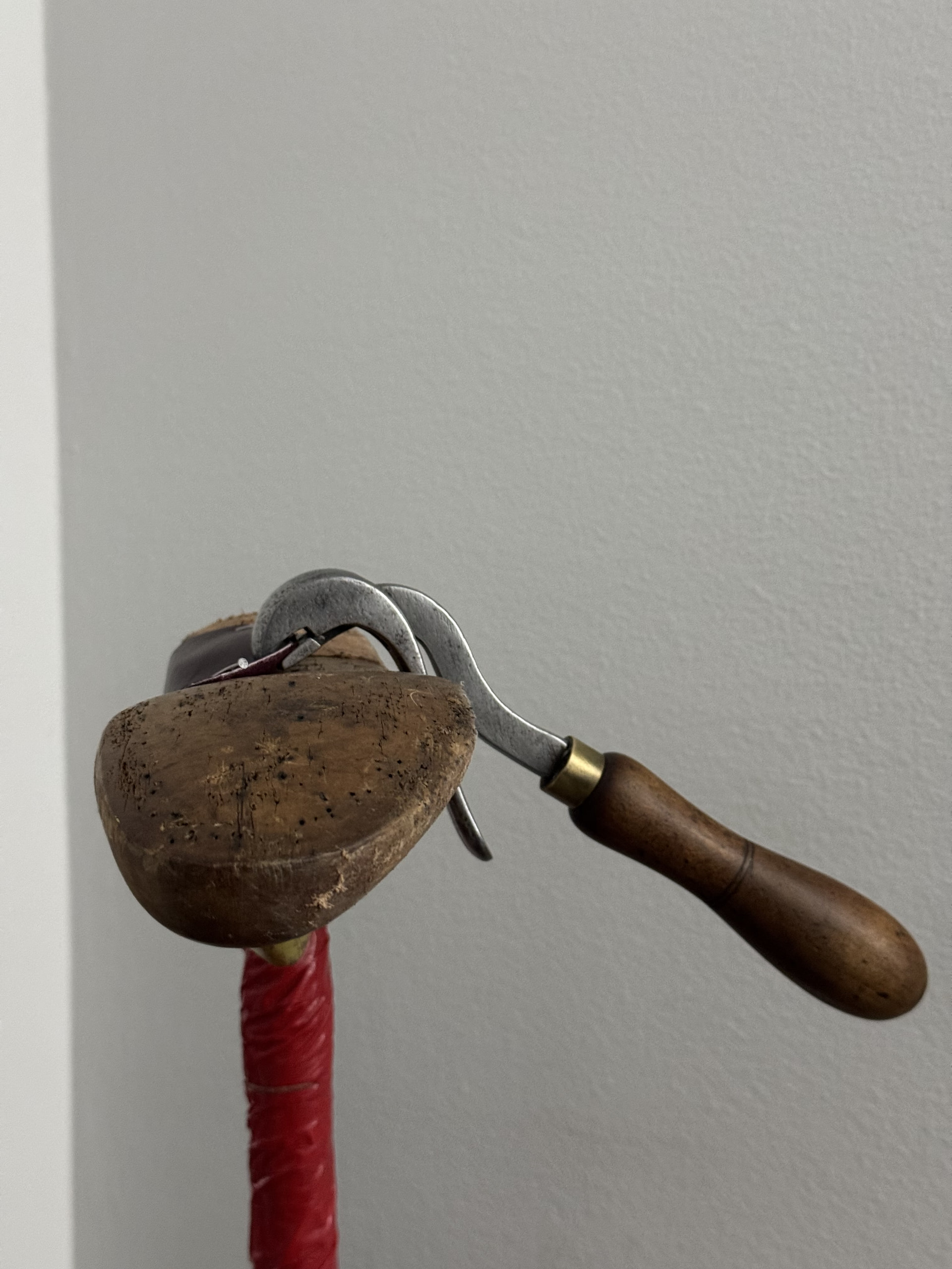

Here are some pictures to show what I meant about the handle angle.
The actual angle of the handle in use will depend on the lasting allowance you have but I think it shows how something like the #1 would suck to use with your leg over the handle. Although with enough lasting allowance you can use it in your lap without a jack.
