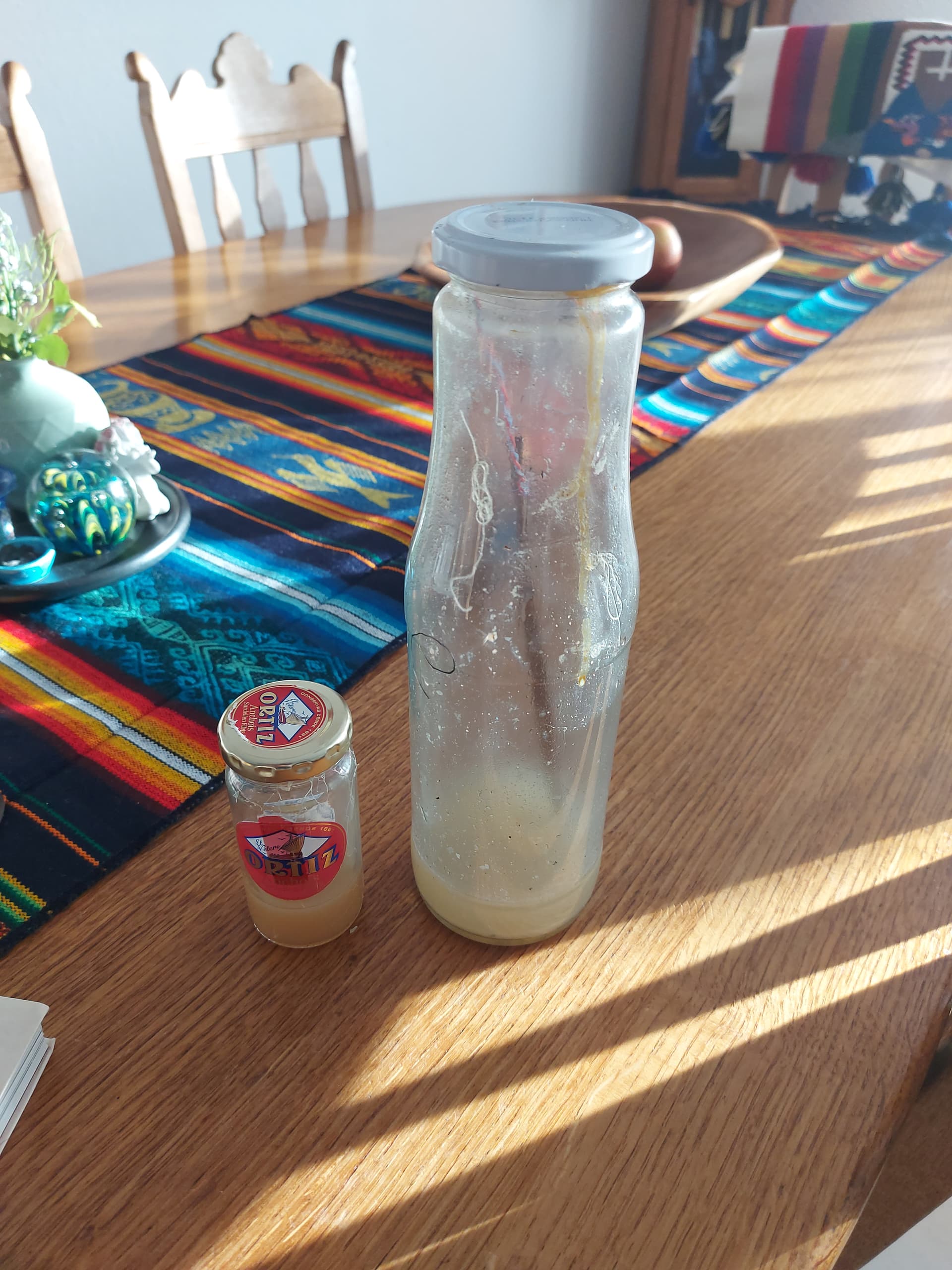

I saw the discussion on cement pots and would like to present the way I am storing my cement. Inspired by painters that store their brushes in a solvent I came up with the following approach that has served me well for many years.
I use one large glass bottle with a large opening to store the brush in the appropriate thinner for the cement. (I use Renia Schnellkleber Verdünner). The large bottle has a large opening so that I can fish out the brush and has a lid that keeps the thinner from evaporating. An additional small glas (previously used to store anchovies) just contans the cement.
The larger bottle is filled about 1 cm with cement solvent, that is sold together with the glue. So when I need to glue something, I take the brush from the large bottle, dry it with a piece of kitchen towel, use it to apply the cement from the small glass jar and throw the brush back into the bottle. Since both containers have lids, I don’t waste any more brushes and in the small glass jar the cement always stays fresh.

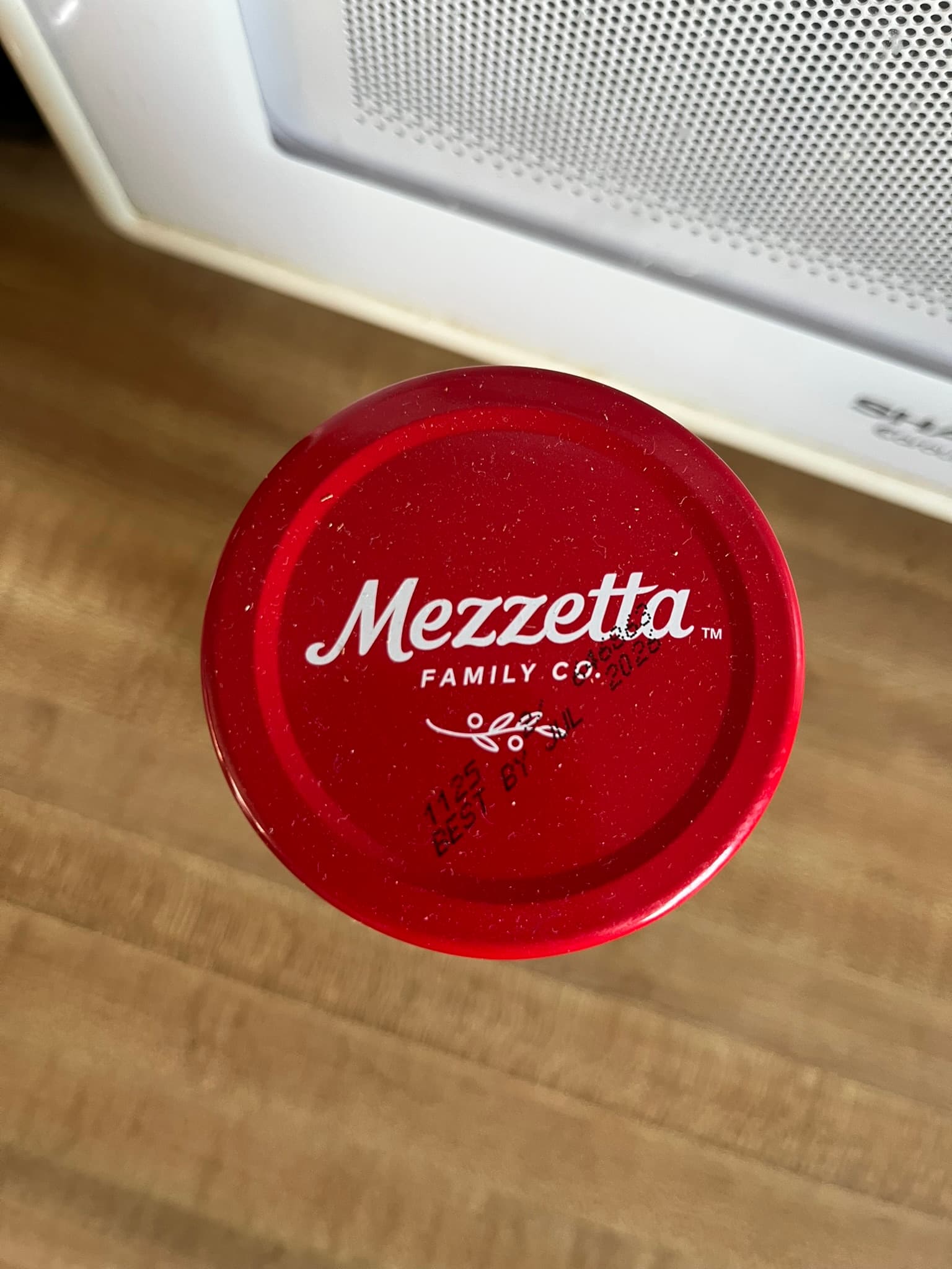

Shorter, but wider opening:

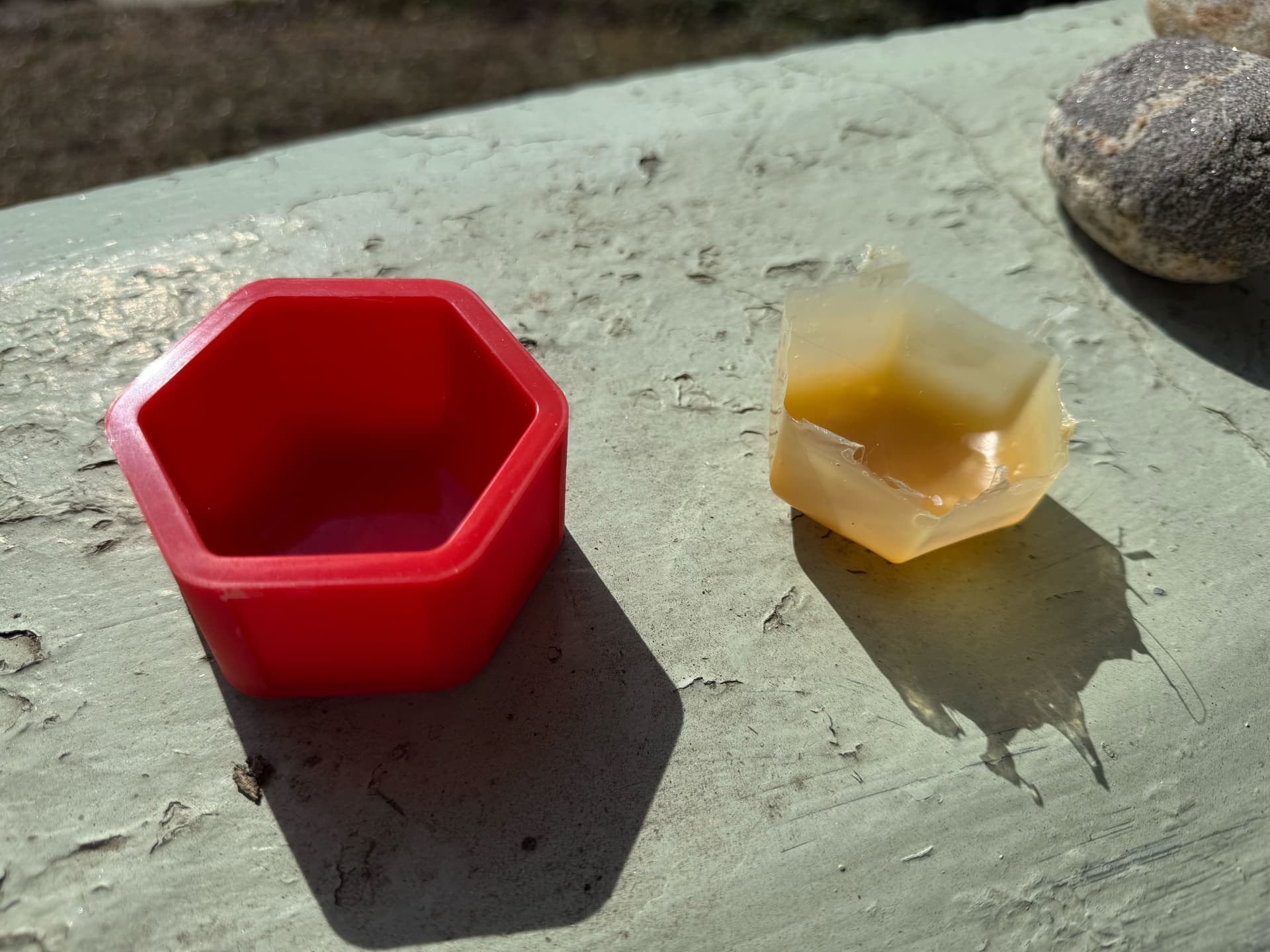

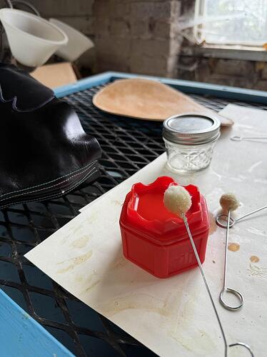

Damn the solvent thing is smart! I just got this little silicone cup with a really handy lid and some brushes. Great to use the little cup lid to hold the brusher, cotton daubers, whatever. Haven’t cleaned it out yet, hoping stuff pops out easily once hardened. Deborah has the big Rennia Col de Cologne at her place, but I just have some of the water-based temporary stuff in a spare glass jar and some Fiebings Leathercraft Cement that I haven’t tried yet. It would be a dream to figure out what construction methods I like that don’t involve relying on solvent-based glues, I hate having to care about ventilation (I say, becuase it’s winter and I also don’t know much about optimal operating temperatures for adhesives).

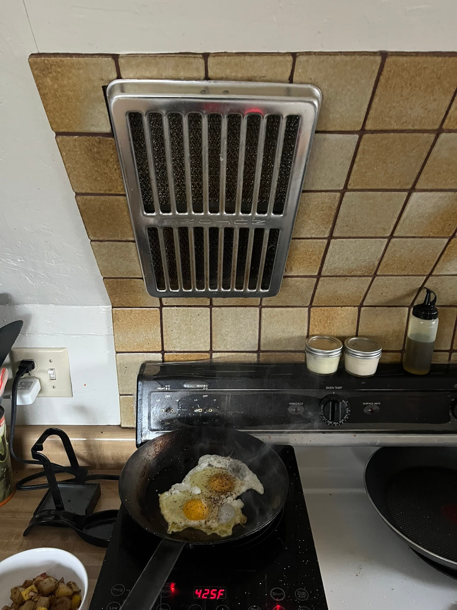

If you have a strong exhaust over the stove which sucks the air from the kitchen and delivers it outside of the house, you could use the cement there - Just make sure your partner is not at home :-)) .
(In order to avoid any mess I get scold for later I cover the stove with baking paper…)
For big cement jobs, like attaching outsoles, I go outside. For smaller jobs, I use my kitchen fume hood, too.
It helps to let it run for a few minutes after the job is done. It’s also important to close any windows. The fume hood will have an exhaust vent somewhere on the outside of the building. You don’t want fumes just coming back in.

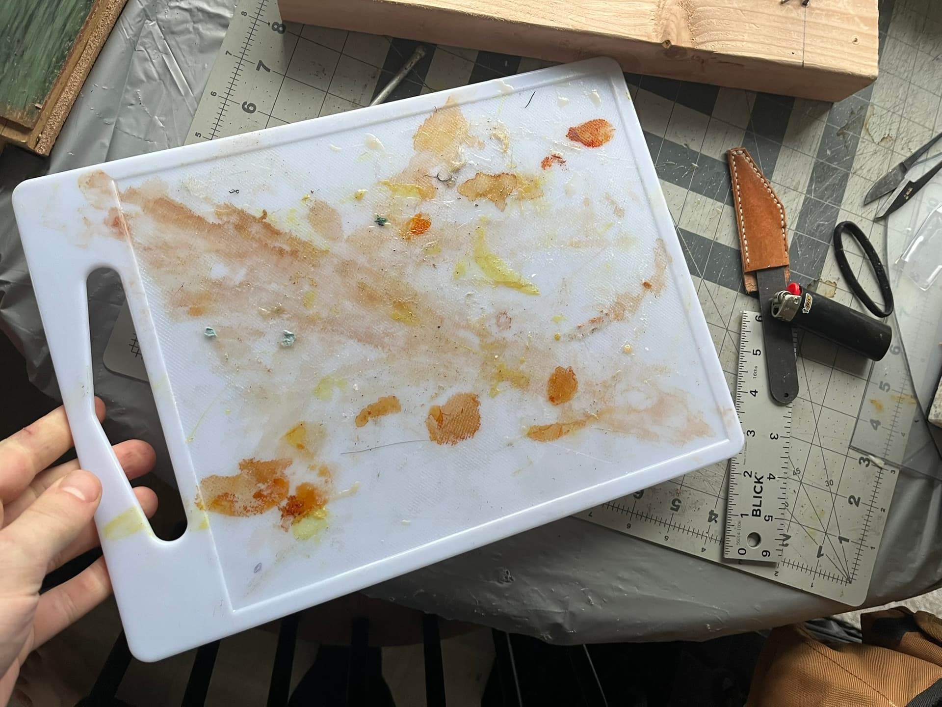

For mess, I’m really glad to have found this very cheap plastic cutting board with a grab handle:
As you can see, I also use it for small dye jobs.
Every once in a while I will take it outside and clean it with acetone or another solvent.

Coming back to this thread months later because I used my same little silicone glue pot with the A315 and it’s kept it usable…indefinitely? Weeks at least, but I think the A315 is just not at all the same as CDC. And the dried A315 peels just as well off the silicone on the brushes and pot itself. So I double down on my endorsement!

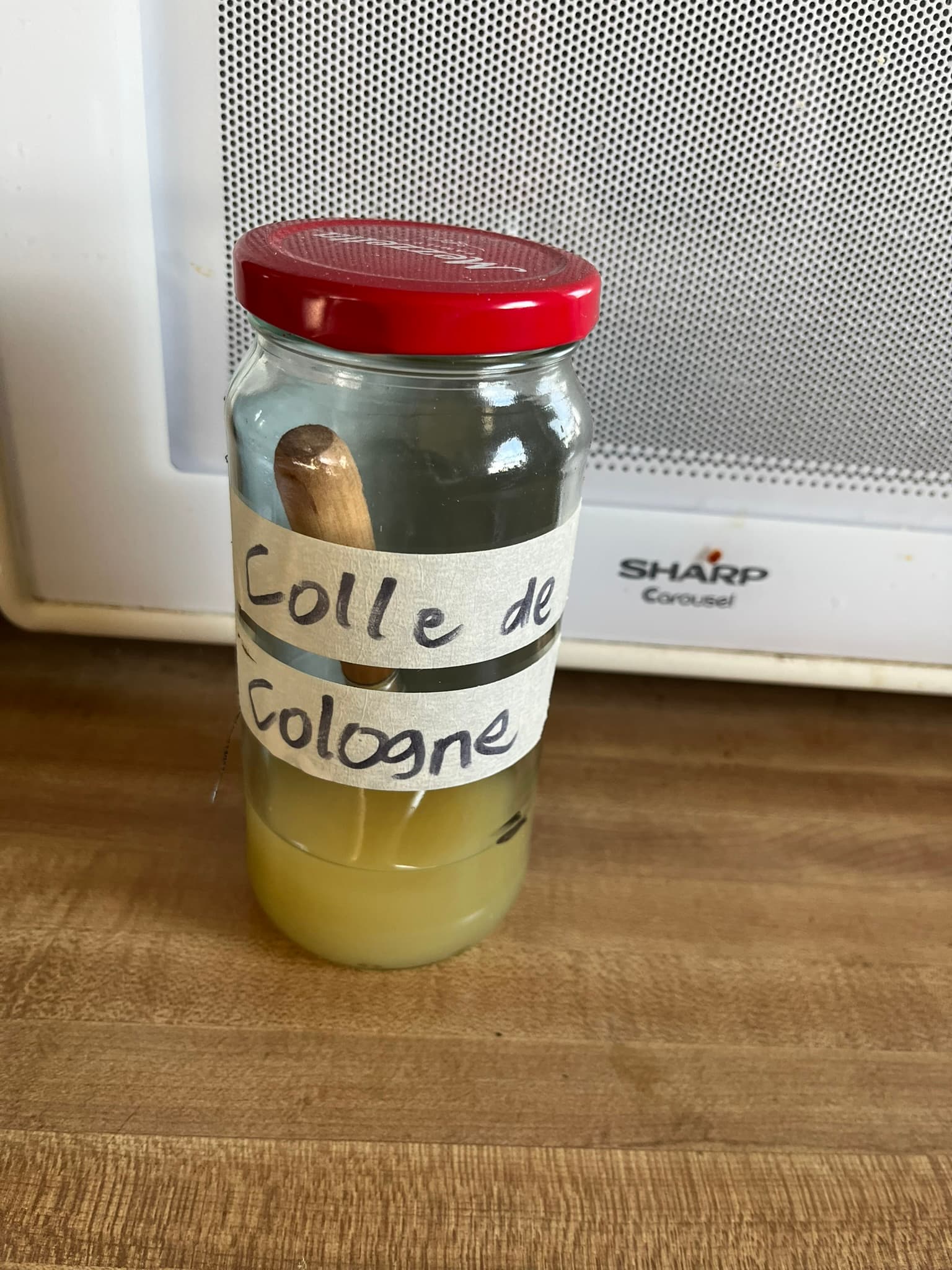

@citizen, you reminded that I’ve running an experiment with Colle de Cologne in a glass jar, encouraged by @Carsten’s reports.
It turns out a jar from stuffed olives fits a Renia brush pretty well.
Was just about to ask how people store their extra brushes. This will never work for me, I hate olives. Like a disgusting grape from hell.
Same jars for pickled peppers!
https://www.mezzetta.com/pages/peppers
