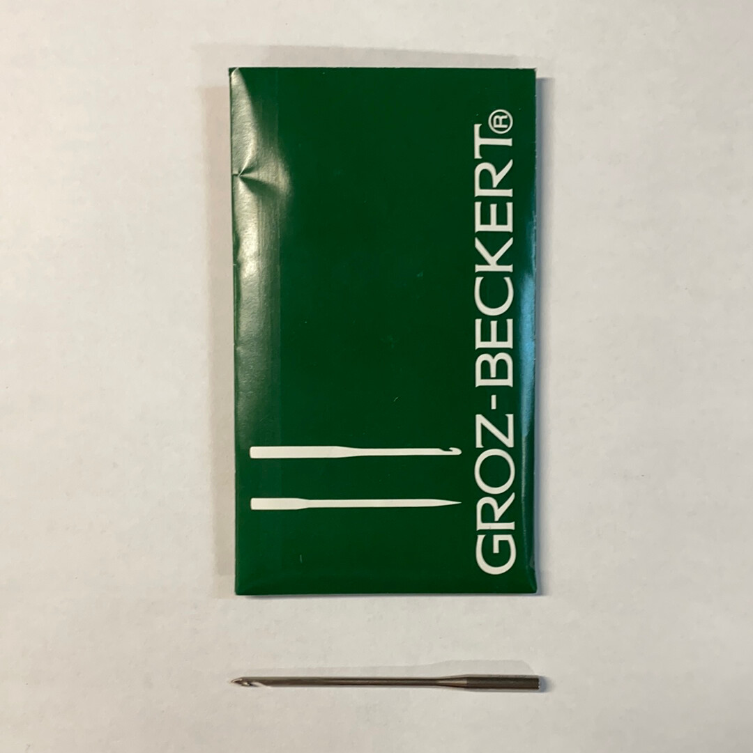

American Straight Needles
I’ve had good success with Groz-Beckert needles for American Straight stitching machines as jerk needles.
A few notes on those:
  • They’re quite tough.
  • The hook is a tad bit smaller than I’d like. I tried all the various widths of Maine Thread twisted thread, and 0.040" was the largest I could reliably catch and pull through without fraying or separation, which makes a huge difference for smoothness and speed. The factory threads certainly seem a bit thicker. It’s also possible to pull thicker thread through if you’re really careful, but for me it was much slower.
  • The shanks are quite smooth and round, so it can be a challenge to hold really tight in an awl haft chuck without slipping. I’ve had the needle slip both forward and back, pushing and pulling.
  • The straight shape mean’s you’ve got to get your awl hand down to the level of the welt, rather than working over top as you might with a curved inseaming awl. When repairing, I want to work on my cobbler’s anvil. But I set my cobbler’s anvil lower than my inseaming stand, since repair is often mostly hammering.
