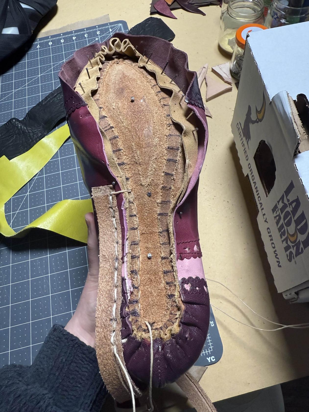

So I wanted to do an oxford instead of a derby, a Cuban heel, and welting all the way around with a stitchdown. Lolsob, as I have mentioned before, I believe this was bad insoling leather for the purpose (others have tried using this material for the same purpose and also failed, is why I say it isn’t just me).

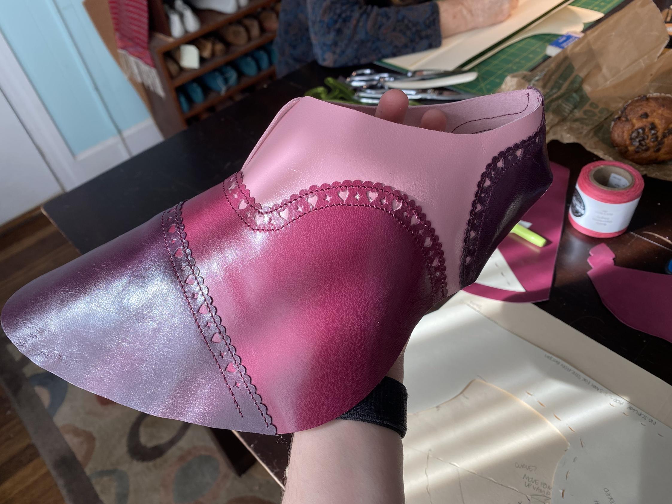

I also fucked up the pattern by trying to scoot something farther up the cone and that should theoretically be a problem leaving some wrinkle or bubble around the bottom of the facings, but I haven’t been able to tell because I haven’t gotten it on that far.

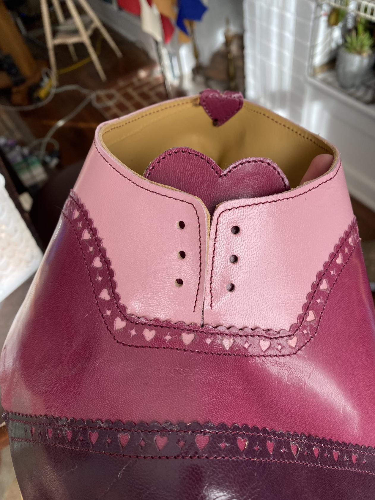

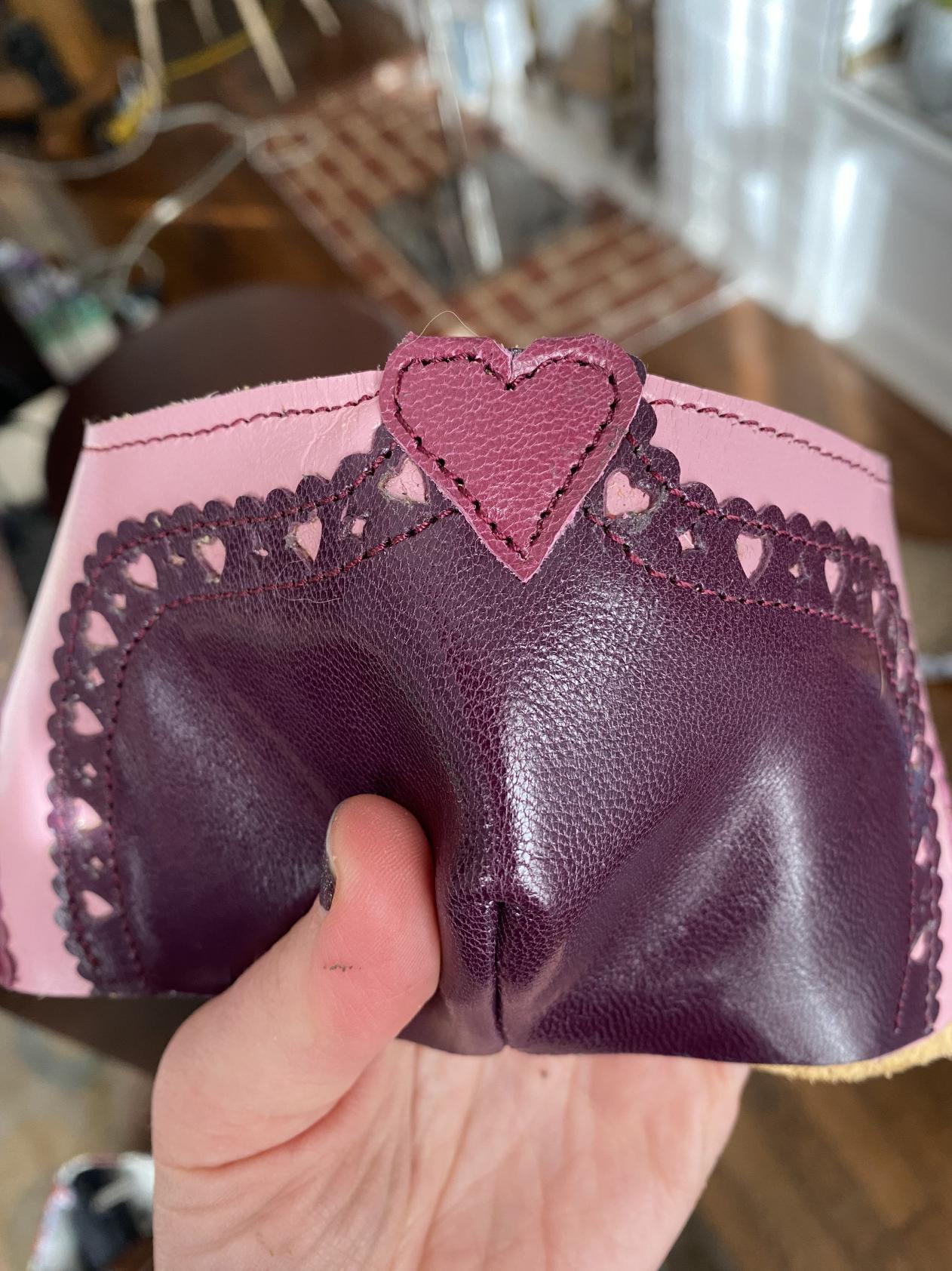

Anyway I guess enjoy the broguing and color choices and stuff. I still want to figure out a way to finish them.
These remind me of those little Valentine’s heart candies that came in paper boxes, looked like pure sugar, and tasted like compressed chalk.
That is truly some powerful broguing. You should really find a last for these.

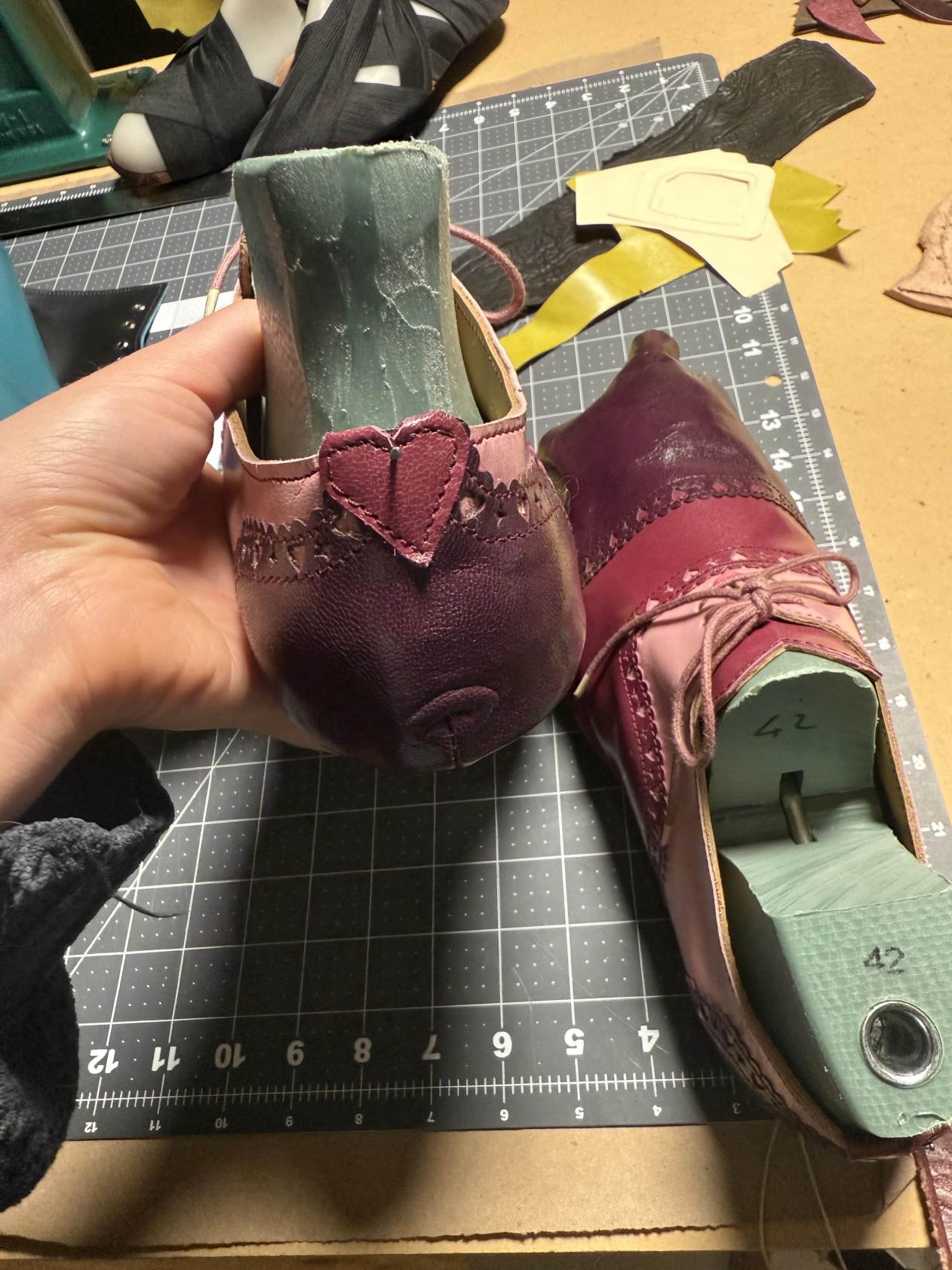

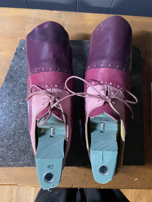

Oh, they are on lasts, that’s how I know I fucked up by moving the vamp point! I actually have ~85% the holes punched in the holdfast from that awl pliers Lisa used to sell (I think she now sells a bench mounted curved punch by the same maker?), but not all the way through the lining, stiffener, and upper. These are the shoes I was saying were from the wrong, very stubborn and hard insoles.
I also thought it would be fun to have welt all the way around including the heel lol what was I even thinking.
