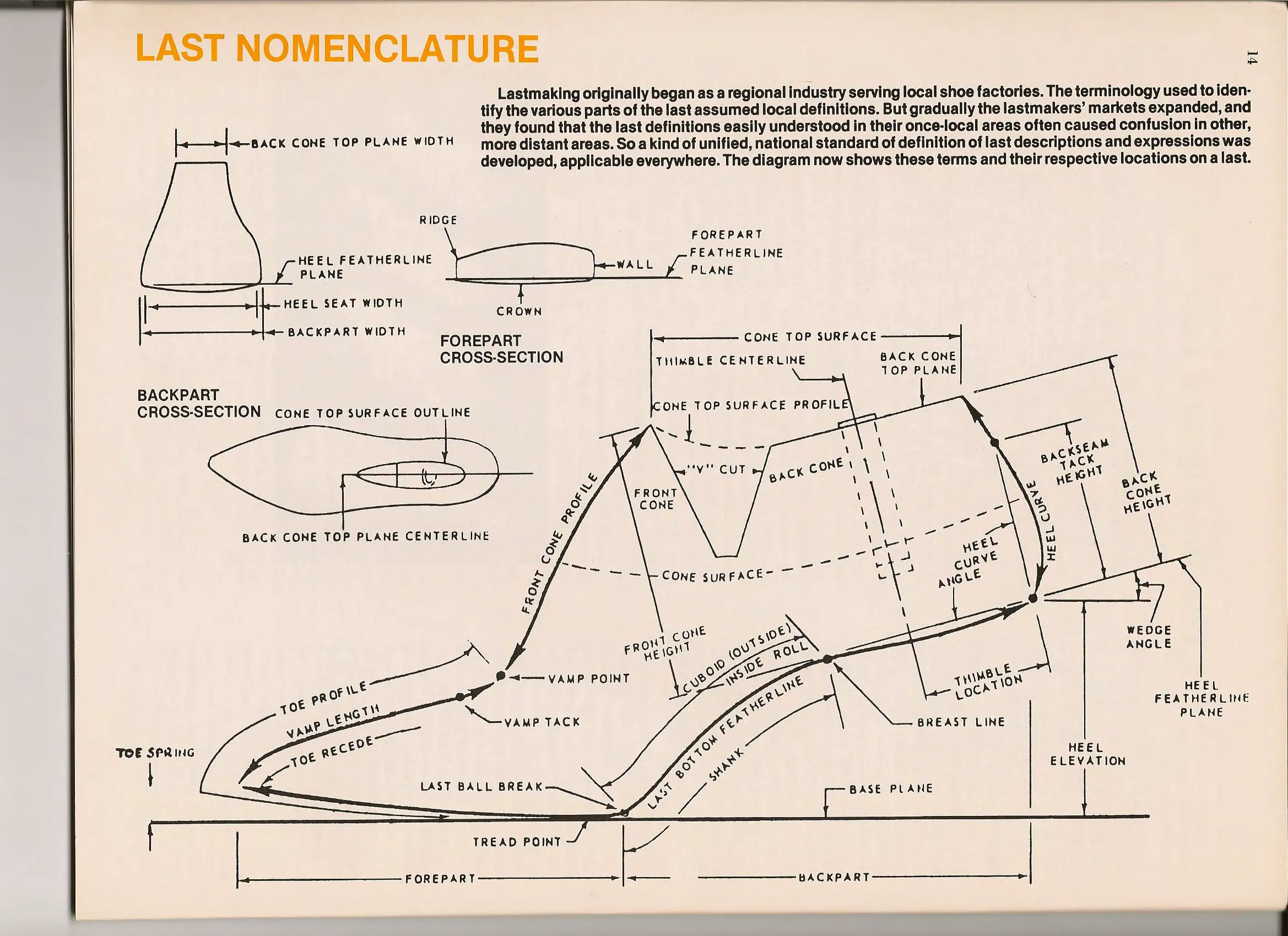

By the by, there is another great last-measurement diagram in that Sterling pamphlet:
I’m slowly typing up my notes from the pamphlet on shoemaking.wiki. It’s still my plan to try and move more wiki stuff over to this forum, to encourage others to edit, discuss, and share their own pages.
