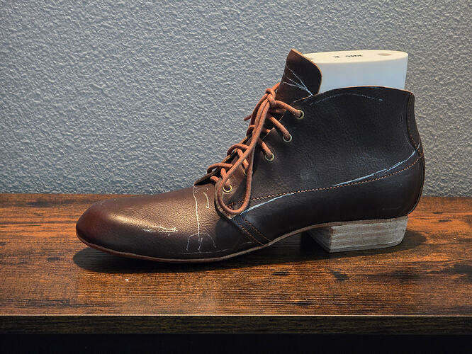

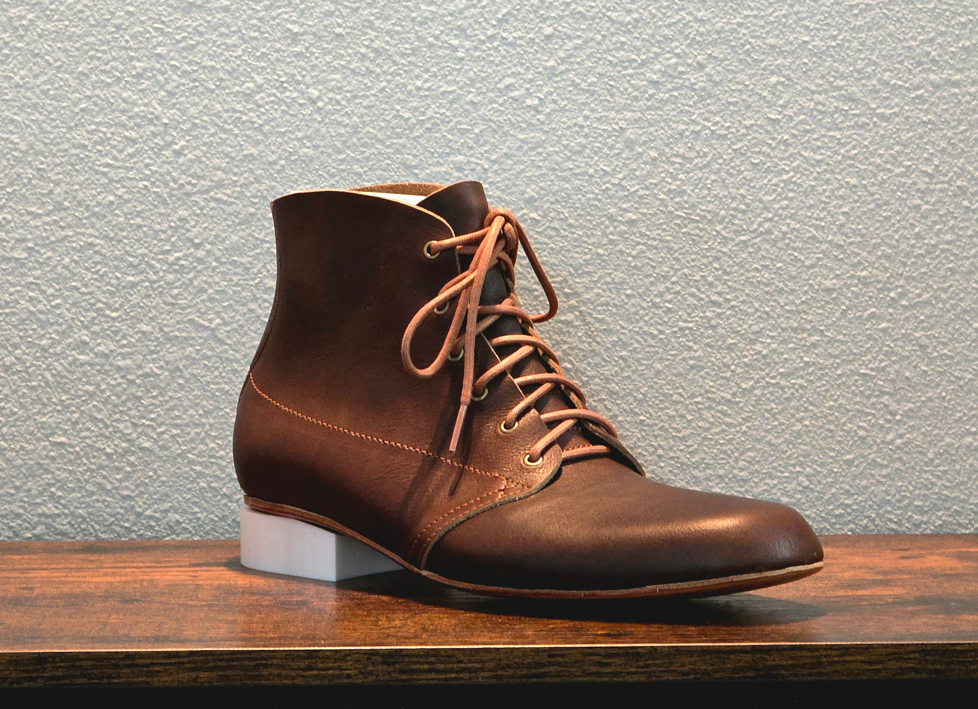

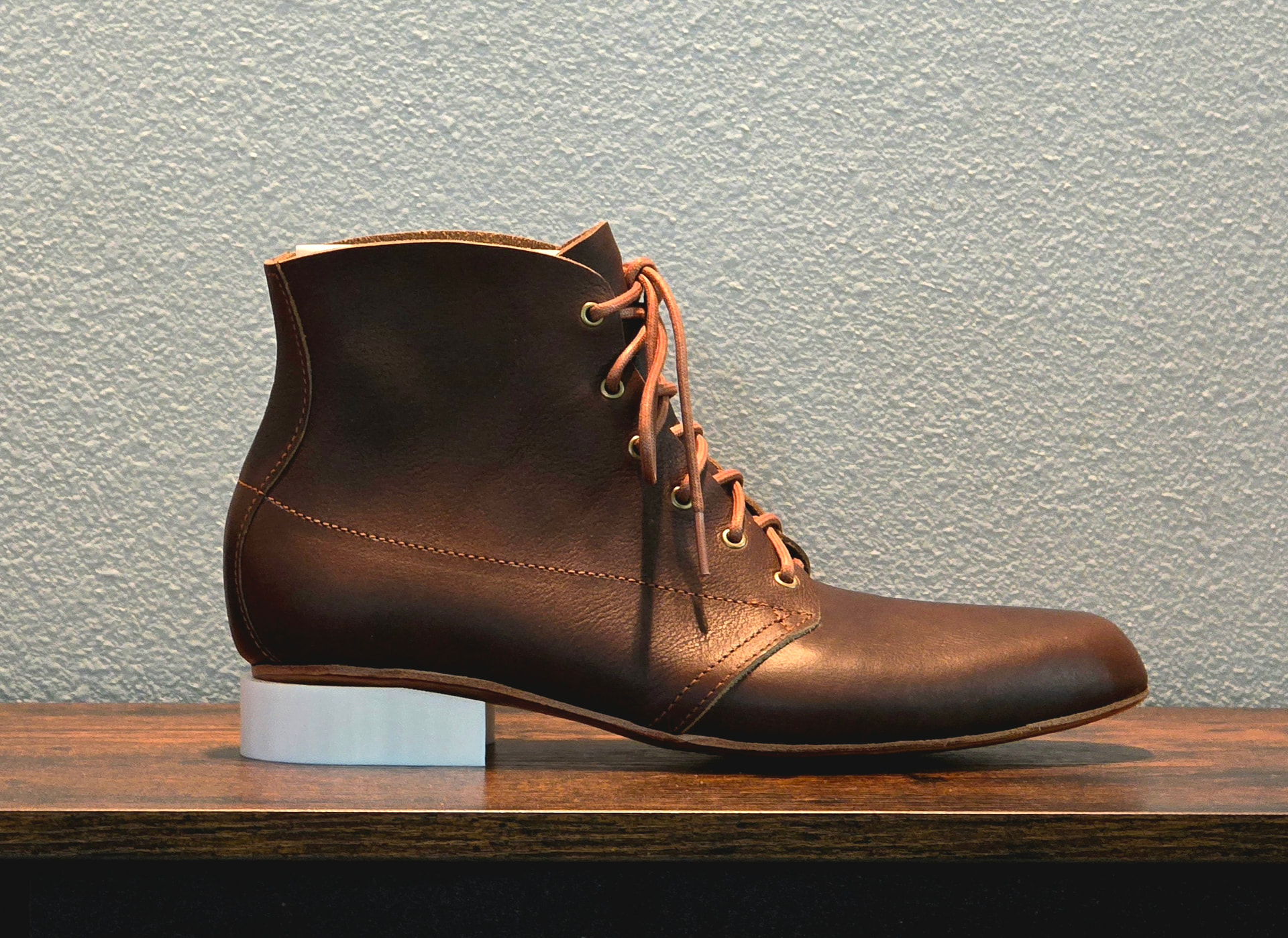

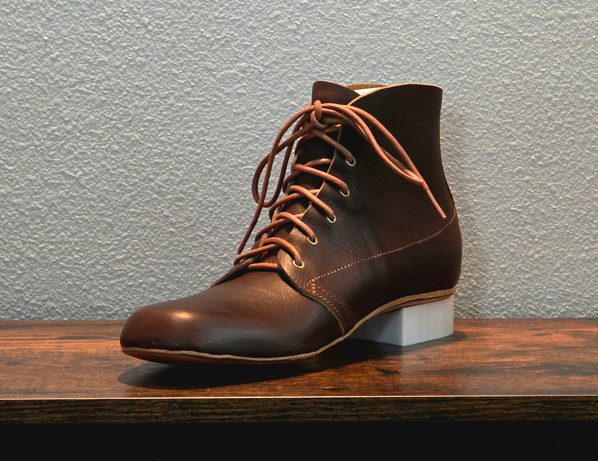

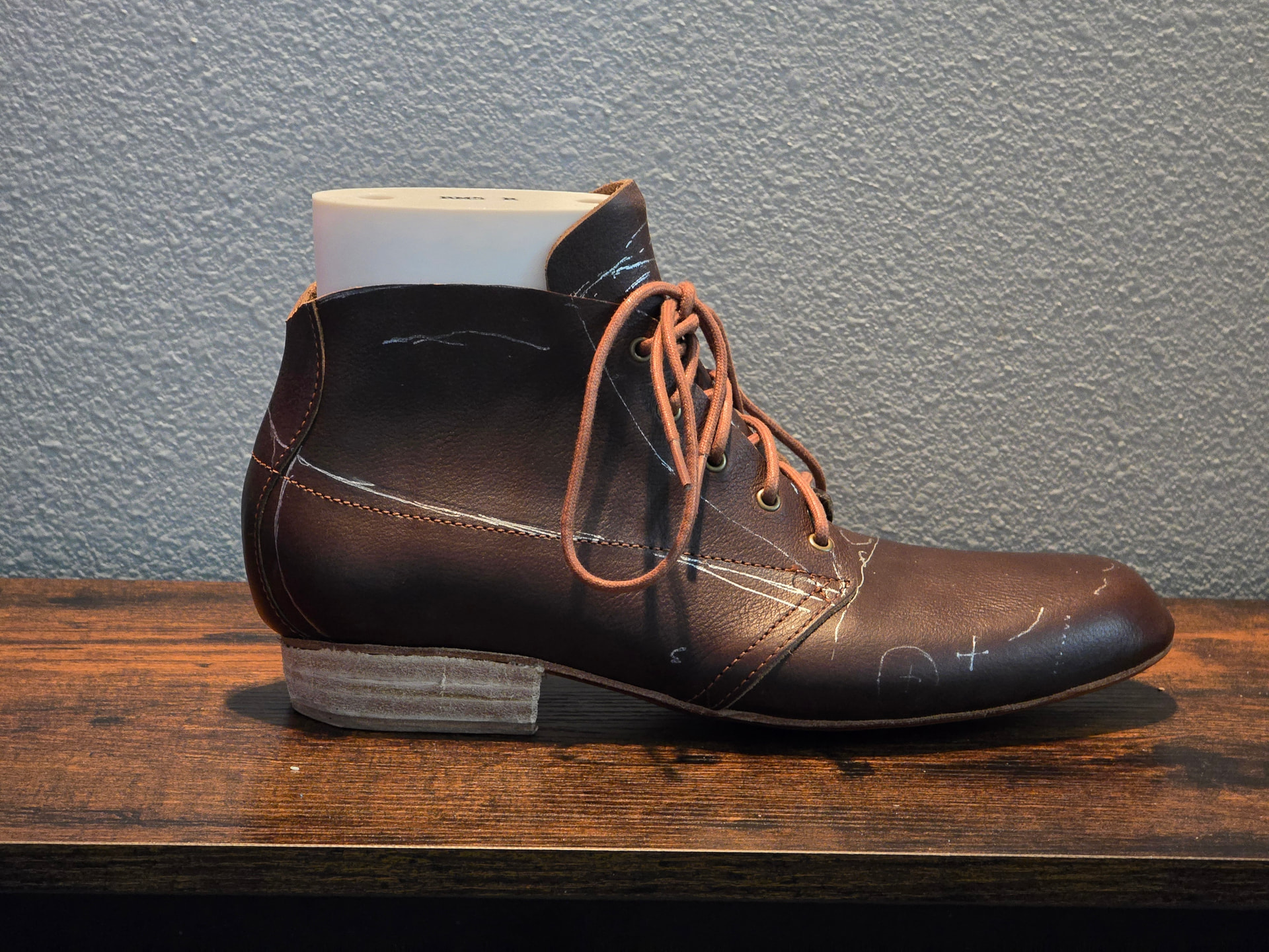

Working on a boot for someone with super flat feet. To get the extra support he needs, I am planning on running a much longer counter than normal, so giving a pattern a try with the vamp line pulled forward and a long internal counter pocket. Will probably either do a Thomas heel or a stacked leather wedge for more support.

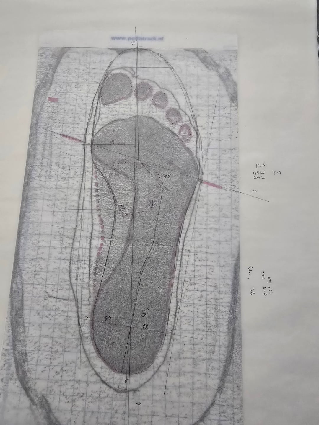

Some other last changes here… he puts a ton of pressure on the 1st and 5th ball joints with the middle three really lightly loaded, so there’s a small metapad built it to support the transverse arch and a light lift of the big toe based on aome orthotics he currently is using.
This is just a pattern fitter, so missing a lot of the final stitching, lining, etc.
Using Horween washed chromexcel… what a wonderful leather. This stuff is so easy to work with.

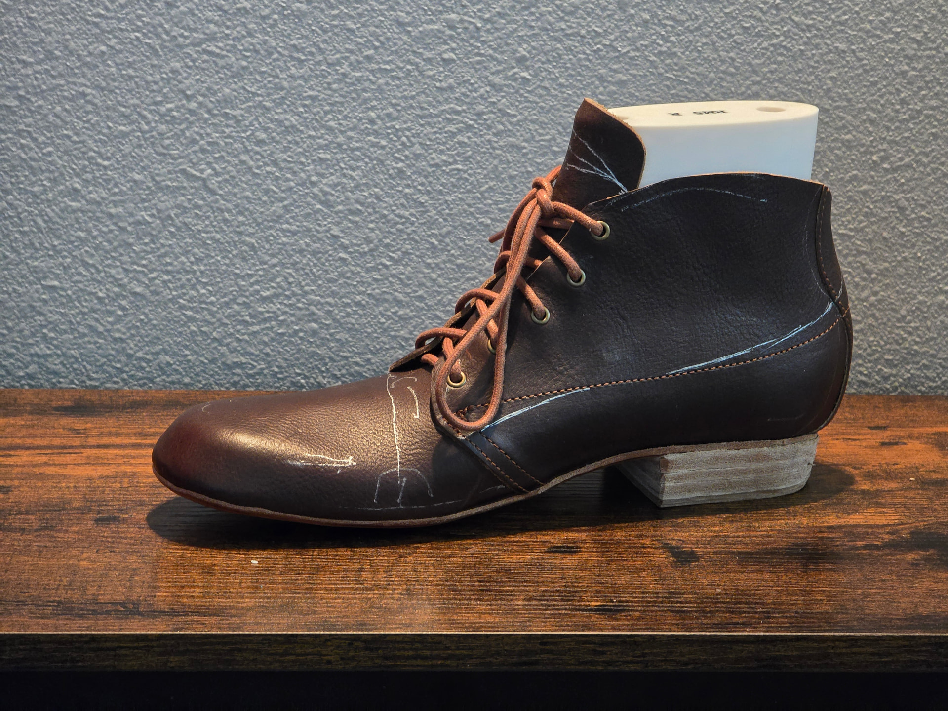

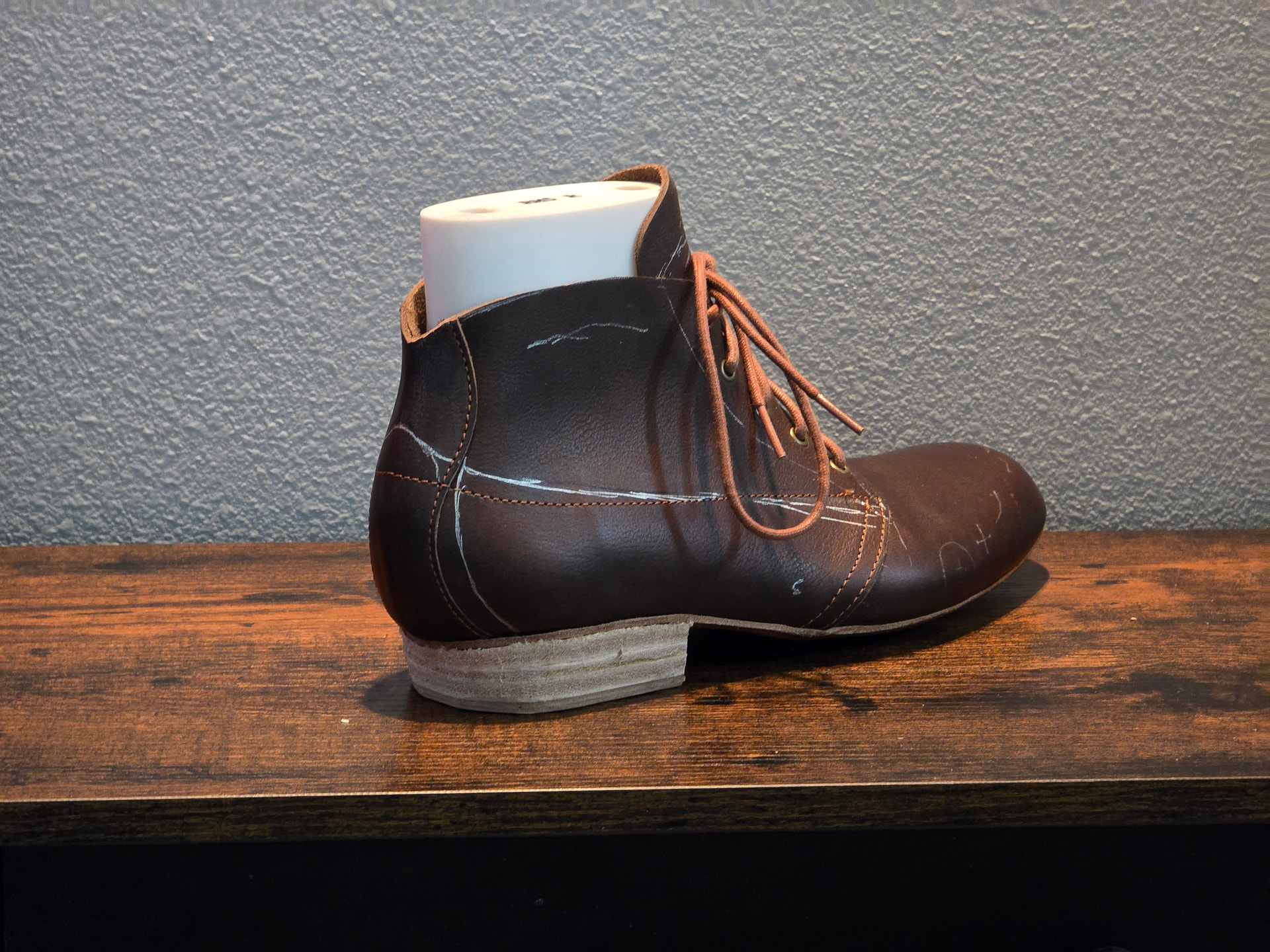

Fitting went well. Last needs some minor tweaking. Pulled the heel in about 2mm, medial ball brought in about 2mm, lateral ball increased about 2mm and a slight increase in waist girth.
Made some pattern changes too. Decision was made to lower the topline about 3/4 of an inch (basically lower to remove the top eyelet) and open the facings a little. More or less trying to get the counter pocket line to flow with overall shape a little better. Adding a little dip on the back topline for the achilles.

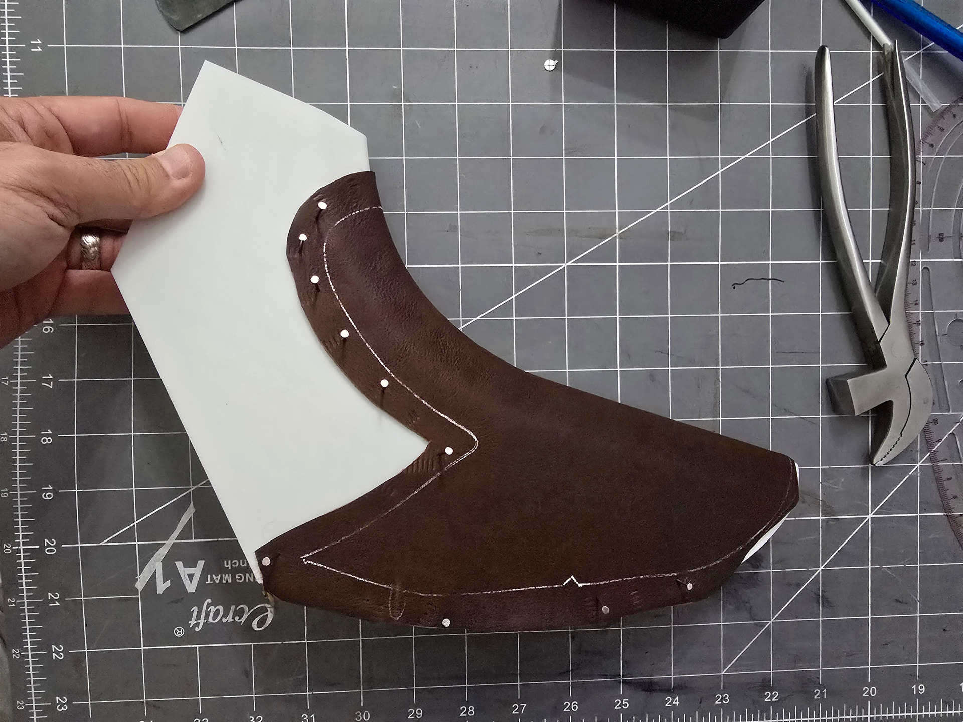

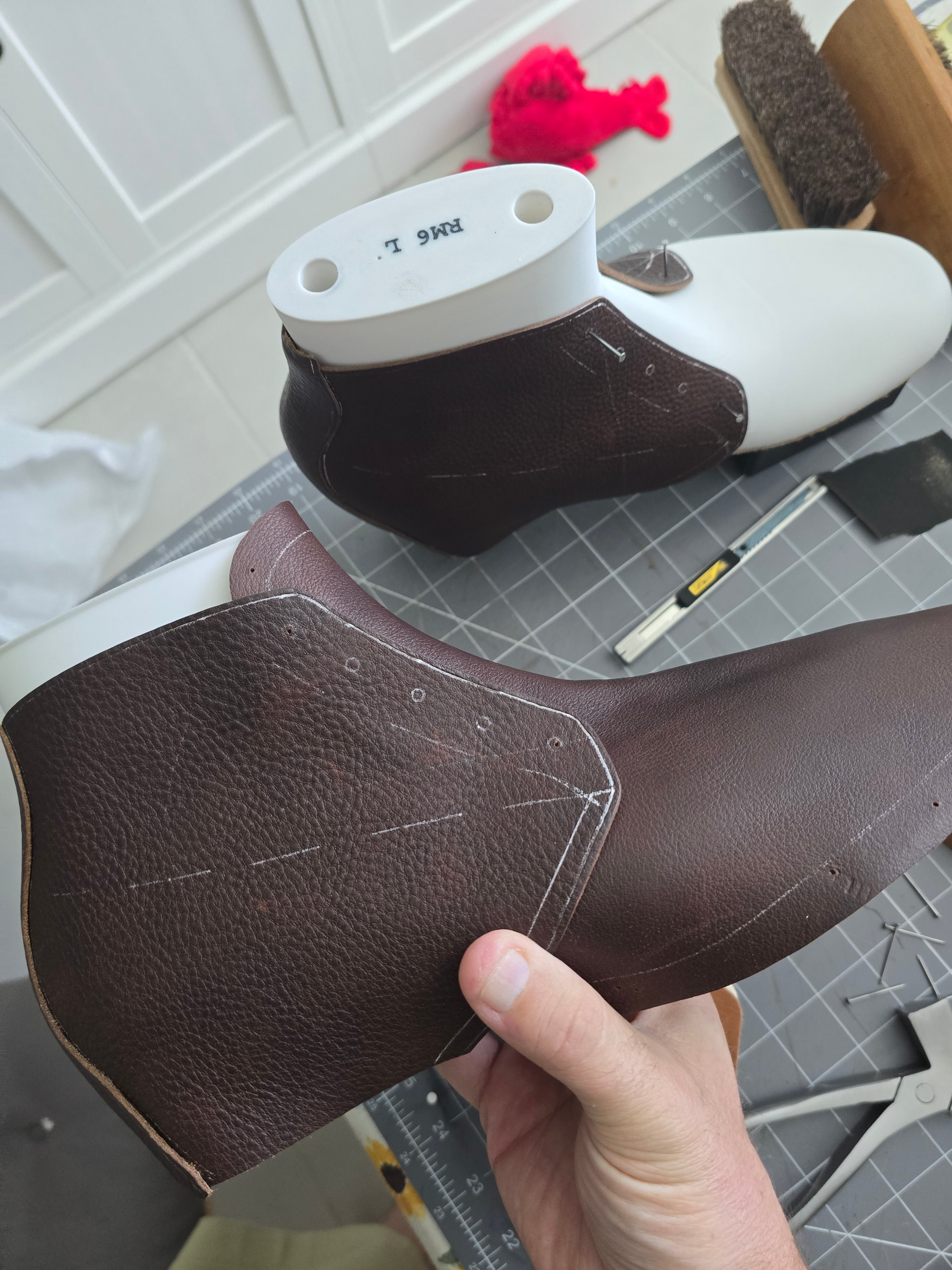

Went through all the pattern updates yesterday and I decided to give a single piece vamp/tongue a go on these. Height is low enough that it doesn’t become a horrible waste of leather.

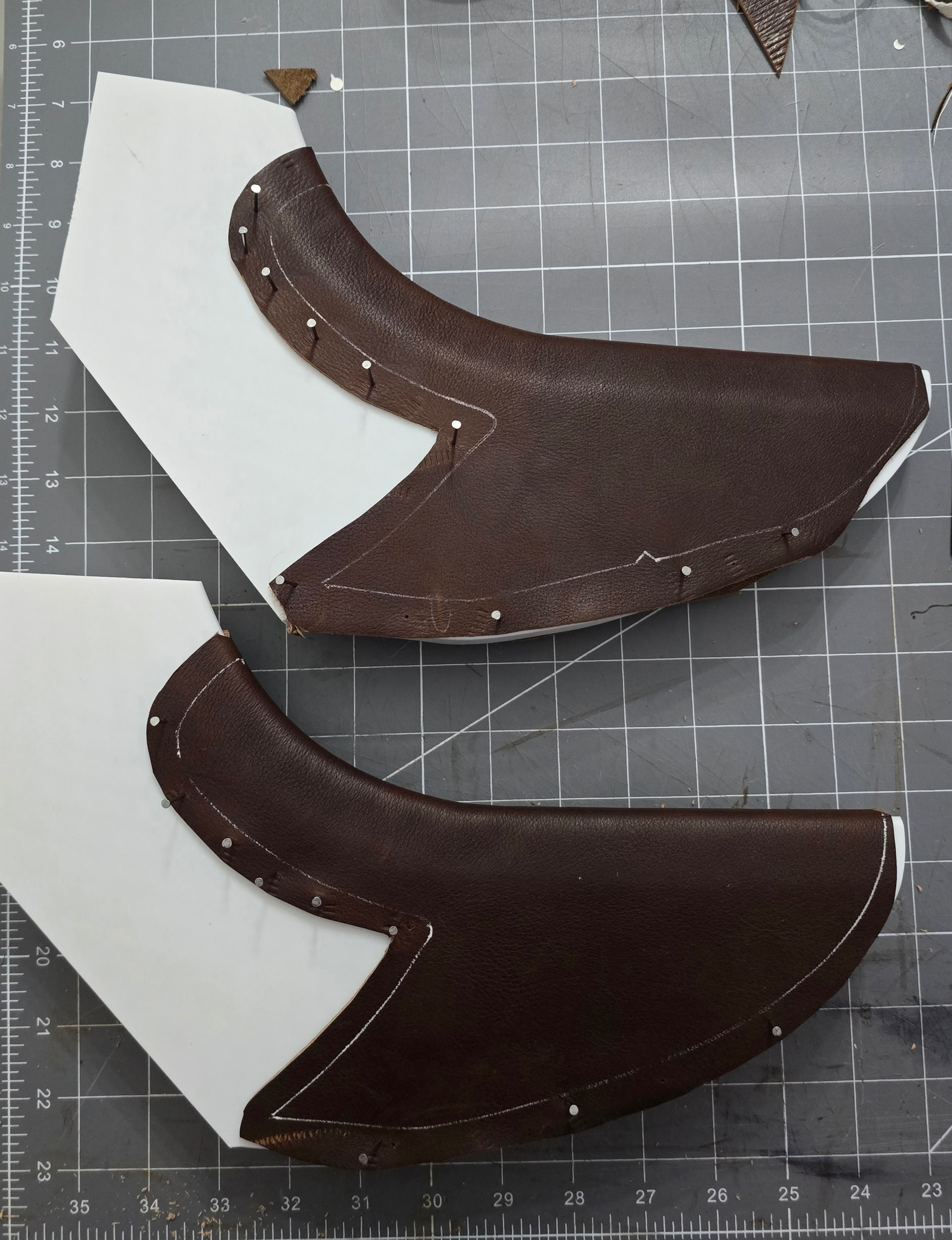

Going to give crimping the tongue a try on these as practice before crimping the vamps on the engineer project I am doing. Additionally, the tall boot project I am working on really wants a crimped guessed tongue, so this is a good starting point.

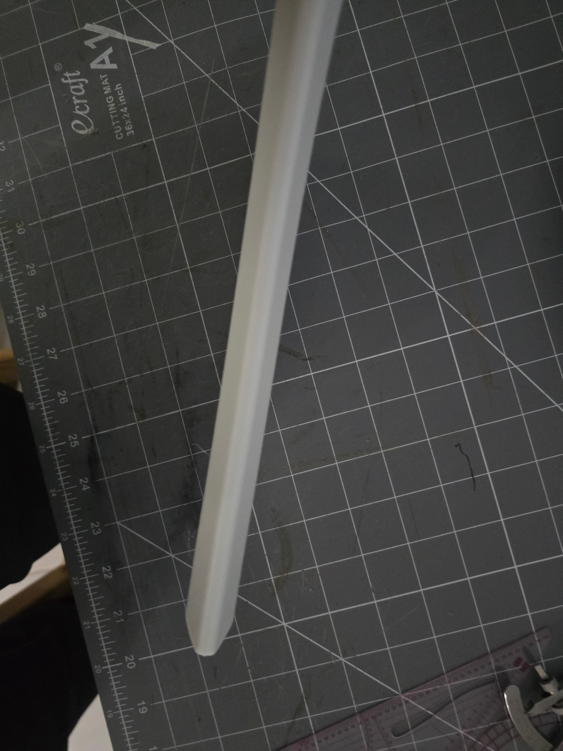

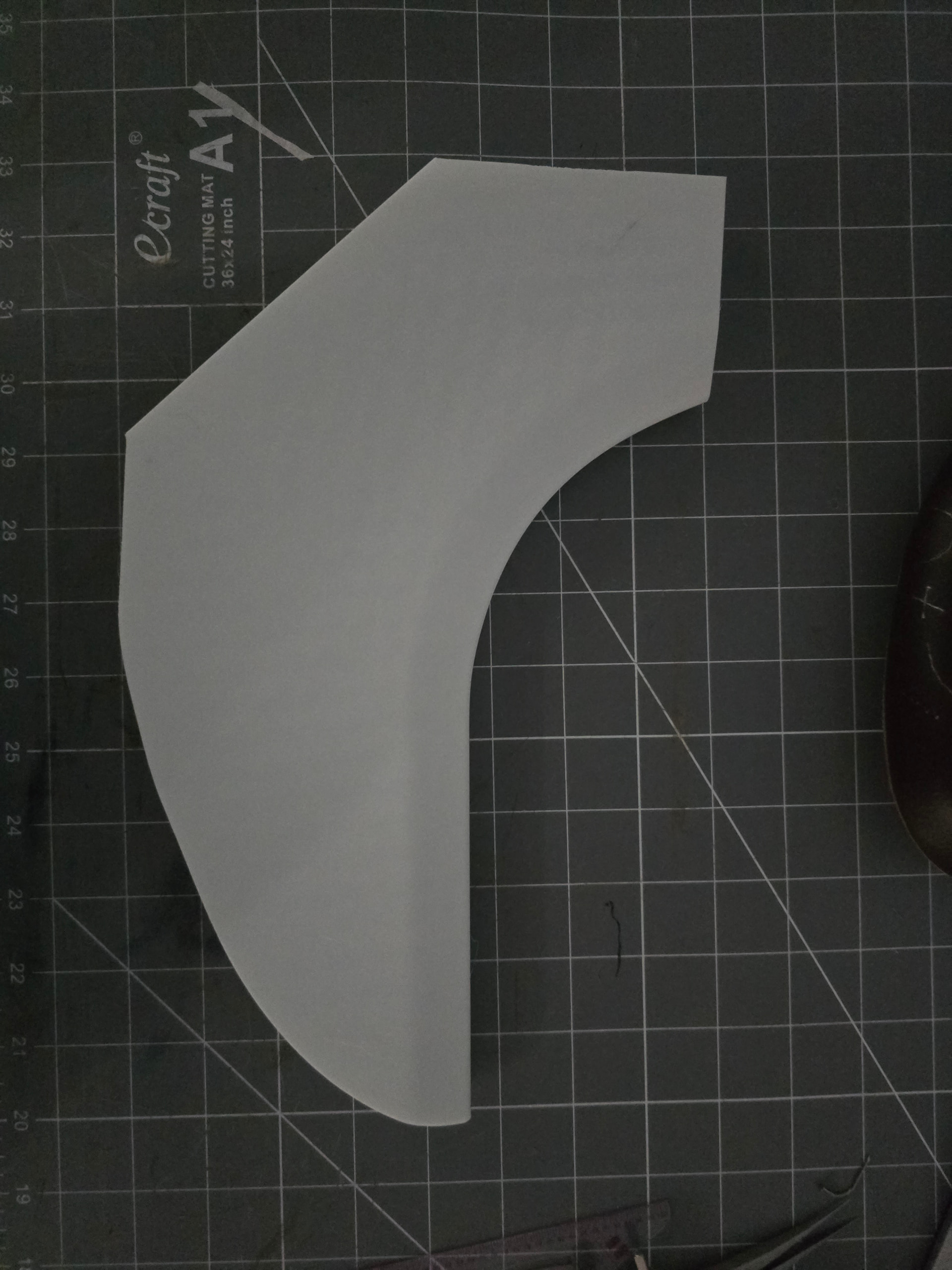

So I took my mean forme and made a small crimping block on the printer:
Interesting idea, 3D printing a crimp block.
I hadn’t thought of that, I suppose since most of the examples I’ve been looking at have been rather large, close to 12 by 12 inches.
This definitely taxed the usable print volume of my printer, so anything taller would need a multi-piece part, but for all of $2 worth of material and 5 minutes of modeling time, it will definitely get the job done.
That seems to work reasonably well. Chamfer section needs to be longer, but thats easy to change
Printed up a matching board for the other vamp. Will let them sit for a few days, then crimp the lining and the upper together.

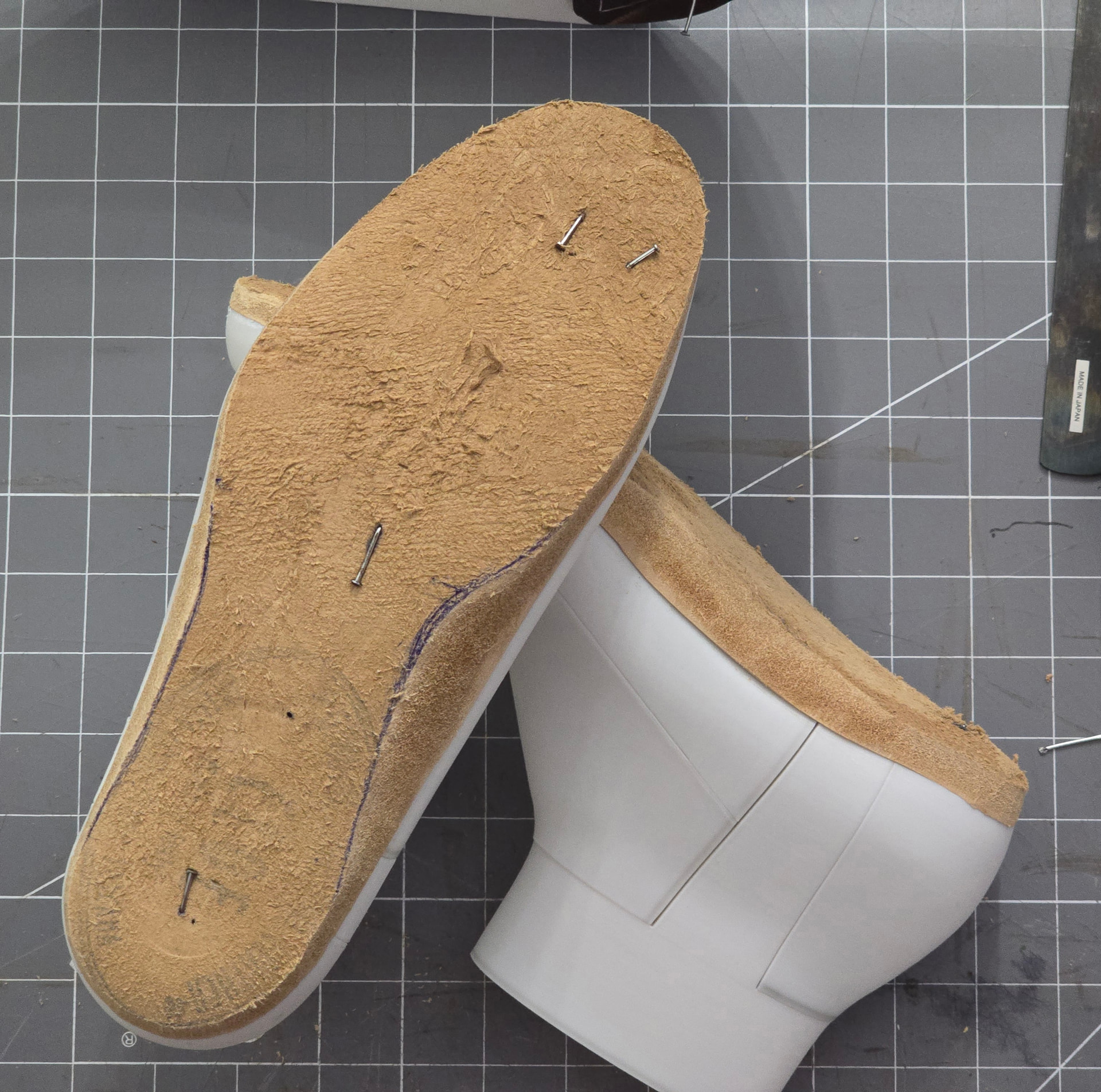

Also started carving the insoles
Note to self: extra thick insoles require extra lasting allowance in the heel.
