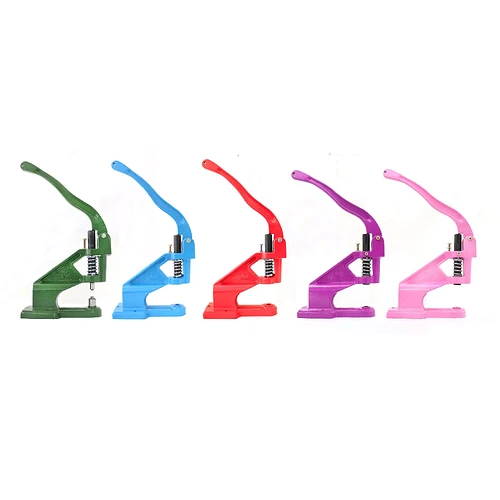

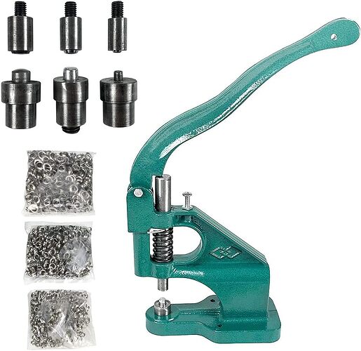

I decided I’d get myself a proper hardware setting press for my birthday. I ended up with this one from Campbell-Randall:
I also thought about the “piston pliers”, branded TEKNO, that also come from Italy. I believe @customboots offers those as “setting pliers” here:
The general idea is that all these presses take interchangeable tooling sets for the various kinds and sizes of hardware: eyelets, lace hooks, rivets, snaps, and so on. I got myself a lace hook set from Campbell-Randall, and had already bought an eyelet tool set from Ohio Travel Bag.

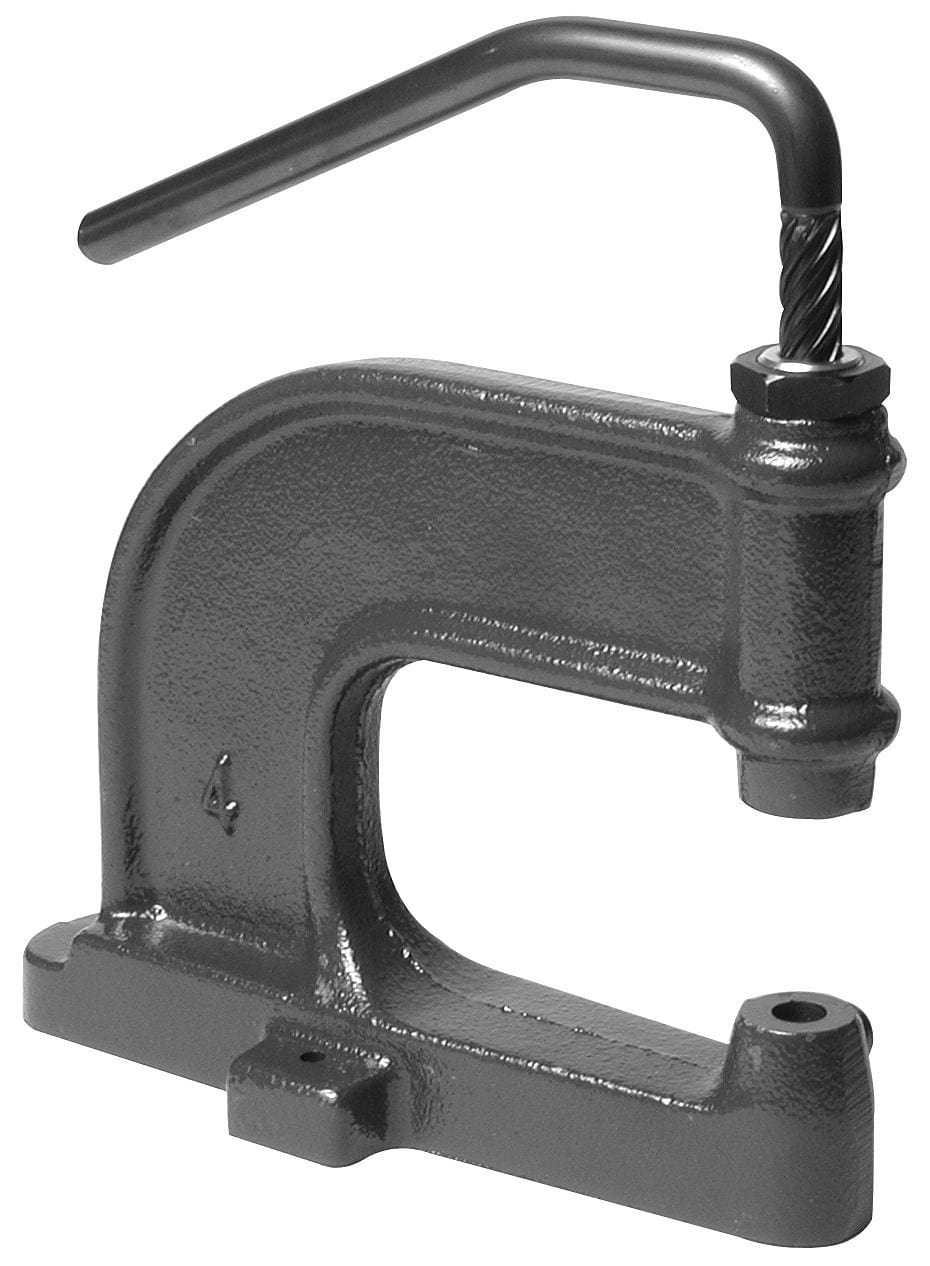

My twist press, one of several models numbered from 2 up through 6, has:
  • a round role roughly 1/2 inch, or a little over 12mm, in diameter, with a set screw, for anvils
  • an arbor—the part that goes up and down—with female threads that I suspect are 1/4"-24, for setters

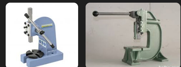

To add still another twist, one of the tools Ohio Travel Bag offers as compatible with their dies looks an awful lot like another Italy-made twist press:
It’s painted grey, not green. But it’s clearly from the same product series.

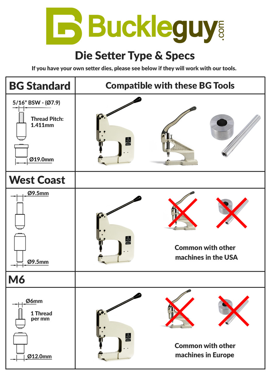

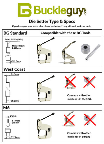

When I remembered to check what Buckleguy, another hardware distributor, does for setting dies, I found they offer both tooling sets and machines. However, nearly all their tooling sets include this as one of the product images, along with a stern warning to review it:
Sheesh. Three more standards, including one apparently all their own.
What particularly got me was that the “M6” standard “common with other machines in Europe” doesn’t include my Italy-made hand press. I’d strongly prefer if the arbor of my press were M6-1.0, but it’s not.

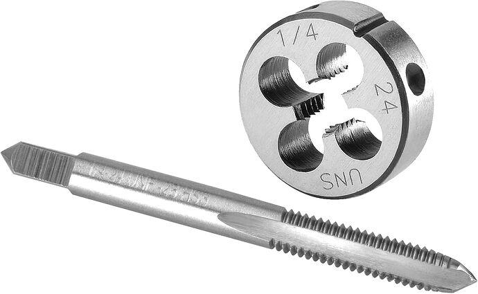

There are cheap taps and dies for 1/4-24 still available:
https://www.amazon.com/gp/product/B09ZTTWWKV/
I also strongly suspect a die could cut other 1/4" and M6 diameter threads to fit the press I have.

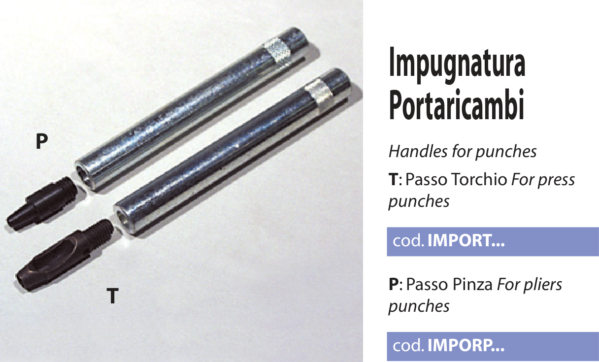

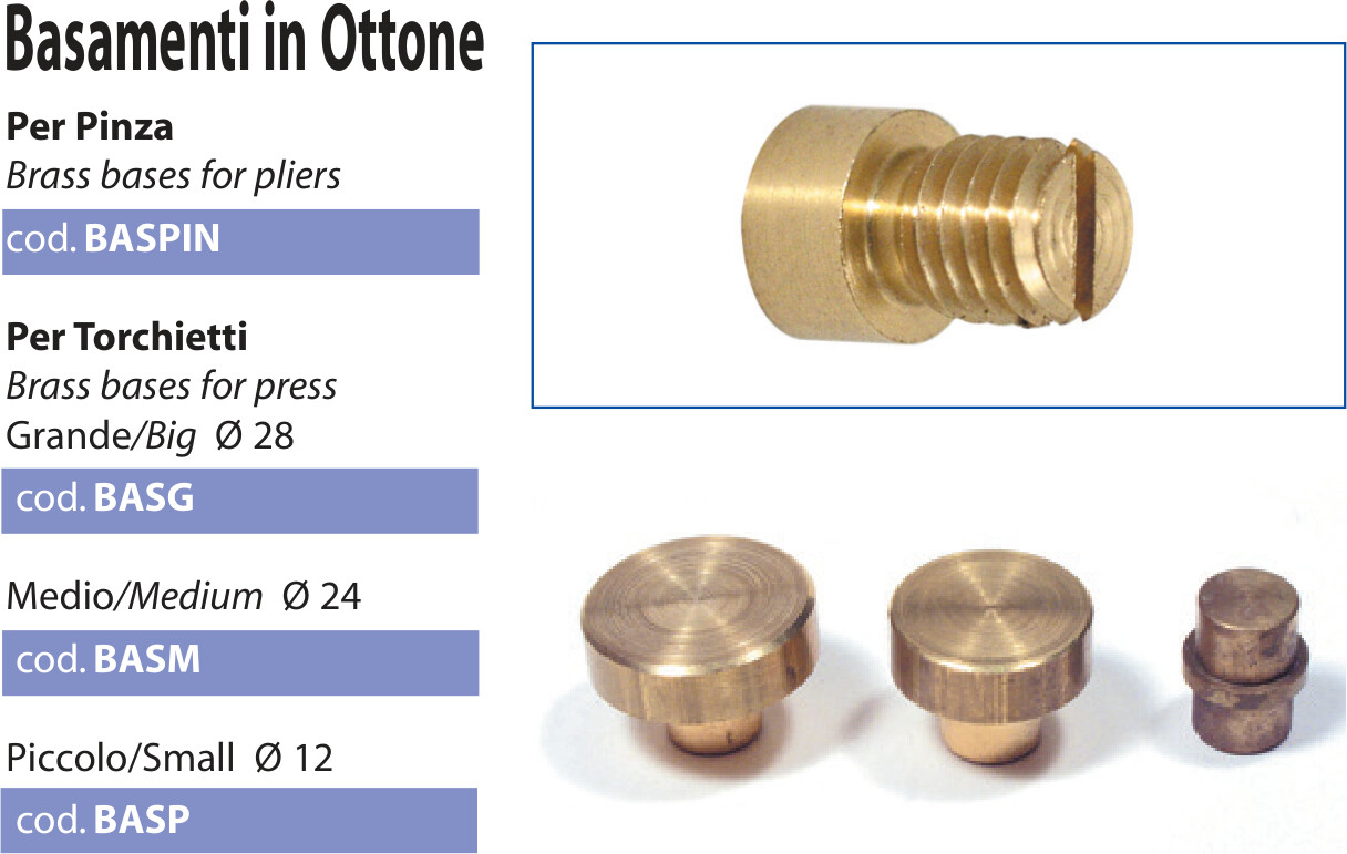

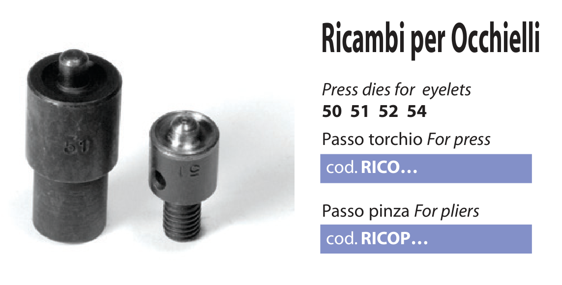

Another potential wrinkle here: I notice that Fratelli Barbieri’s catalog lists different punch handles “for press punches” and “for pliers punches”:
They also list different tooling sets “for press” and “for pliers”:
And brass anvils:
The only pliers that I see listed by any of the Italian finders are branded TEKNO. Best I can tell, they come from Germany.

Cheap 1/4-24 Tap and Die Didn’t Fit
I found a supposed 1/4-24 UNS tap and die set for astoundingly cheap online. It arrived today. Neither tap nor die cleanly fit my No. 2 press or the boot lace hook tool that screws into it.
Go figure. The usual story with non-standard threadings.

I like my little Number 2 press. It feels l like a quality tool, especially since I got it mounted on a board I can cantilever off my bench top.

I do foresee myself ending up with more Italian tooling sets, just because so many finders recommend them to match their hardware. But if I were doing it all again, I’d probably buy a press with simple 3/8" / 9.5mm sleeves and set screws, top and bottom.
Buckleguy refers to this as “West Coast”, and offers many of its tooling sets cut that way. The nice folks at Weaver Leather confirm their Little Wonder press is 3/8" top and bottom. I’m not sure about the presses Tandy sell, but I suspect the same. I’ve asked.
