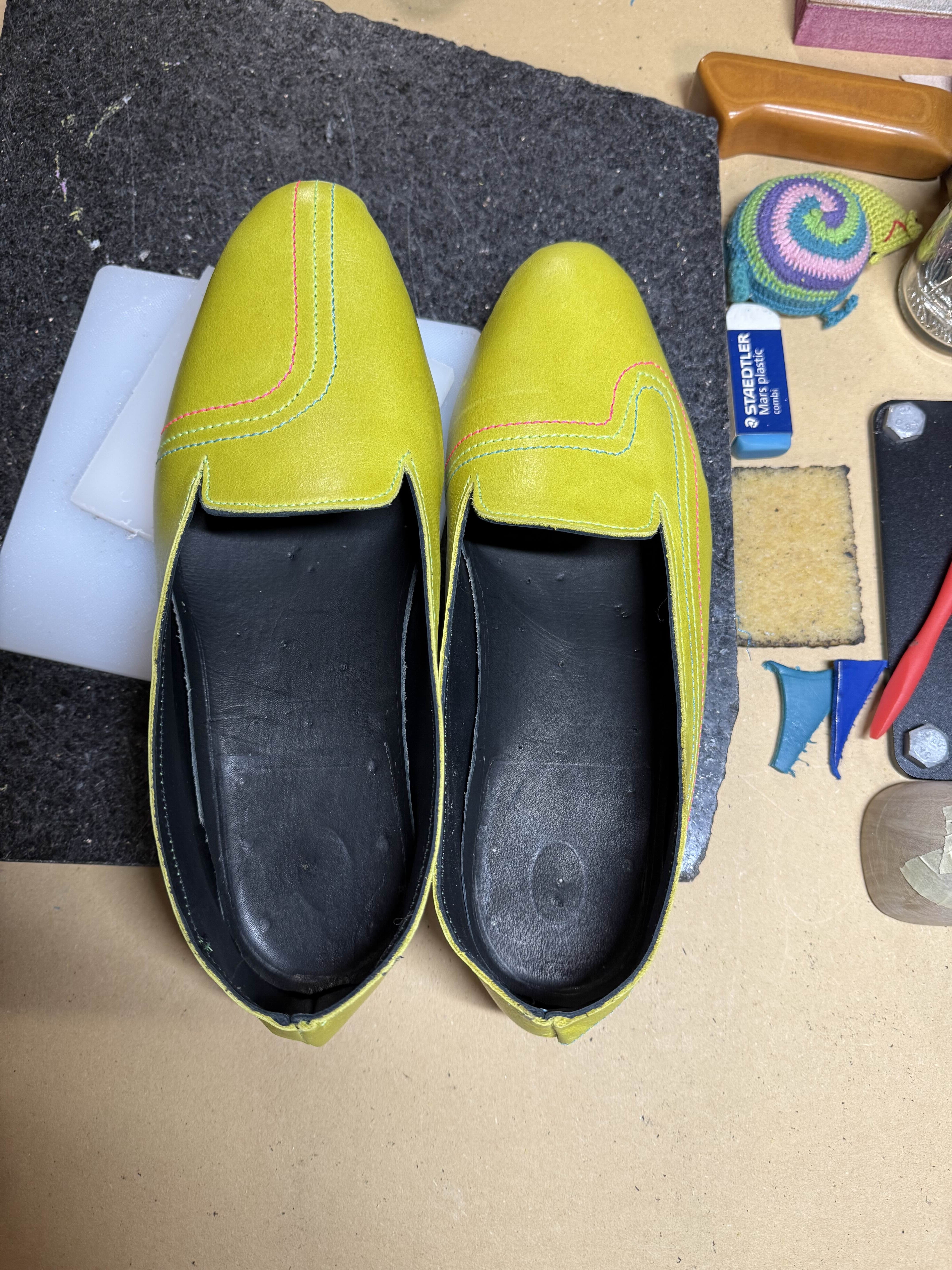

House slippers
Chartreuse was from scraps I took from an industrial sewing classmate, playing with my new thread colors with a retro swoopy thing.
The light pink is i think 5-6 oz, making slippers for my friend (who is also our dungeon master for DnD).
just glued scrap on as my soles, but over a veg tan insole, planning to do the same for hers
Cool vamp stitching!
I’ve also never done a nice rolled/folded top line so i was gonna try that on hers as well. Unlined because it’s nice and soft on the inside, and thicker.

wow, I forgot to add more photos! I did not actually like how folding over the top line went. I thought because it was so nice and soft on the skin side that I should let the slipper be unlined and it would be a nice detail, but it’s not really the same as whatever you call the nicer top on boots. That said, i think i got very good at drawing a 20 sided die and doing some colorful sewing (the very simple kind)
