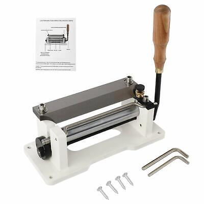

I use this one. It’s identical to the one tandy sells for twice as much. I got it because several people on the leatherworking group recommended it. Once sharpened it makes a very consistent split. Make sure to use a test piece; Since it’s a pull type machine, the leather thins a little bit as it stretches and so the final thickness of the leather once tension is removed will be a little bit more than the actual gap between the blade and the roller
This is more or less what I ended up with. The paint on mine is black, but otherwise it looks the same.

I put the Chinese bench splitter to its first real test today, thinning down backstraps and tongues for my fourth pair. I decided to do standard, loose, non-gusset tongues from the upper leather this time, relying on the splitter to thin down.
One big takeaway: I had more trouble pulling the pieces through, especially the tongues, than I expected. Certainly more than I’d had with straps and belts on others’ splitters before. It really paid to think ahead about where I would start from the middle, to ensure I’d have enough to grip and pull on both sides.
I did a lot of fiddling with the set screws, relying on equal degrees of turn creating equal changes in set height on each side. In the end, I think this was for naught, as I was reliably setting and locking down the tension arm above the limit, basically using the leather itself as a squishy stop.
I ended up doing a lot of splitting, then splitting thinner, then splitting thinner again, rather than setting for one thickness and doing a single pull. I was worried about being able to pull the tongue pieces through against that much resistance. Perhaps the better approach was to set the screws precisely where I wanted the depth set, crank the handle until it hit those screws, lock down, and pull through all at once.
