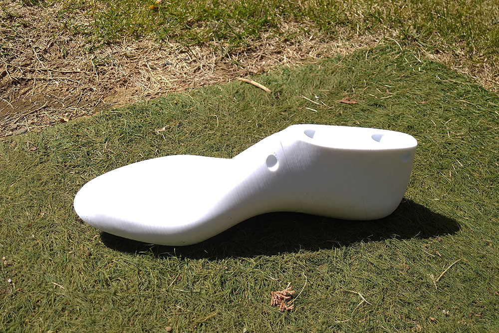

Another MSY “wow” moment: 3D printed shoe lasts…back in 2021.

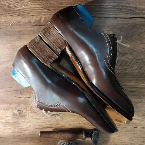

Japanese trained Singaporean shoemaker Tor Cheng Yao has a nice blog post on heel finishing. I used his process (with Columbus wax) to restore the edge on some worn out boots and it came out great.

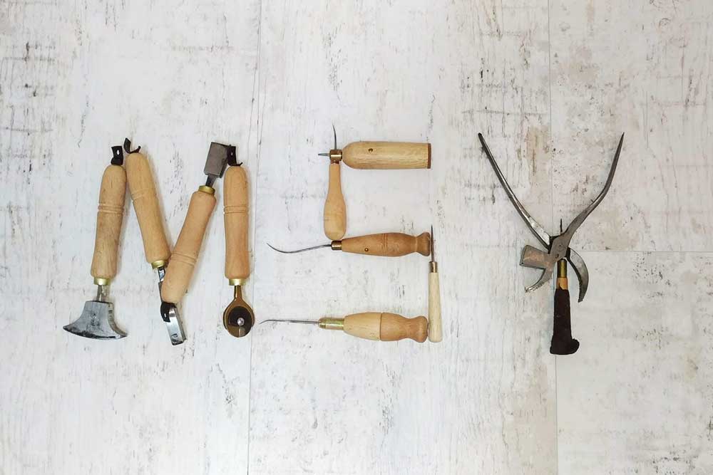

Japanese blog post on online shoe making tools and supplies.
It helped me find a made to order last maker that takes orders online.
They have a large catalog and show what a finished shoe looks like. They also allow a ton of customization. Not sure if they ship overseas but I sent an email to check. They have another online store that has an overseas shipping option but it says its EMS which has been shutdown to the US since the tariff wars. Crossing my fingers that it isn’t a mistake and they ship overseas.

Their catalog really is something. Showing shoes and boots made on the lasts—what a concept!
