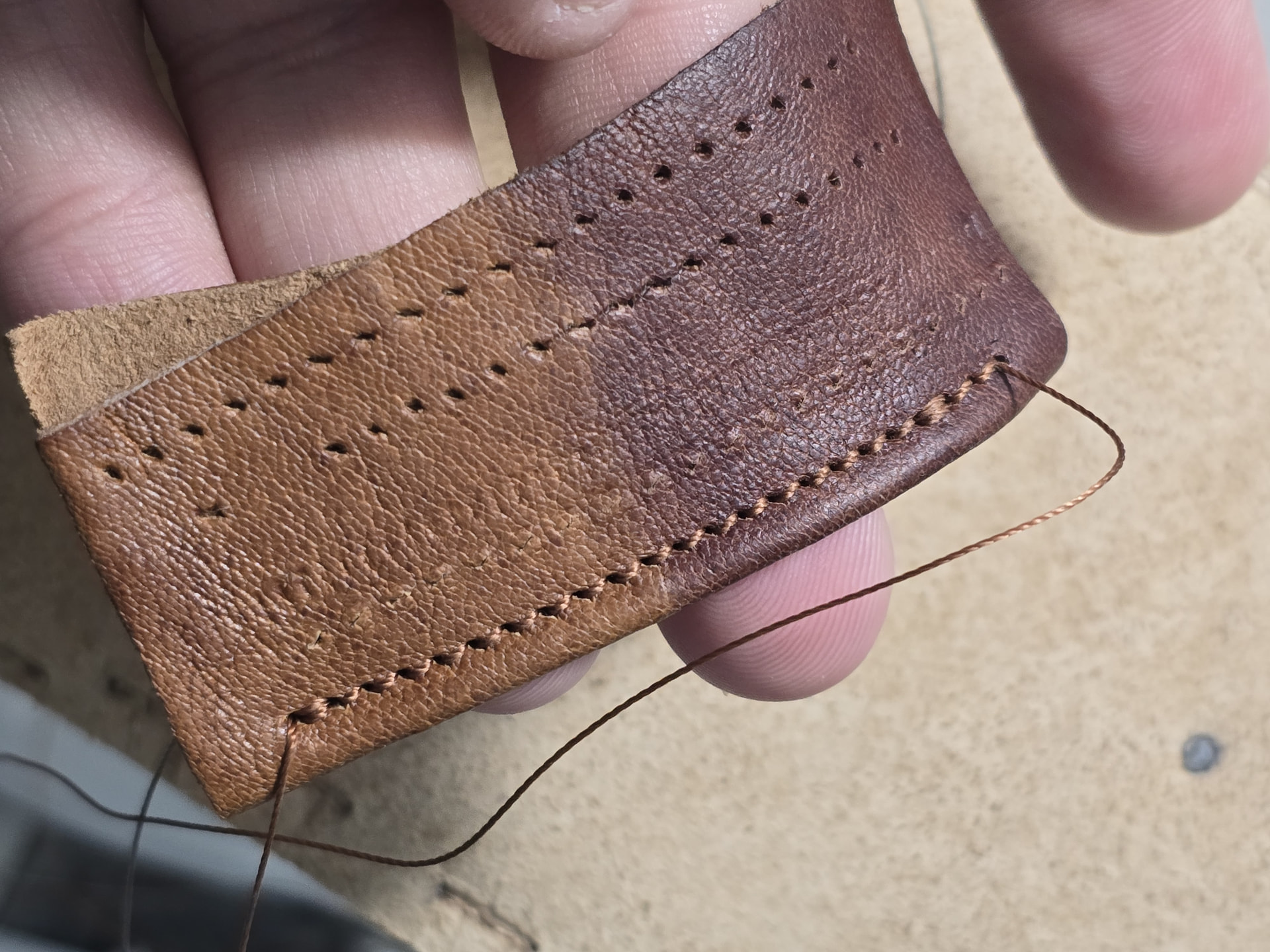

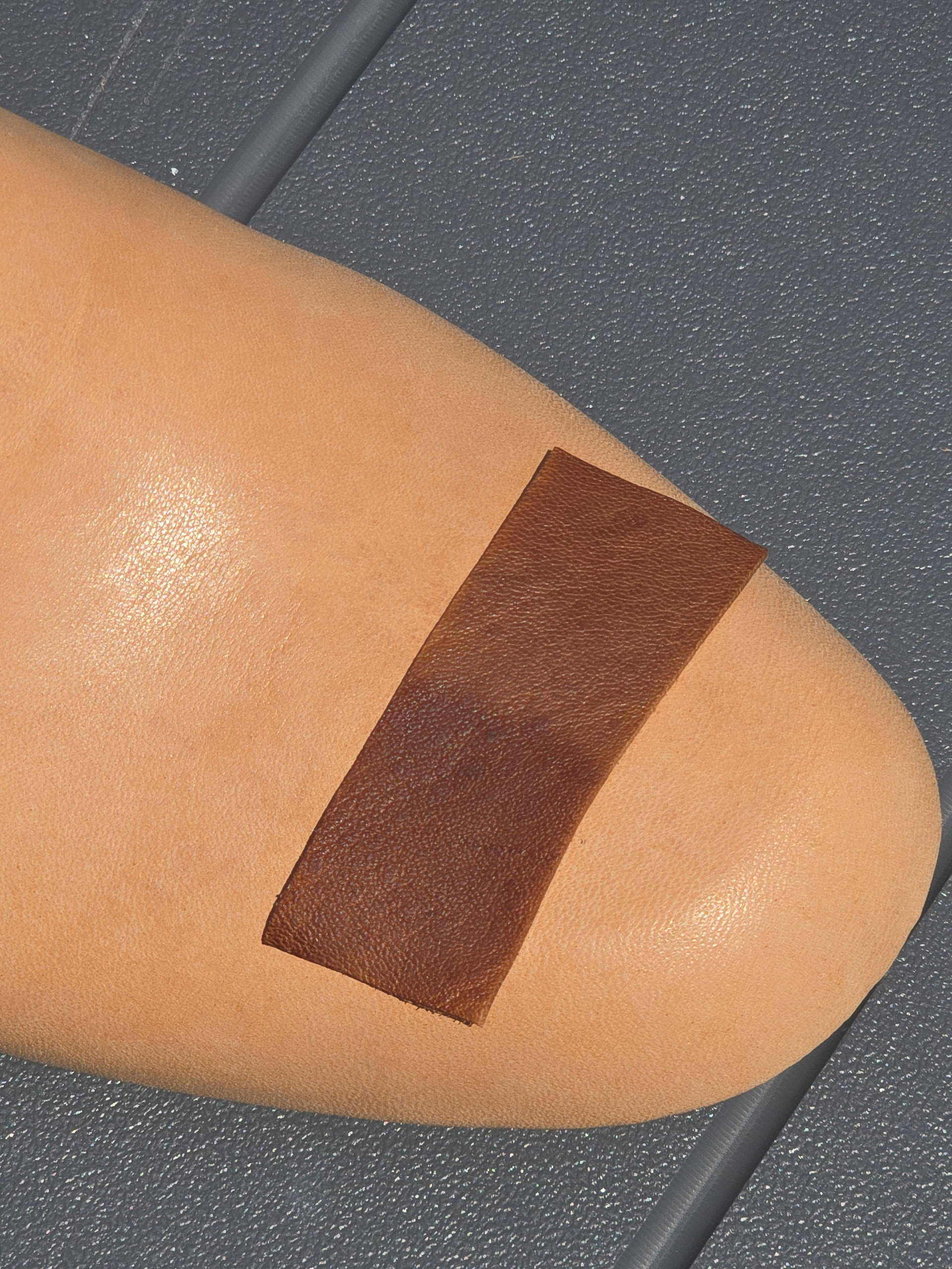

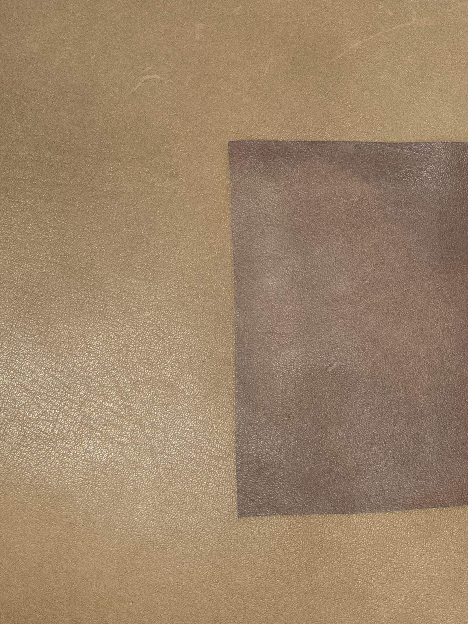

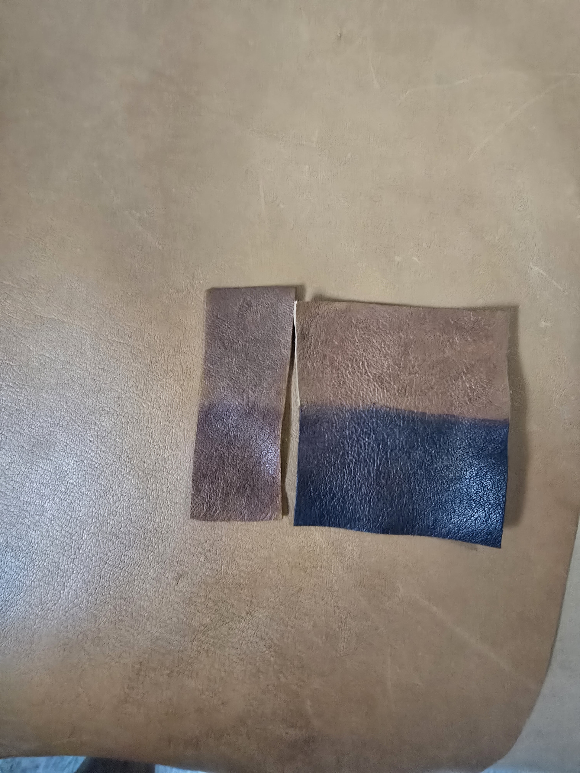

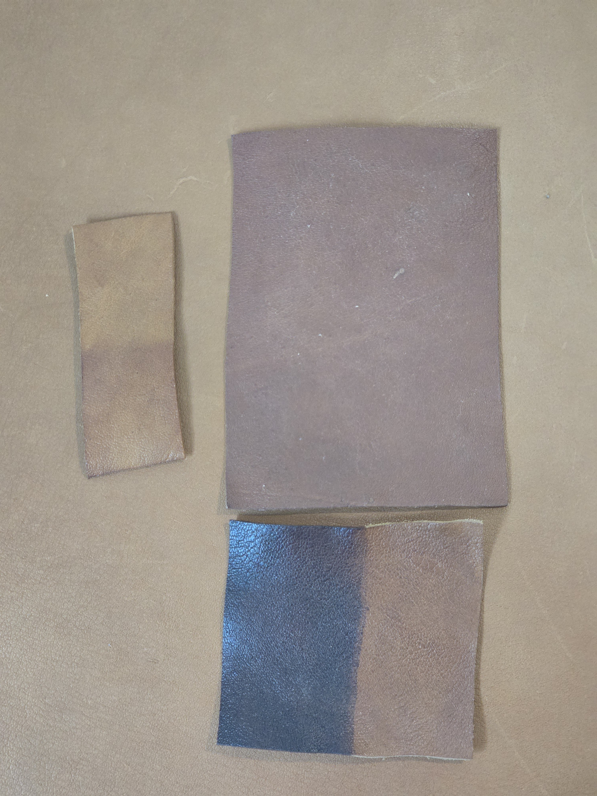

Here are a handful of photos of different samples. The dark/burgundy tones are a result of doing an alkaline shift by dipping in a solution of soda ash.

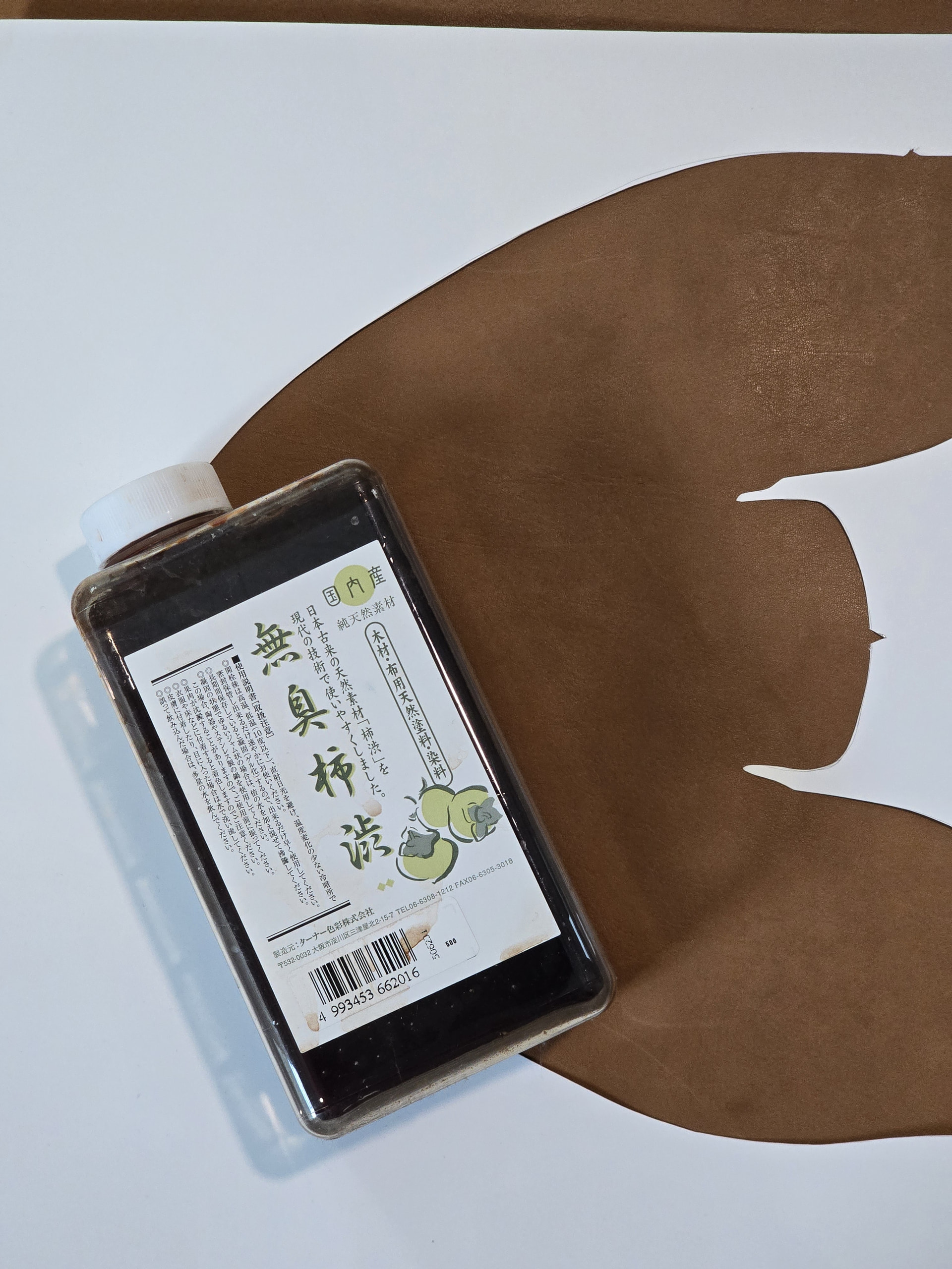

what form is the dye when you receive it? a powder?
I bought somw powdered and this pre-mixed liquid one. I like the pre-mixed one better than the powdered.

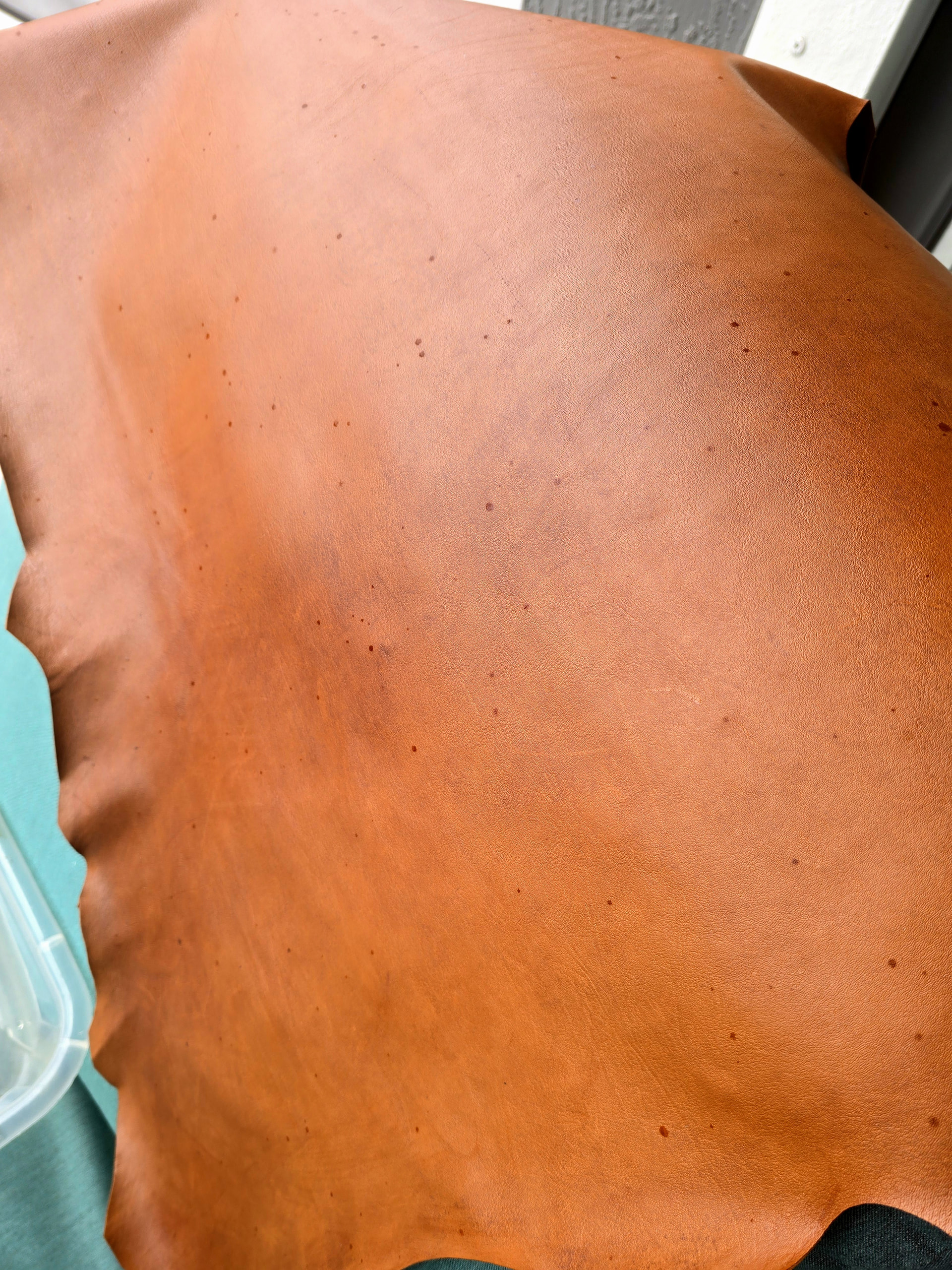

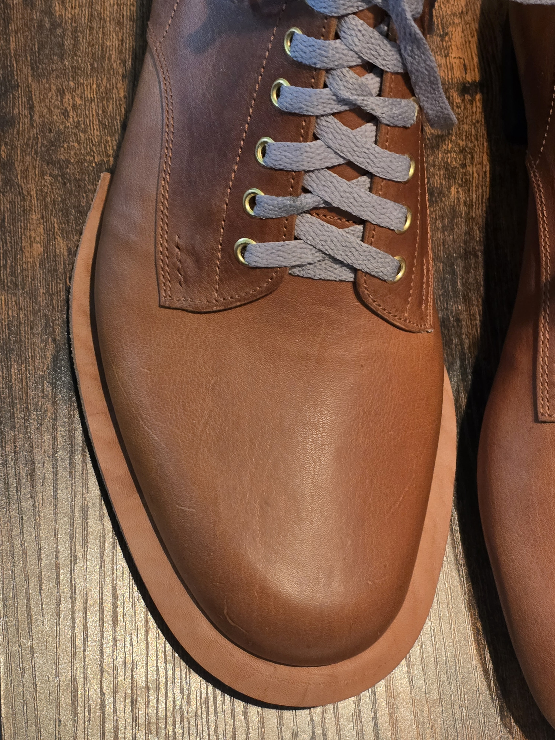

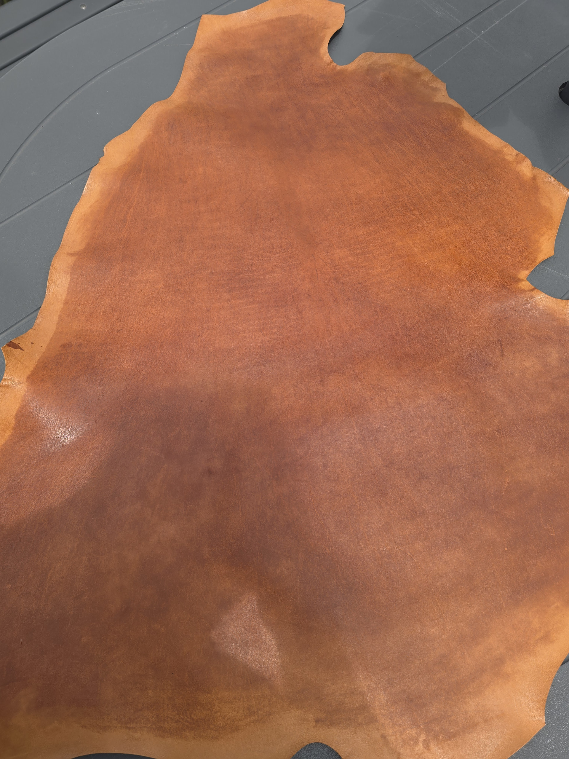

This was after about 7 coats, each left to dry in the sun for about 10 minutes. Got a little darker than the starting leather, but picked up a wonderful golden warmth. Ended up starting to rain, so called it quits at 7 coats. 5 from the powdered (about an ounce of powder mixed into 600 ml of water and a drop or two of soap to act as a surfactant). Final 2 coats were the stronger pre-mixed without any soap added.
Think I am going to forgo the alkaline dip. The color on this is awesome as is, so no need to mess with it.

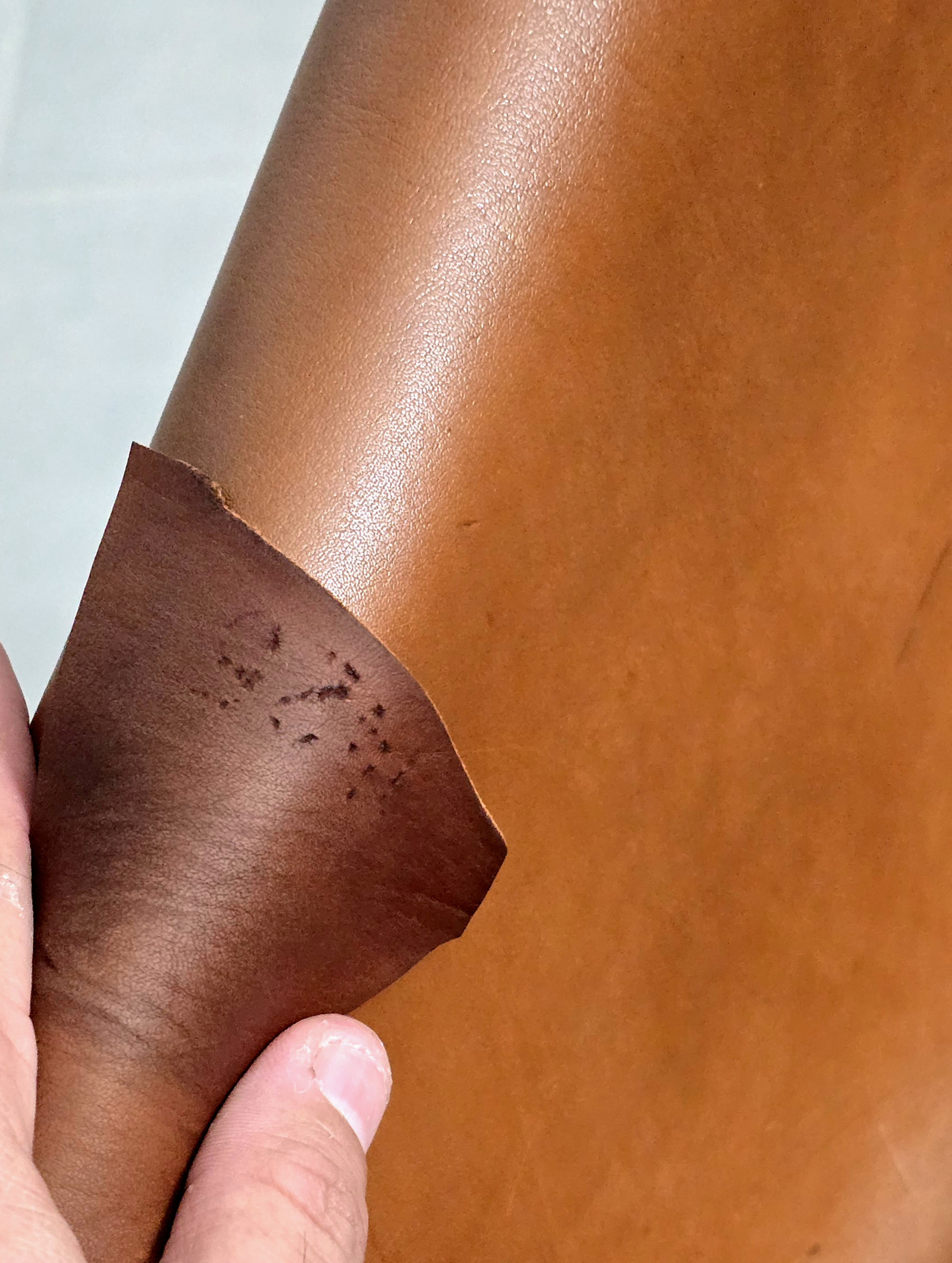

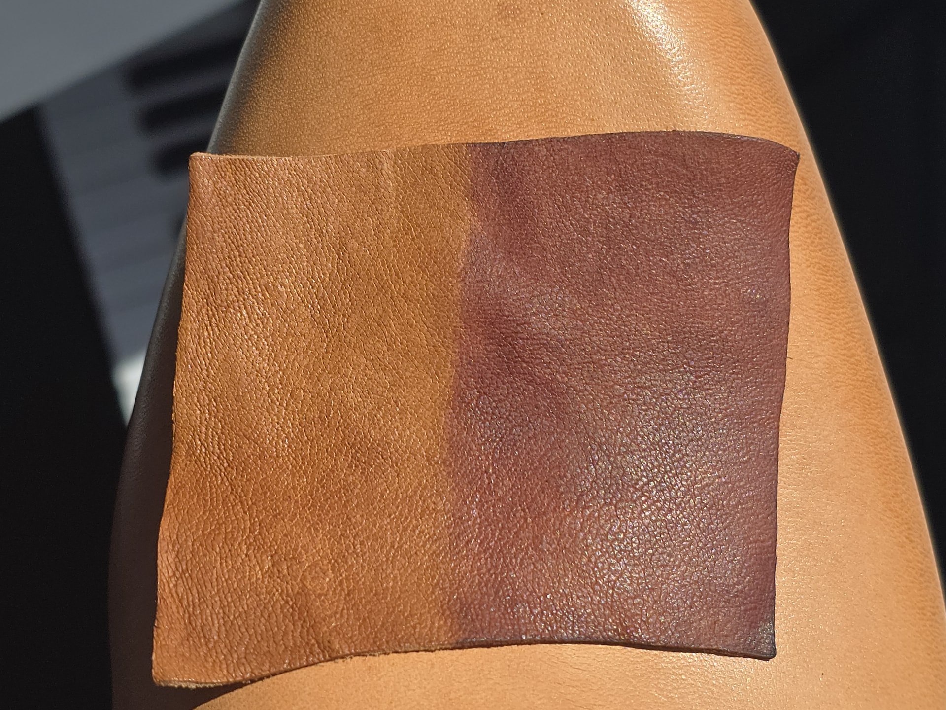

Little color comparison of a coupon that i did the alkaline wash on against the whole hide.
I don’t hate it.

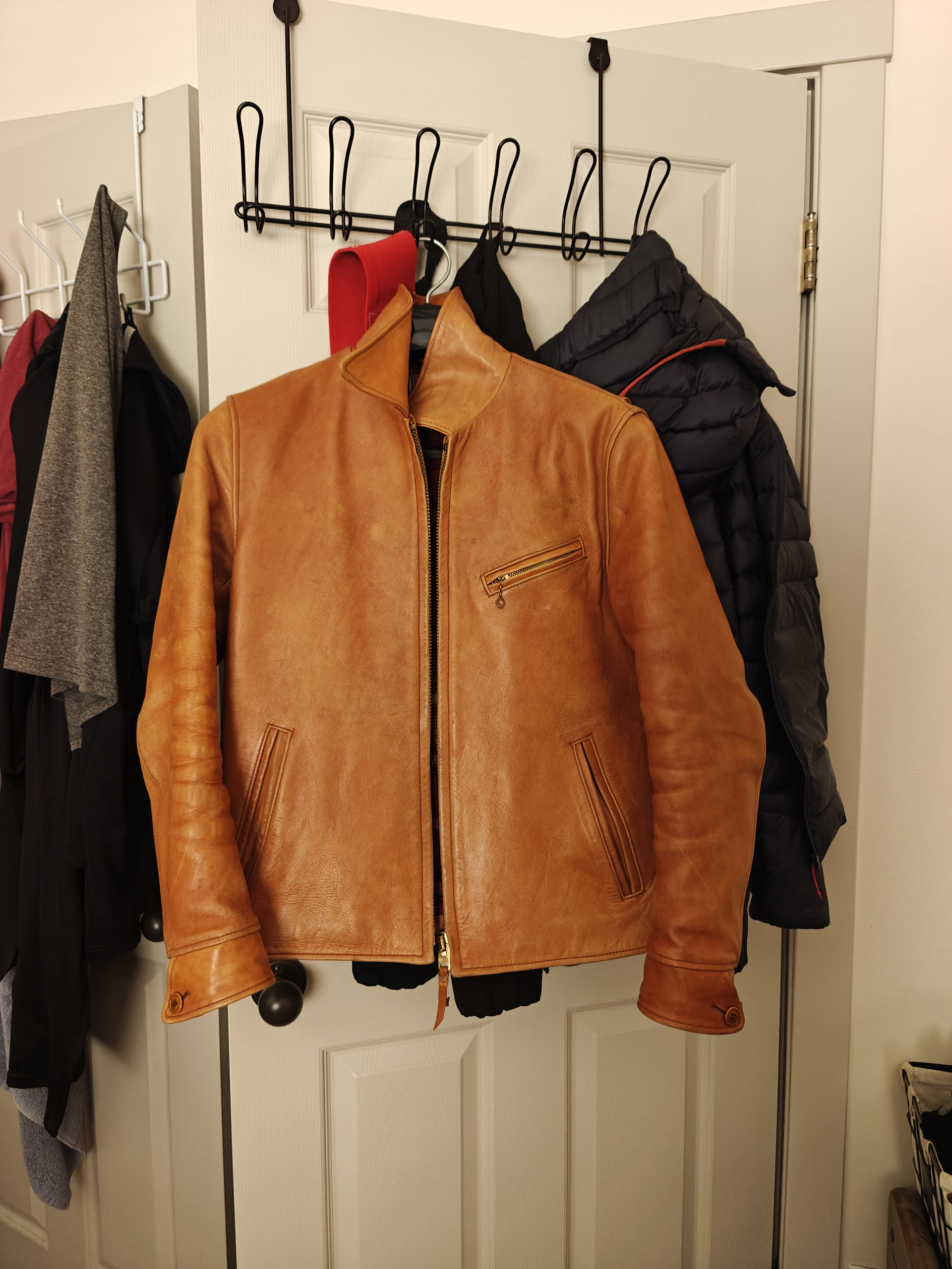

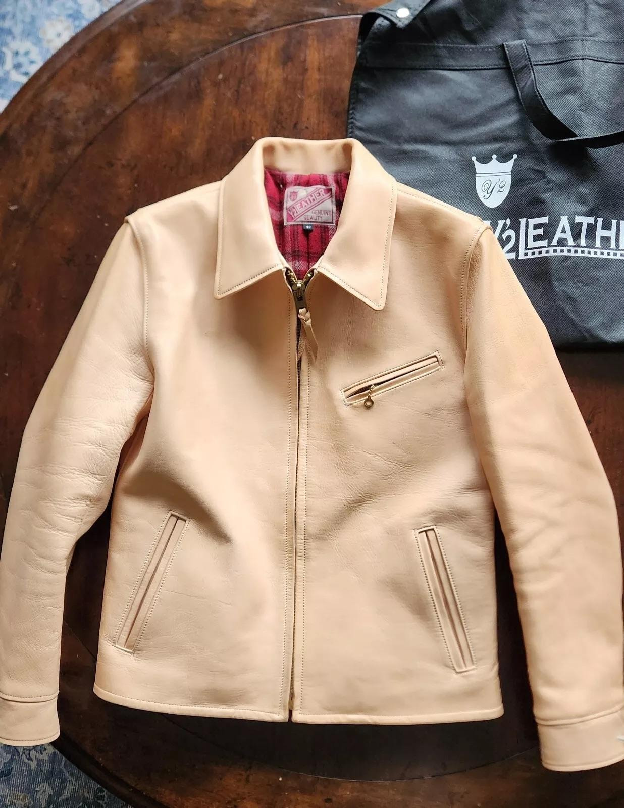

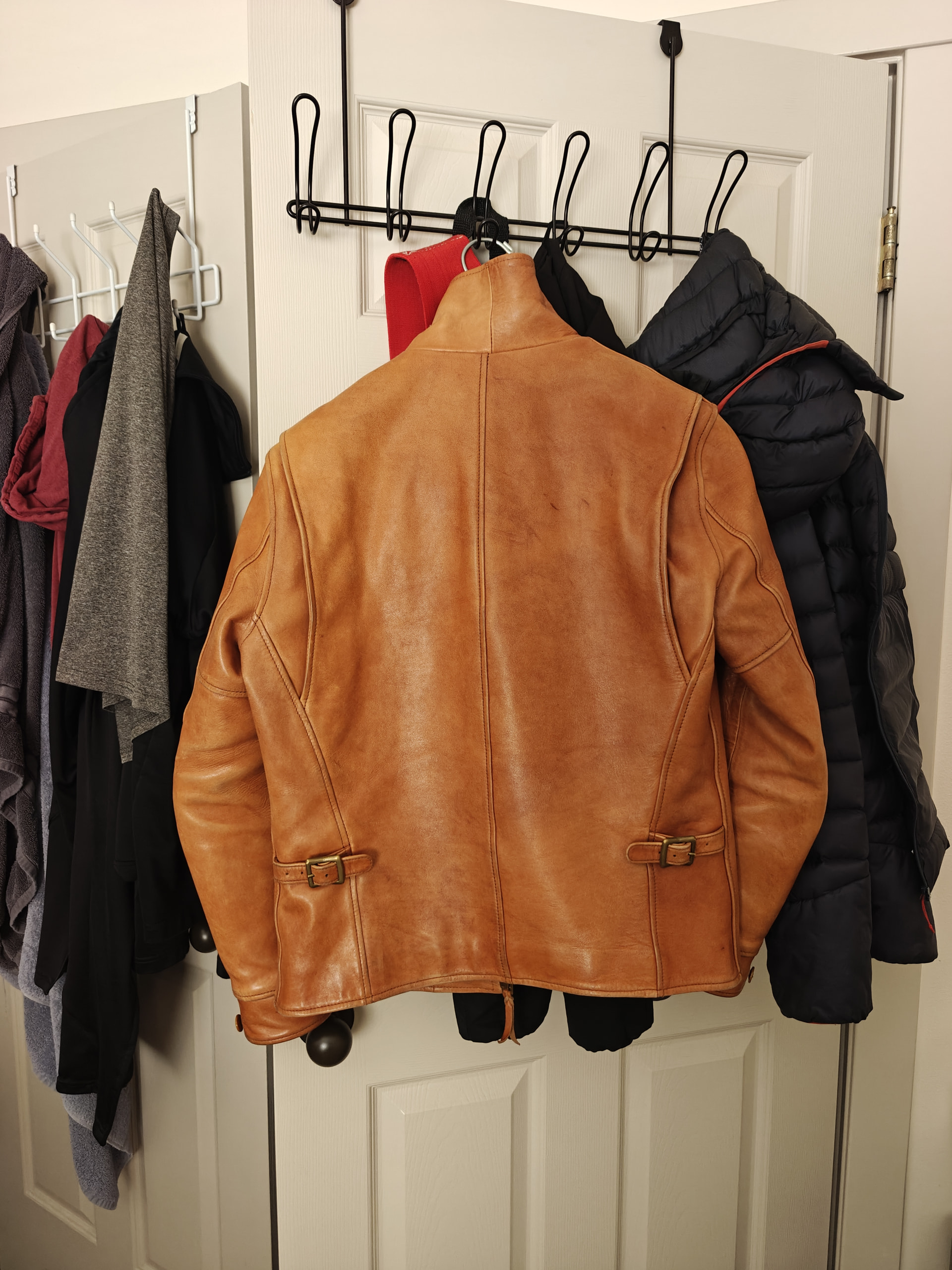

Oh nice, I had basically that exact same idea. I have a kakishibu jacket, and it’s so gorgeous to me. I get compliments everywhere. I purchased that exact dye from Amazon, and did some tests on various pieces of cowhide. I never got further than setting up the experiment pieces for sun tanning though.
I had very mixed results on different leathers. The kangaroo seems to accept it quite nicely; other stuff I have tried, not so much.
I did some tests deglazing first, soaking in a mild alkaline first, soaking in a mild acid first, etc. In the end, a light spraying with some water to pre-wet the surface and then hand applying layers with an old t shirt worked well.
Beg you for a photo?
This finish is entirely new on me. I’ve never seen it in person.
Yeah, I will get a picture for you later today. It’s a great looking jacket. Color is similar to a Russet type of color way, but much more interesting, in my opinion.
Here are the pics:
I am not the original owner, but this is what it looked like brand new:
They can really develop a gorgeous patina.

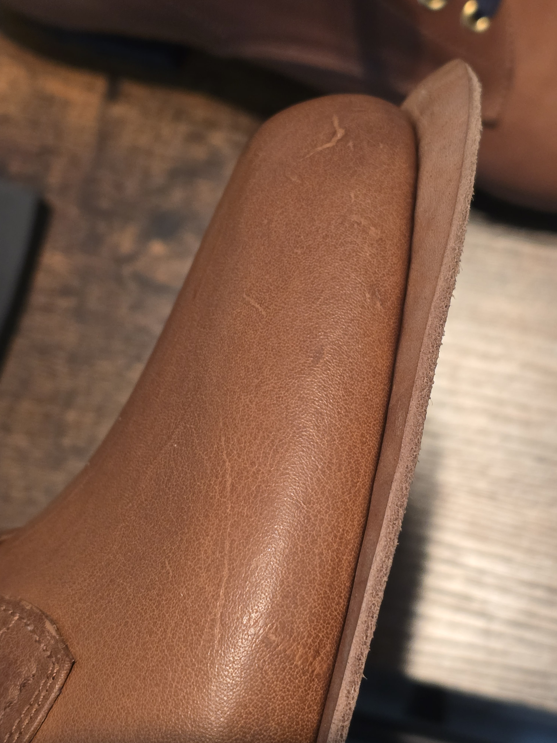

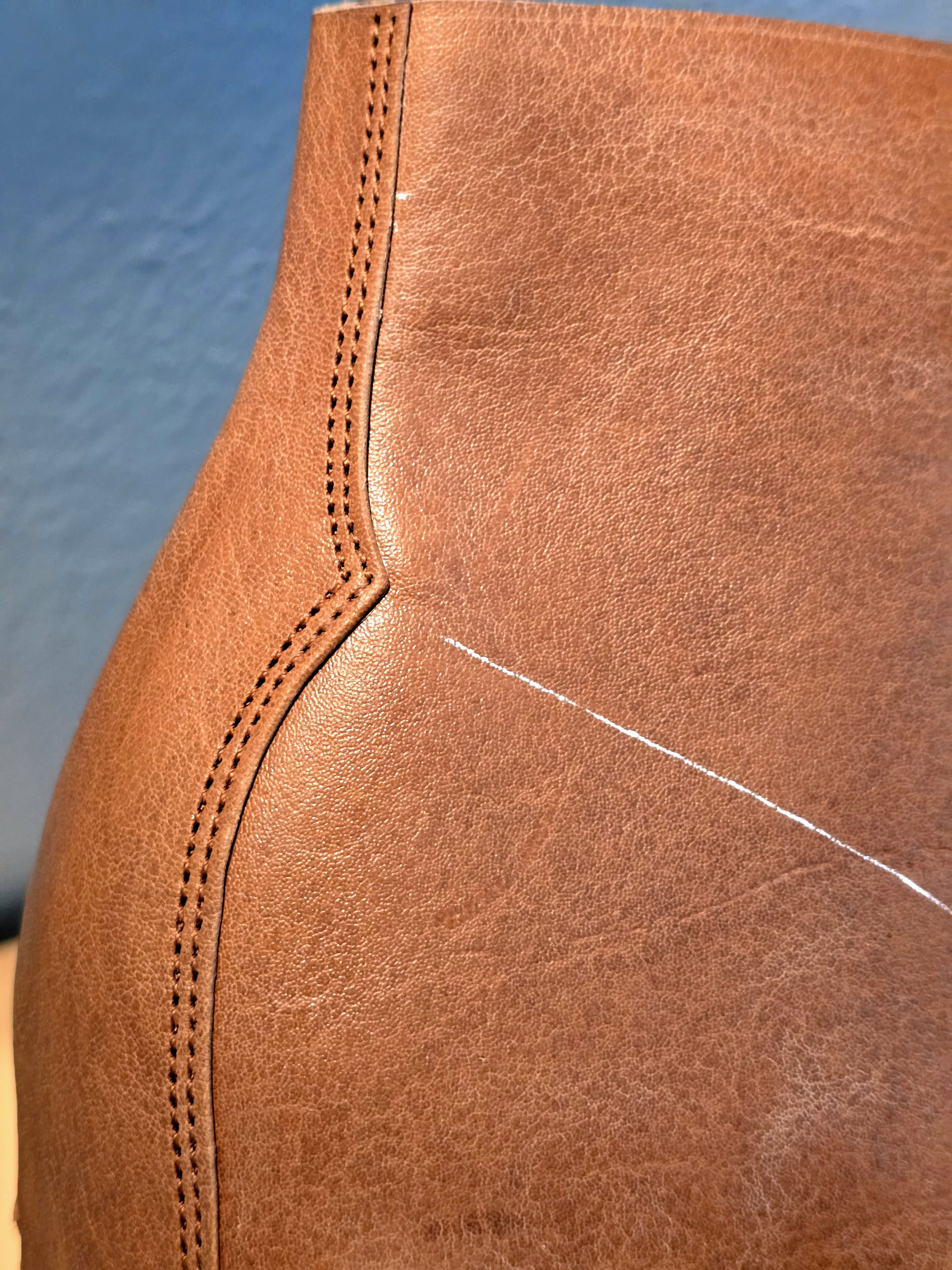

Conditioned it initially with jojoba oil, and then a coconut oil/beeswax mix. Definitely liking how it is looking.
This is renewing my interest in kakishibu. I love Kangaroo, but I have not yet decided to make a pair with it. I do have some natural Maryam 'roo though, maybe I will give the dye a shot and see how well it wants to behave in the sun.
It’s an interesting look on the maryam because it starts out a bit darker. Looks like the natural maryam, but with a warmer hue and some more depth to the color.
Will be very interesting to see what it does over time.

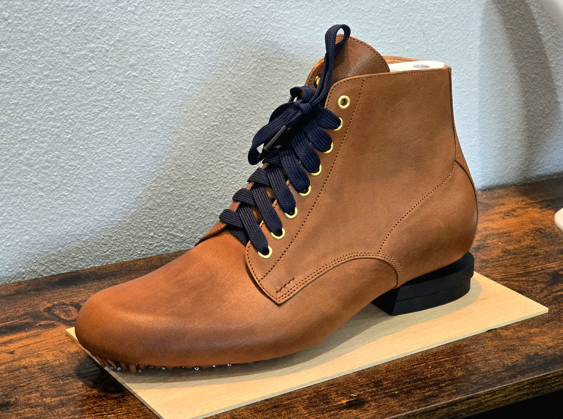

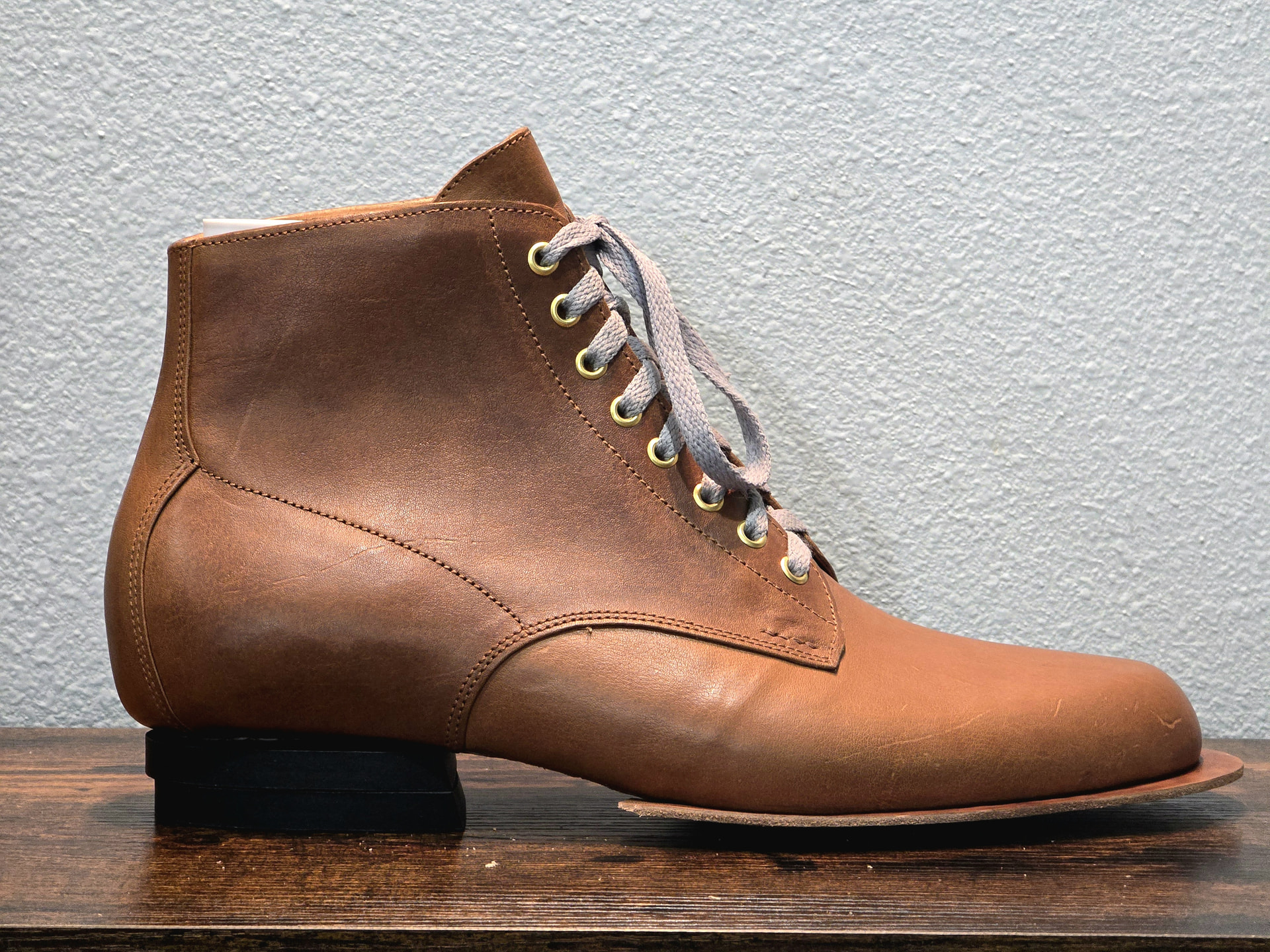

Definitely enjoying this leather

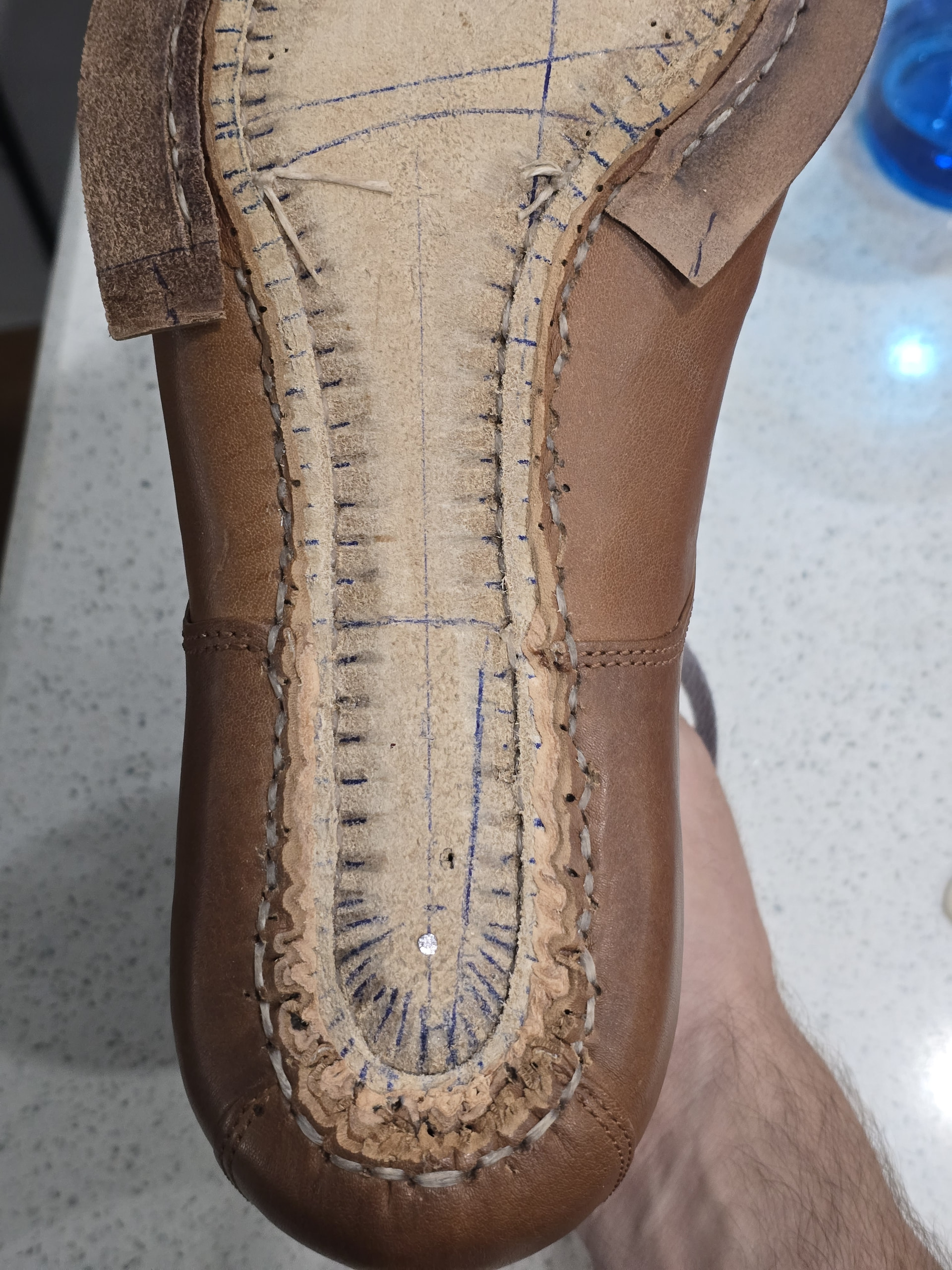

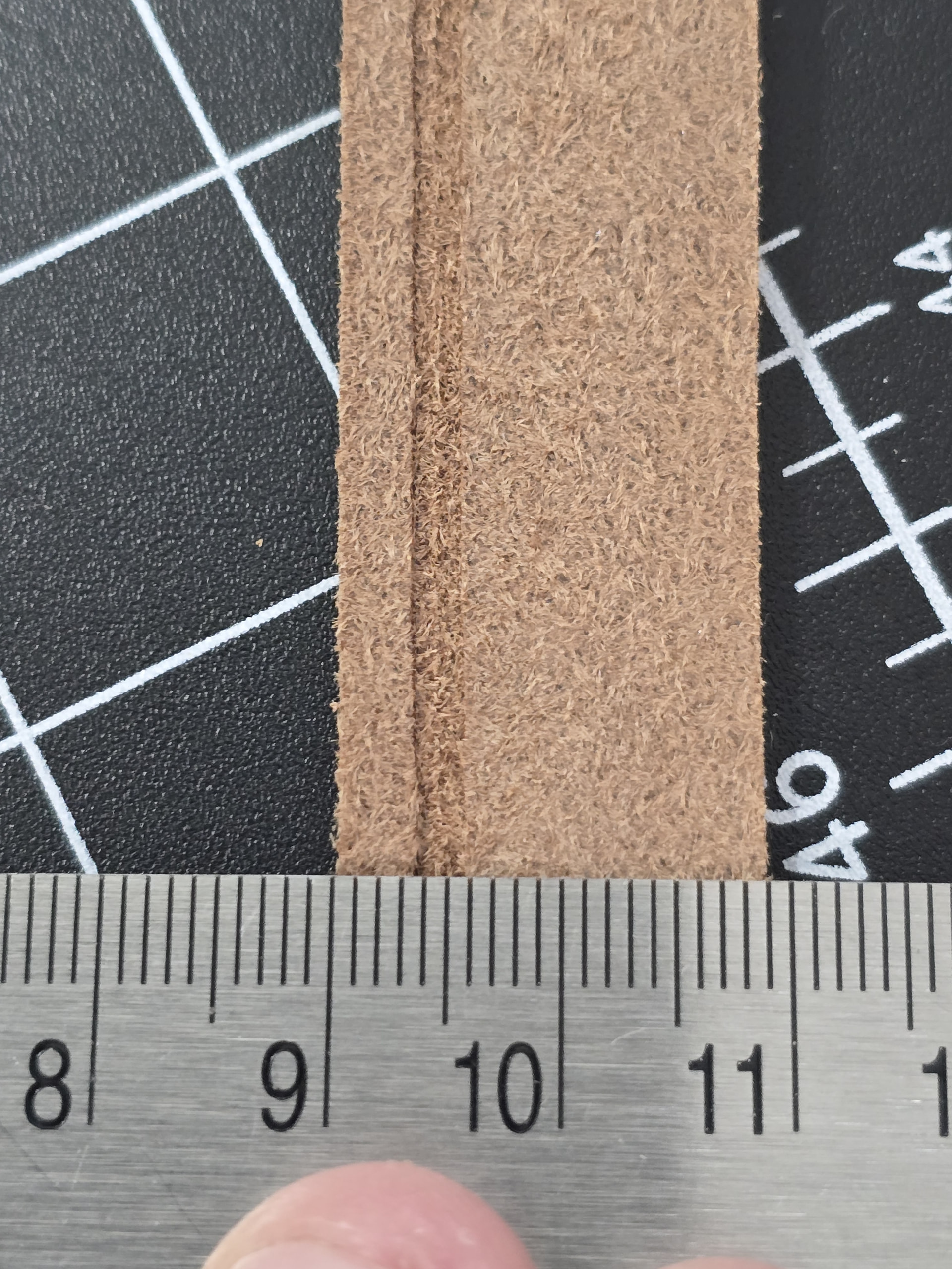

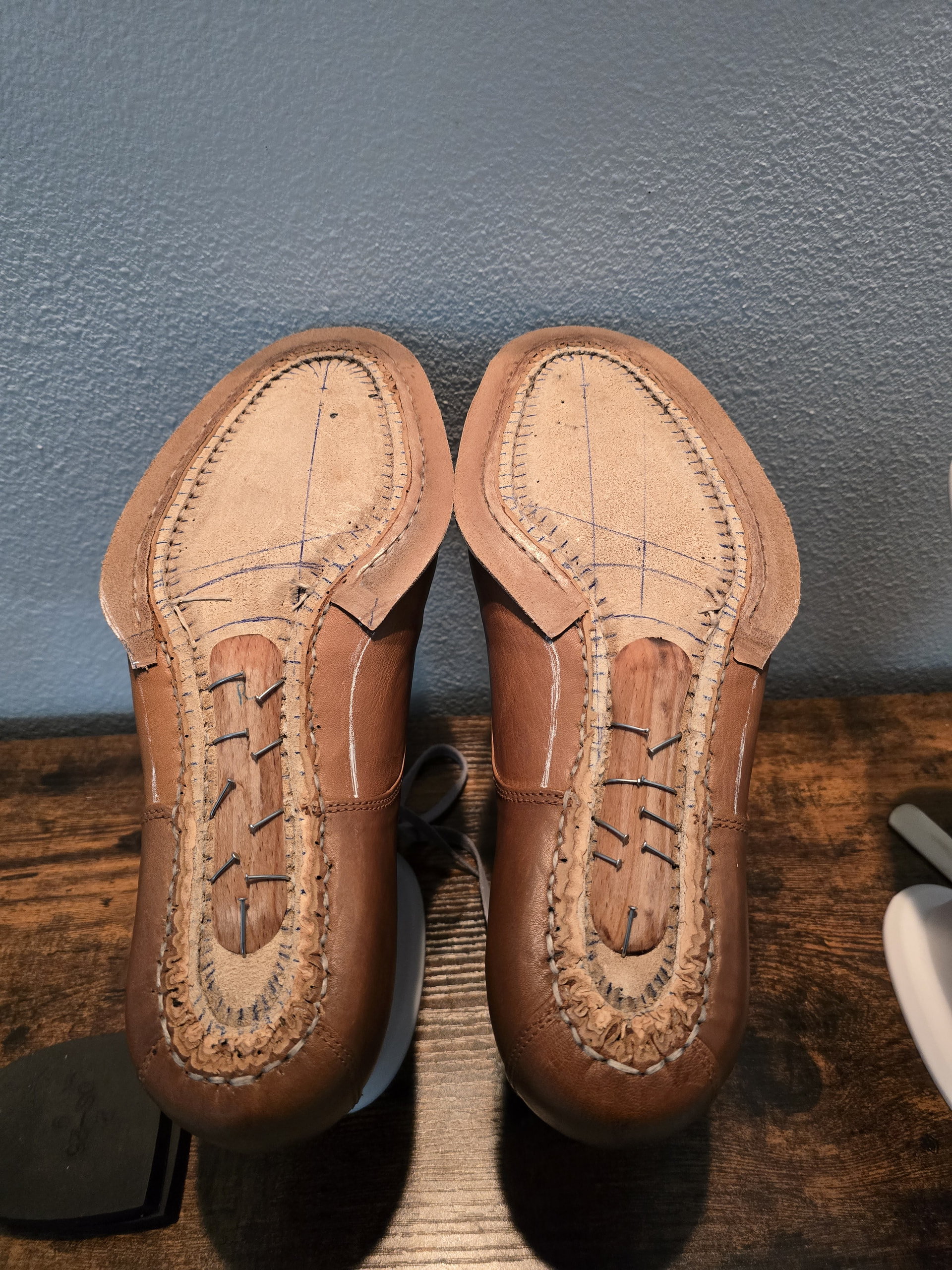

Made some welts out of the horween soft rolled horse hide strips. Works really well.
Looking really clean.

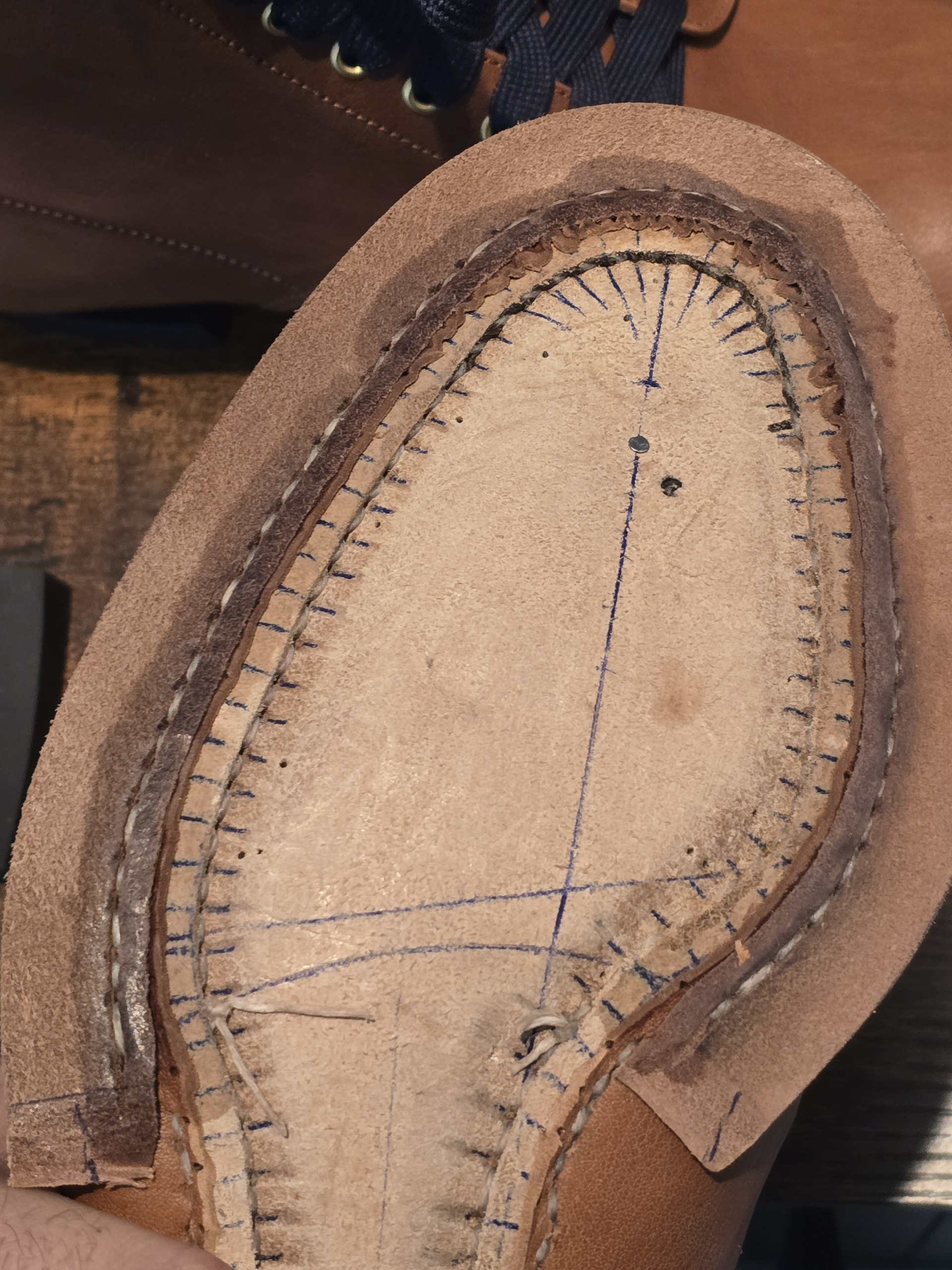

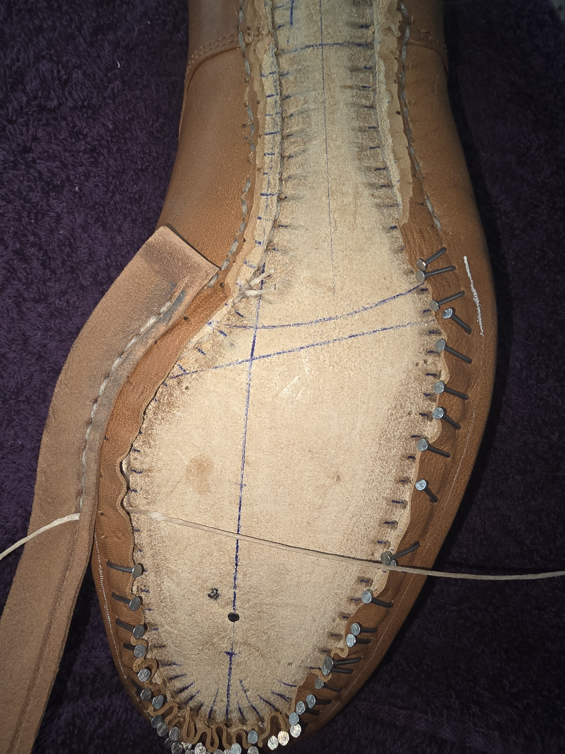

Don’t forget to take those flush-set nails out of the insoles! I’ve personally taken to doing my insole tacks through some little slips of red ribbon, to make sure I remember to get them out again.
A remove-before-flight tag is a good idea on those. I am at a point now where they’re safe to pull, so might as well deal with them before I forget

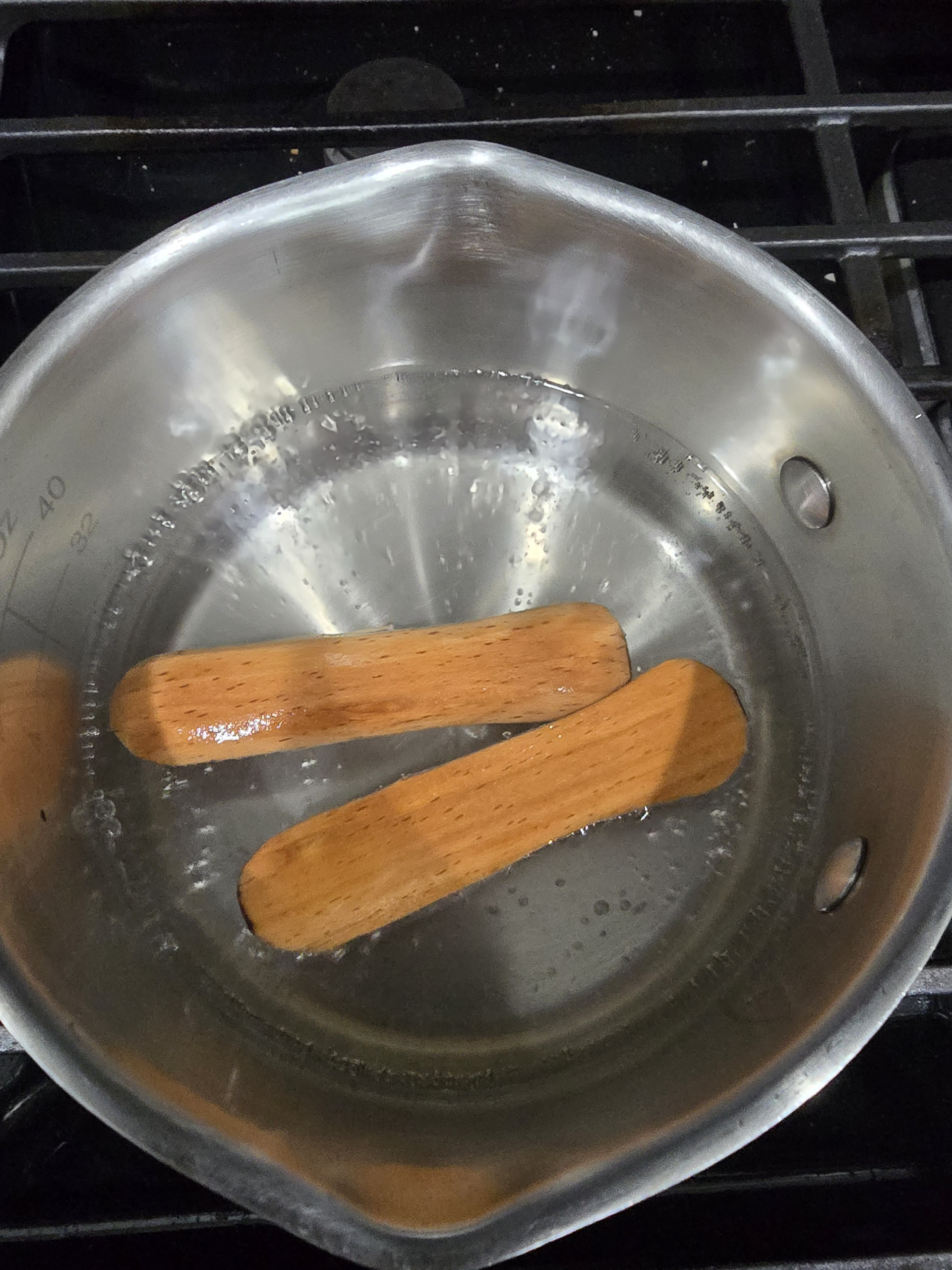

Making some boot tea with these beech shanks.
Tacked in place to hold the shape while they dry.
