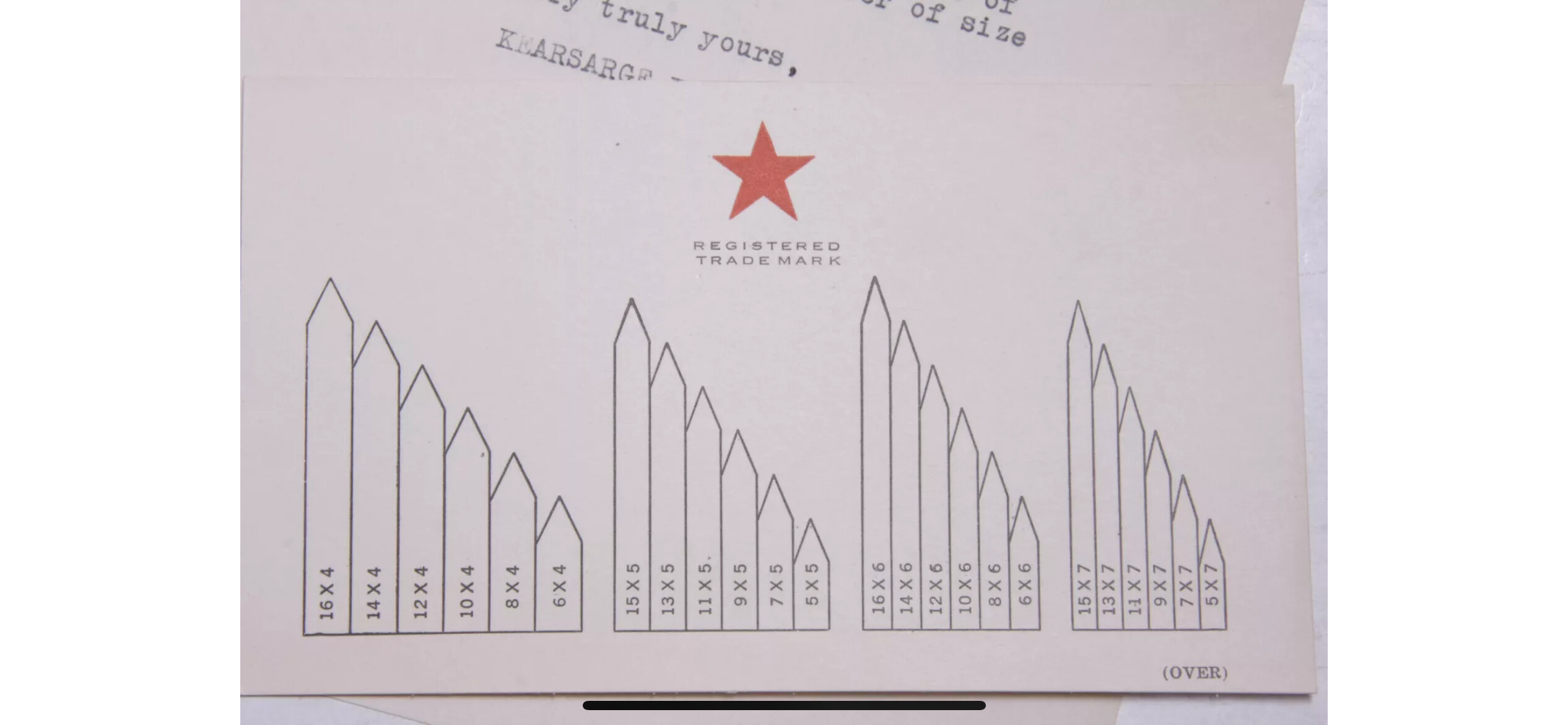

The size card seems to be using the same general sizing system as Blau Ring, but with Ă— instead of / separating numerator and denominator.
However, I don’t see some of the finer widths cowboy boot makers seem to like on their chart, like 5½ and 6. The only size from my notes that I see on that card is “5 × 7”, which some folks use for heeling.
Maybe Kearsage could do finer sizes, and they just don’t appear on the card. But I’m also thinking back to the video @thenewreligion shared. I think Paul, the owner, mentioned twice in that video that shoe pegs were used specifically for attaching heels. Perhaps Kearsage only did the widths preferred for heels, but didn’t do the finer pegs for soling.
If it helps the front of the card says “on the back of the card are illustrated a few of our special sizes” or something.

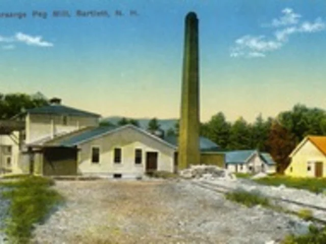

Watching the video again I’m thinking how the heck did that place not burn down before 2016?? I mean its a kindling factory run by a barebones staff and there’s tanks full of dry wood being heated by checks notes burning dry wood?
