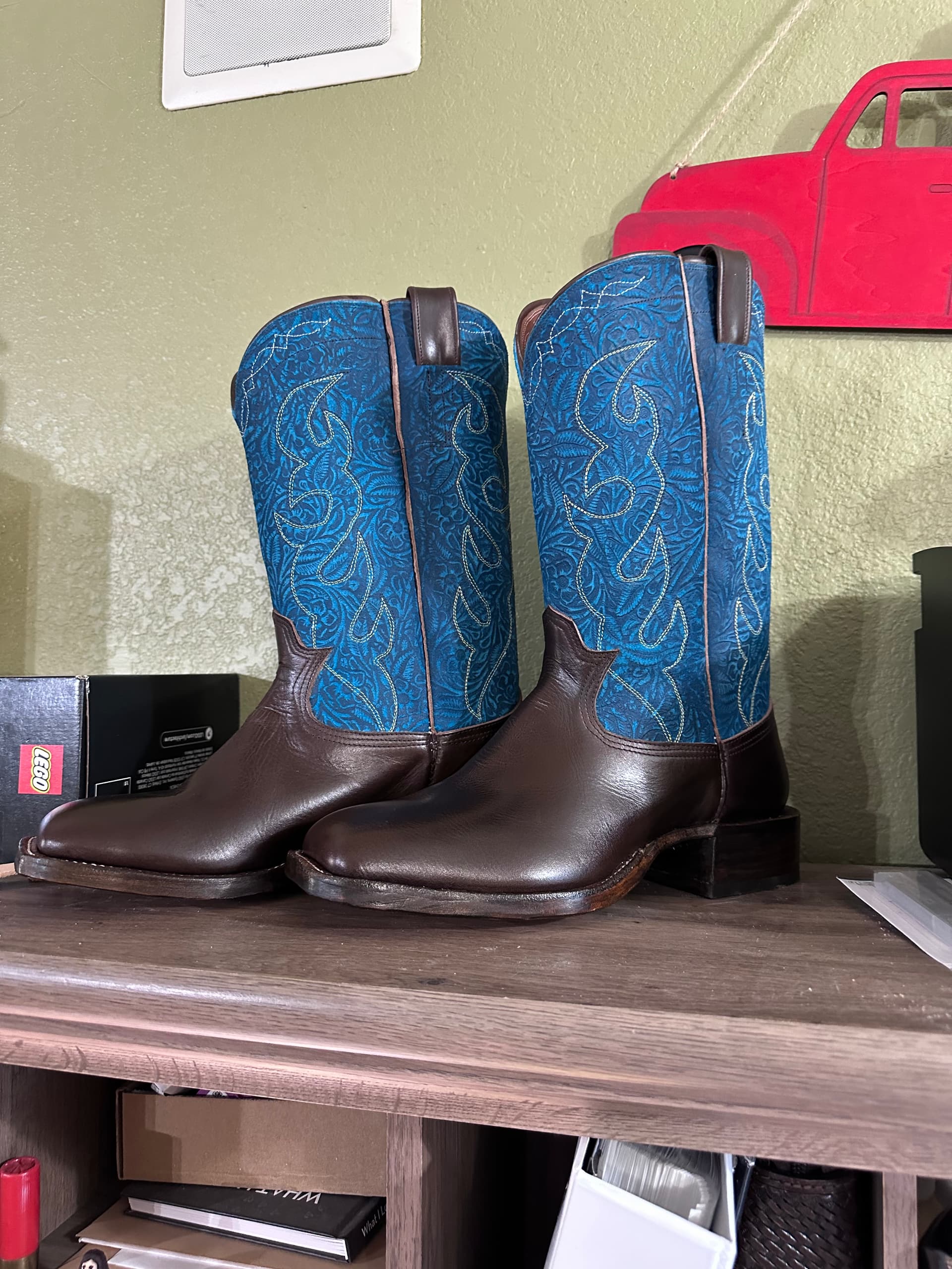

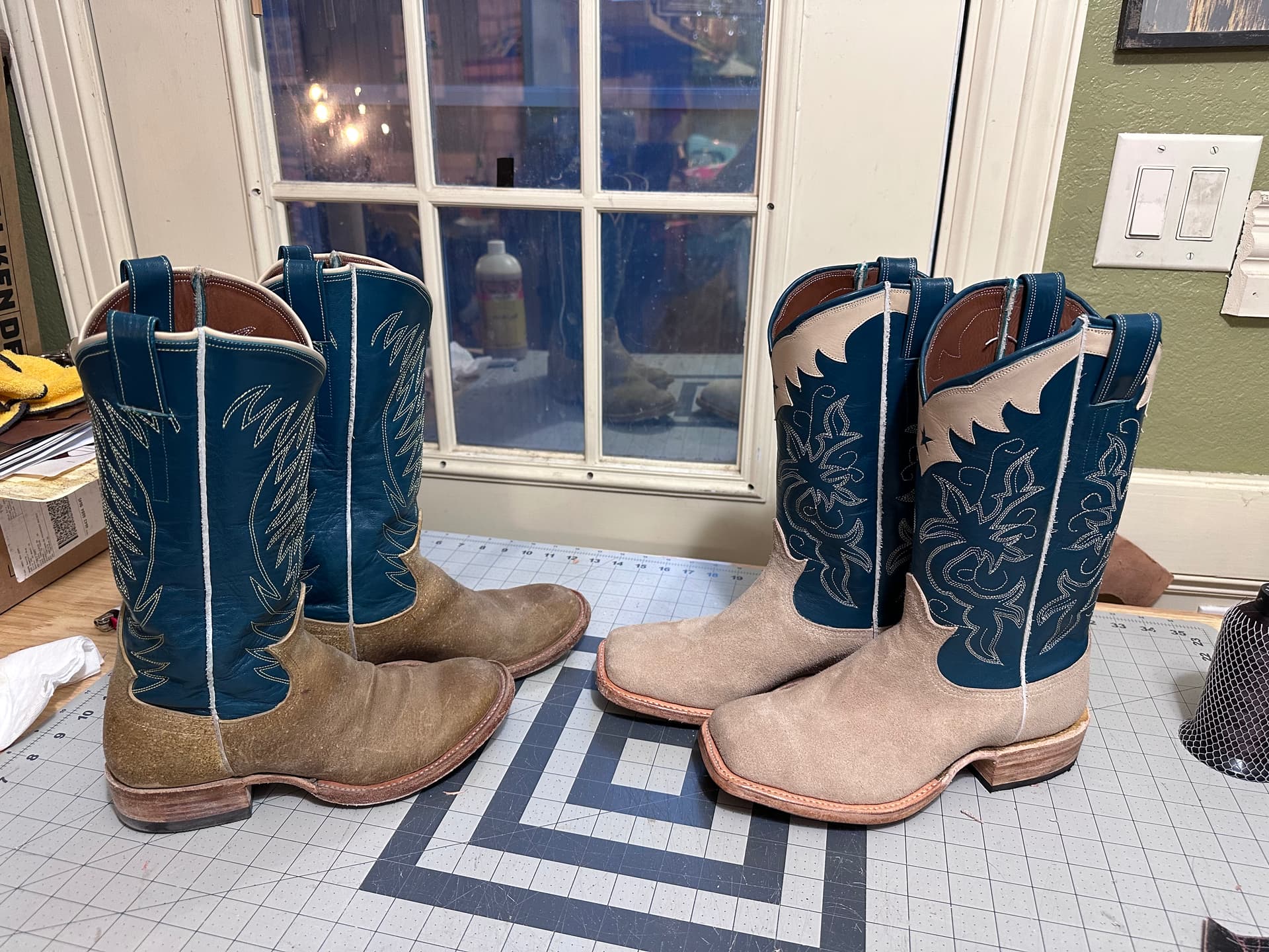

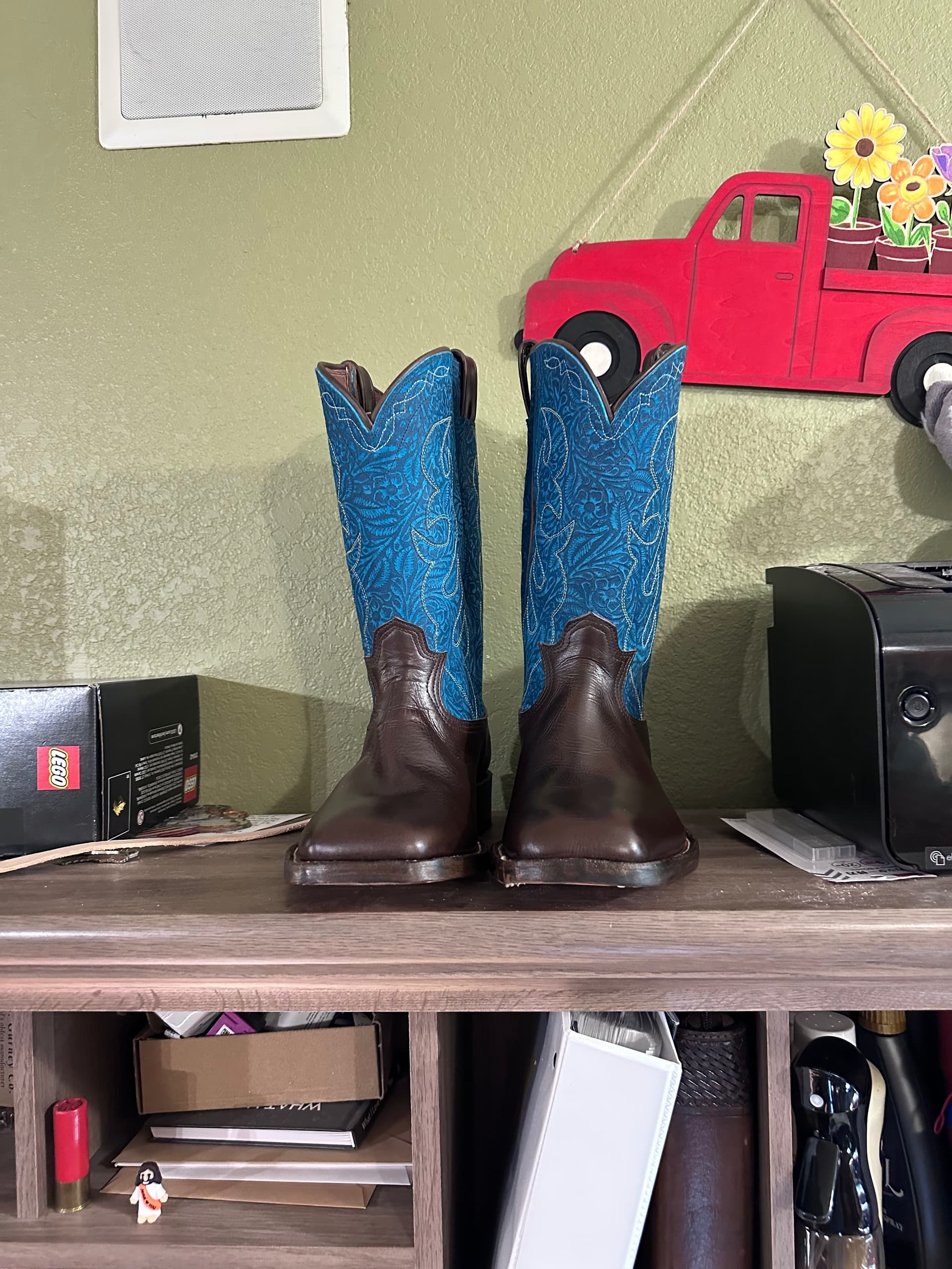

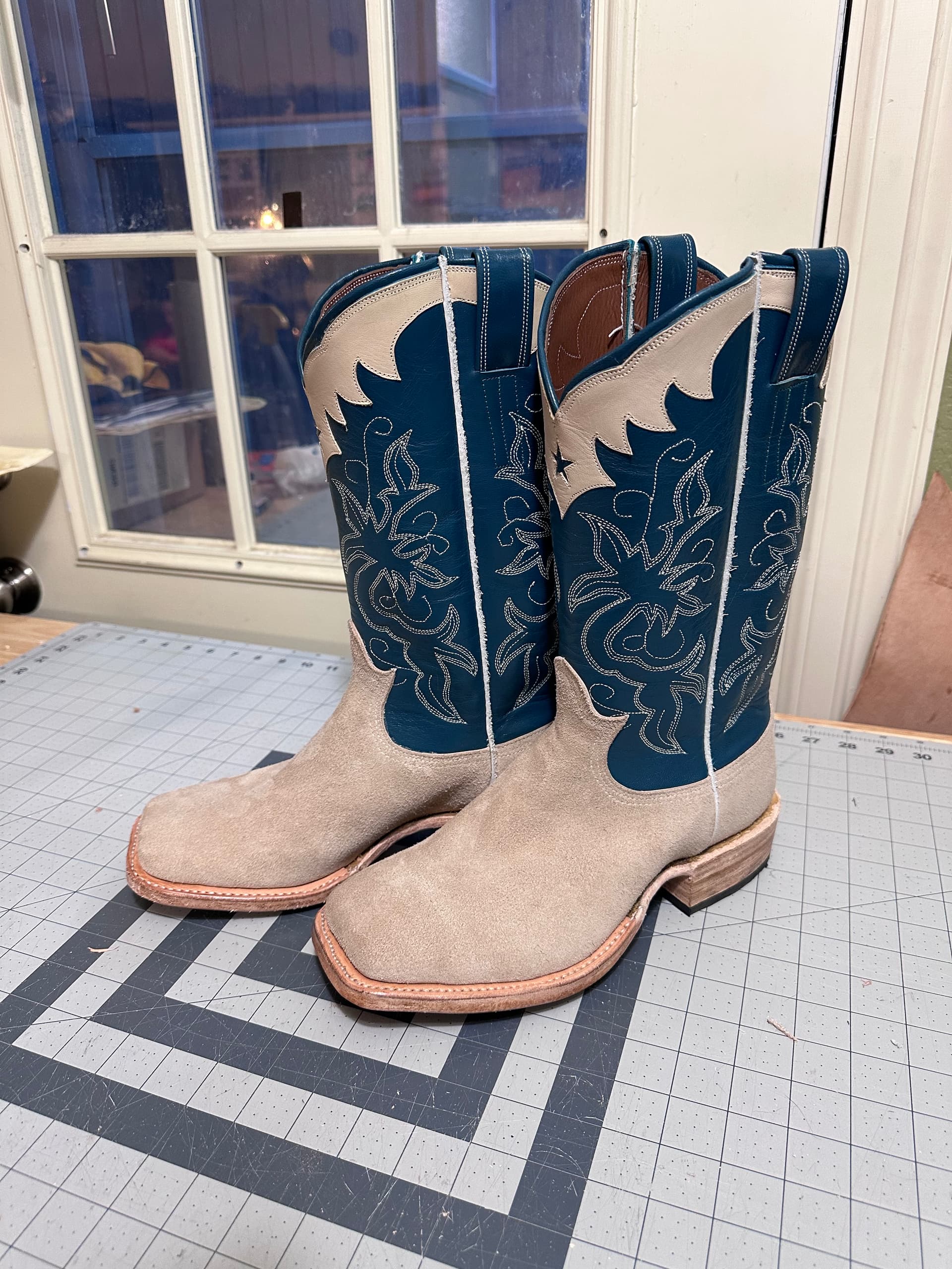

I have settled on the cut feather with groove as diagramed above. Using a king 3.5” and the dimensions listed from lee’s post earlier except at the toe I widen the toe channel to just over .25” just to tuck it a bit more. I do still leave the welt sticking out at the toe but it makes for a better looking toe this way. I have done 4 pairs this way and so far am pretty pleased with the results.
It has made for nearly perfect pre holing and very easy inseaming with nearly everything coming together perfect.
Even figured out how to sew the waist and seat :smiley:
The one thing I still can’t bring myself to do is put a tack through the vamp into the feather channel though I’m sure it would make line up even easier.
Thanks everybody for bearing with me. I’m real disappointed the computer gremlins showed up right on a day when we greeting new folks and having good conversation!
These aren’t inseaming photos, but are the product of the above measurements.
