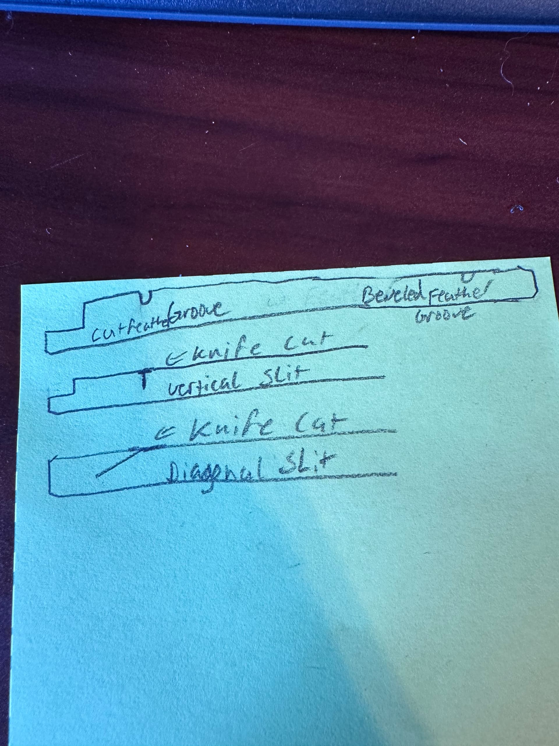

Groove would be the groove and rectangular feather.
Or in the case as demonstrated by Lisa in the video linked in the wiki, a groove made by a stitch groover and simply beveling the feather edge.
The slit method vertical 1.) or diagonal 2.)would
1.) Feather formed as desired, on the inside edge of the hold fast a simple vertical incision straight down.
2.) Feather normally formed with a beveled edge and no other treatment, on the inside edge of the holdfast a diagonal slit made with knife of choice going from where the vertical cut would be diagonally down and out towards the feather edge. < similar to the feather formed by whites hand crank machine. (That appears to be a moccasin awl they are using in that video as well)

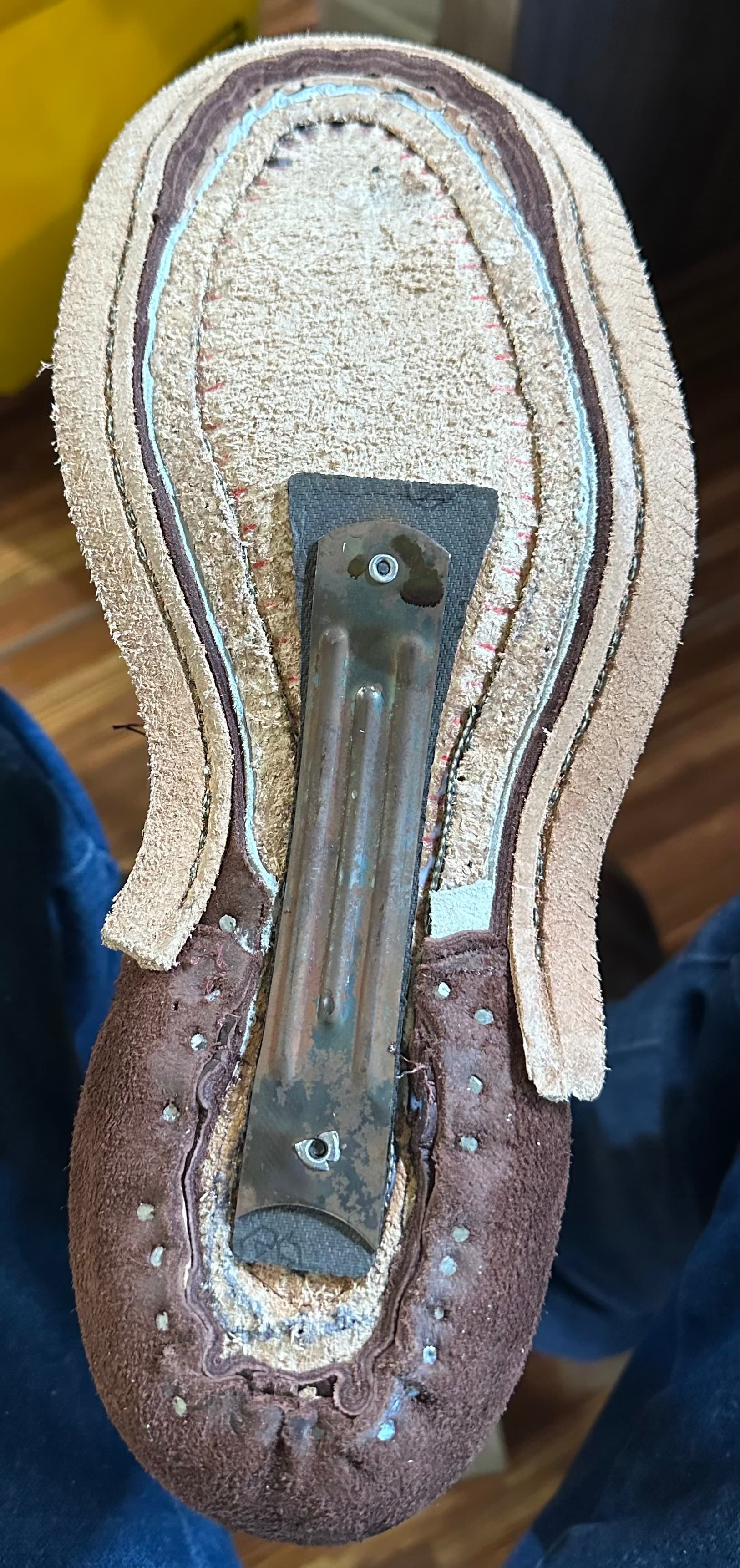

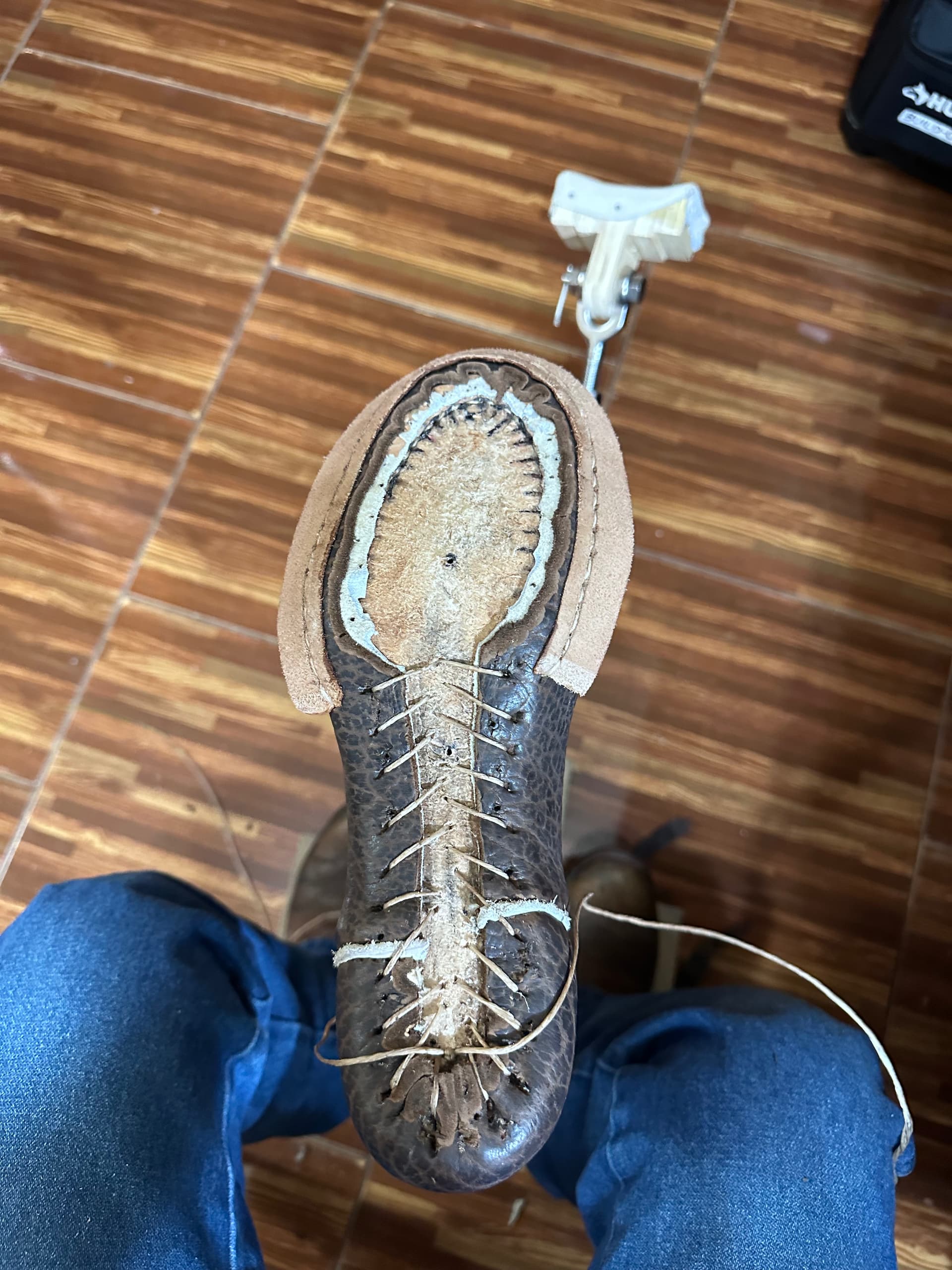

Below are three of my insoles, the two without metal shank were hand cut completely freehand with my 2.5” knife. The steel shank, the vertical feather cut and both cuts of the trench for the inside of the hold fast were the same method but the horizontal of the feather was done was done w the feather knife.

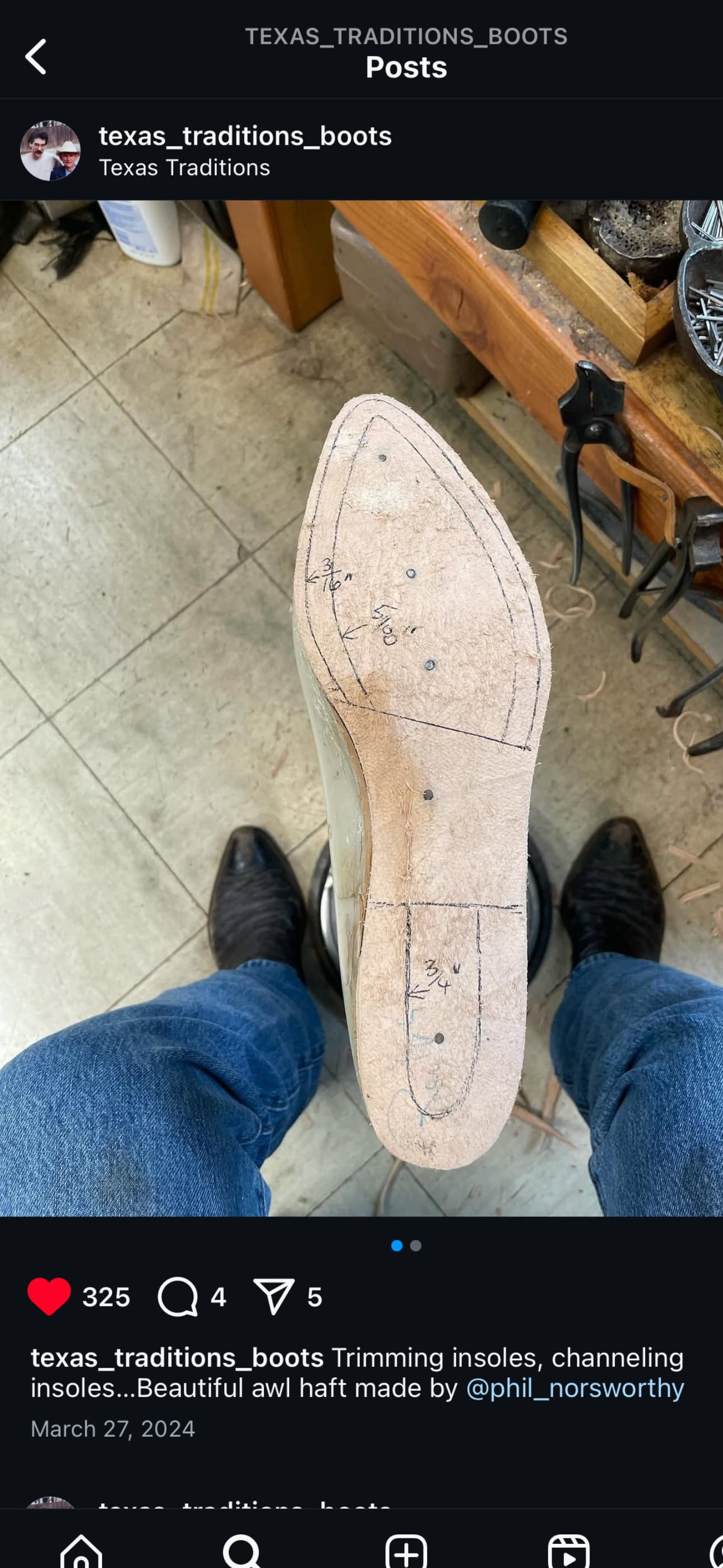

Reposting this image from Lee’s IG all measurements are taken from the un-channeled feather of the insole.
I have not been able to get my awls to successfully sew a heel seat so as of this time they have all been nailed.
I have tried with the 3/4 inch channel in the heel but I think my current awls are just too long.
He mentioned 3-1/8” king awls are what he uses.

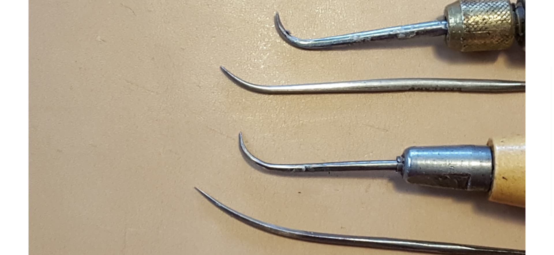

I know DWF used a much sharper bent and shortened customized awl for sewing seats.below is a picture from crispin colloquy, of Mr. Frommers modified seat sewing awls. I am posting the photo as well as the link since many people are not able to get a log in over there and subsequently can’t view the photos.
Thanks! I remember reading about that on the forum, but it must have been before I had an account and could see the photos.
I don’t think I’ve seen another shoe awl that curved.
He reforged those himself. However the extreme curve awl from Lisa Sorrell by mowbray is quite curved but would have to be ground back. I do not know that it is as sharply curved.

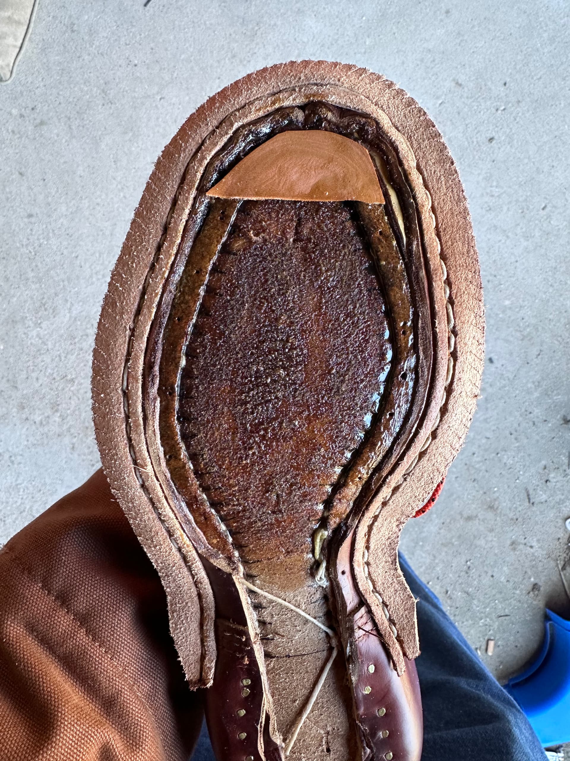

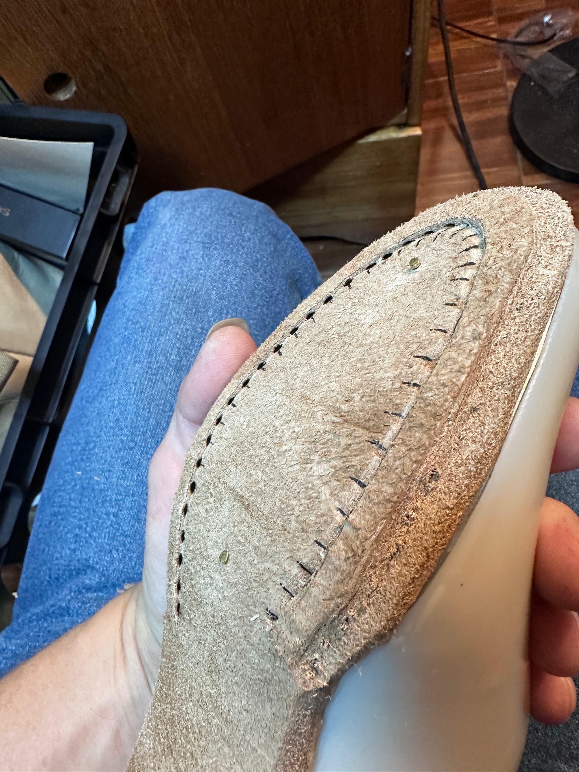

So this is not pretty, but is very functional.
I was finally able to complete a sewn seat.
When I went to talk to my old boot maker a few weeks ago I asked him about sewing seats and shanks.
In the course of the conversation he advised not so go too dense on stitch count in these areas because they would subsequently be held with pegs after being set by the stitches. I can attest to his methods wear by the fact that I have 6 pair from him, my father has 4 and none of them have come apart in any of these areas with very heavy usage borderline abuse in 2 pair for each of us. Cowboying isn’t easy on any of the tools involved.
On this pair I used the above measurements except in the heel seat. I also didn’t cut an inner channel, I only grooved it out with a stitch grooved deep enough for the thread to sit just below flush. Before whipping in I set the shank in place to ensure I would have clearance to not have it rub on any of my stitches after trimming the excess.
