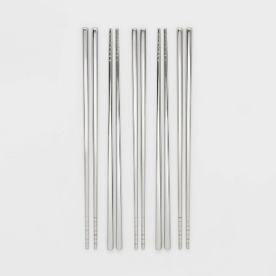

My new favorite lasting tool is a pair of round stainless steel chopsticks from my local Asian restaurant supply store. Here’s a similar set for sale by Target of all places:
I’ve enjoyed eating with these for years—mostly because they’re really simple to clean—but only recently caught on to how useful they are when pleating toes and heels during lasting. In particular:
  • Since they taper toward the tips, they’re great for sliding into small pleats between tacks. This widens out the pleat from the inside, making it easier to flatten it down and divide with a tack through the middle.
  • If you pull the chopstick out of a pleat, you can then use it as a pressing tool to divide and flatten the pleat down from the outside. Again, the tapered shape works well, flattening out more at the featherline than inward toward the middle of the heel or toe. I find it easier to do accurately than with the peen of a hammer, which is straight and stuck at the end of a big handle.
  • Every once in a while I find myself thinking I should grab and snug the lining separately. A metal chopstick works nice as a blunt-nosed pick to separate the layers far enough to grasp just the lining with a pair of narrow lasting pliers.

The metal chopsticks I’ve seen do have very faint serrations near the tips, but my post here was just about my experience using one metal chopstick alone as a poker or laying tool—basically a pointy but not too pointy stick. I haven’t tried using chopsticks to actually grip and pull upper leather under the featherline. I don’t suppose I will, because I don’t think that would be very effective.

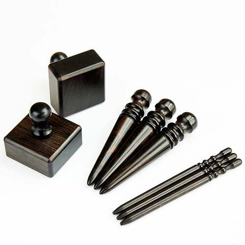

By the by, I recently found another readily available, stick-like tool: “laying tools” for fiber arts, sometimes also called “stilettos”. These are essentially pen-sized sticks of hardwood turned with blunt-pointed ends and round ends.
I got one very inexpensively at LACIS in Berkeley, California. Bu there are similar tools for sale all over the Web. The “slim stick” burnisher from WUTA is my current favorite:
Also good for laying turned edges and other fiddly closing tasks.
