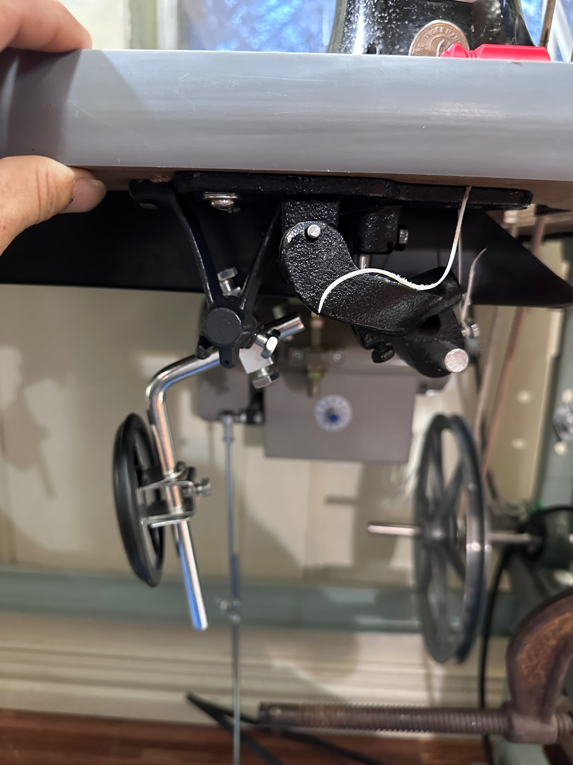

While visiting a friend I was lamenting needing a 31 class machine for stitching boot tops but not having space for another table.
He asked why I didn’t just run it in my current table and swap it back and forth.
Novel concept to me since I like my knee lift.
Well after getting my 31-15 from Toledo industrial sewing machines. I set it in my existing table that my juki 563-Lu sits in and sized everything up. I still have to get a 3L500 belt but I’m running it in a leather belt at the moment.
I got the 31 class knee lift in today and got it installed.
The legs straddle the mount bar for the 563 knee lift and nest perfectly together. All I have to do is swap in whichever knee bar I want for whichever machine tighten the bolt, lift the belt to the machine. And it’s off to the races. I even placed a hook to hold whichever belt I’m not using at the moment to keep it away from slinging shafts and pulleys.
