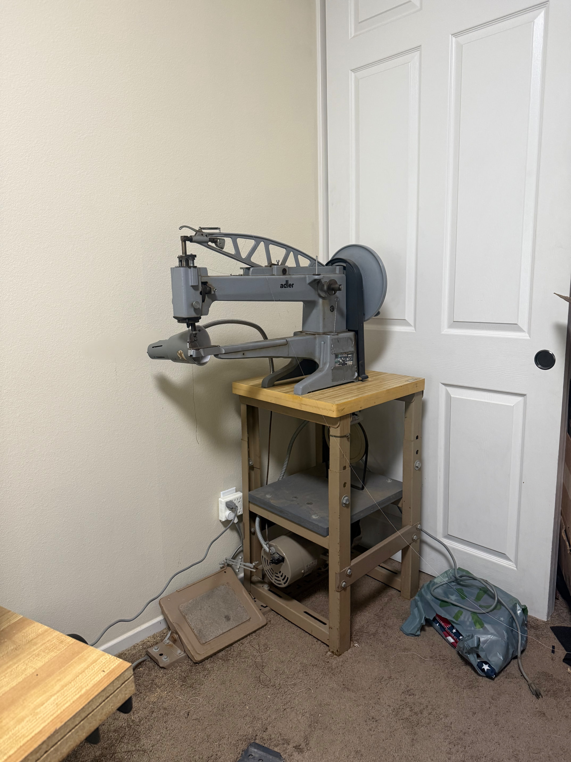

Hey pals, I’m having a kind of maddening problem I was hoping yall would have insight into. So, I love my Sailrite Ultrafeed LSZ and it’s a dream on leather as well as denim and canvas and the other stuff i sew. But obviously I need a post bed or pole arm machine to close a boot. So far, I had been using Deborah’s post bed roller feed machine from I think Leather Machine Company? But fellow classmate and sewing machine addict Ray got one of these little shoe patcher machines from Bantam and sewed a lot of great stuff on it before giving it to me. When I sewed with the bobbins he had wound when he gave it to me, it was so great! Just like everyone on youtube says! But then it came time to wind the bobbins.
I just couldn’t get the tension right and consistent and the distribution up and down the bobbin consistent. So I need a solution to wind them automatically or to buy the right pre-wound size.

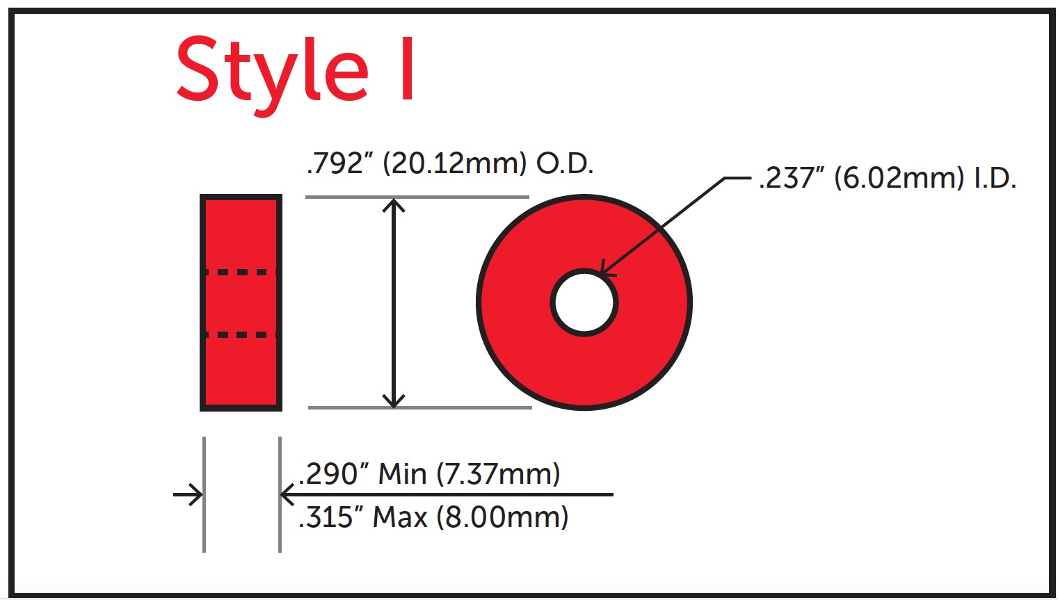

These little bobbins are some irregular size - Bantam claims they know of no standard they fit, an old post I found says maybe style I. Can’t find any pre-wound style I bobbins at Thread Exchange to experiment with, but this one place will let me buy…a gross. My own measurements were about 17mm diameter and 6mm tall, I guess I should see if the case could fit a style I.

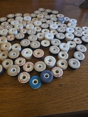

Here’s a post on ebay for a lot of 100 prewound bobbins. Looking at the pics there are some style I bobbins in the mix. I don’t know anything else about the ebay post.

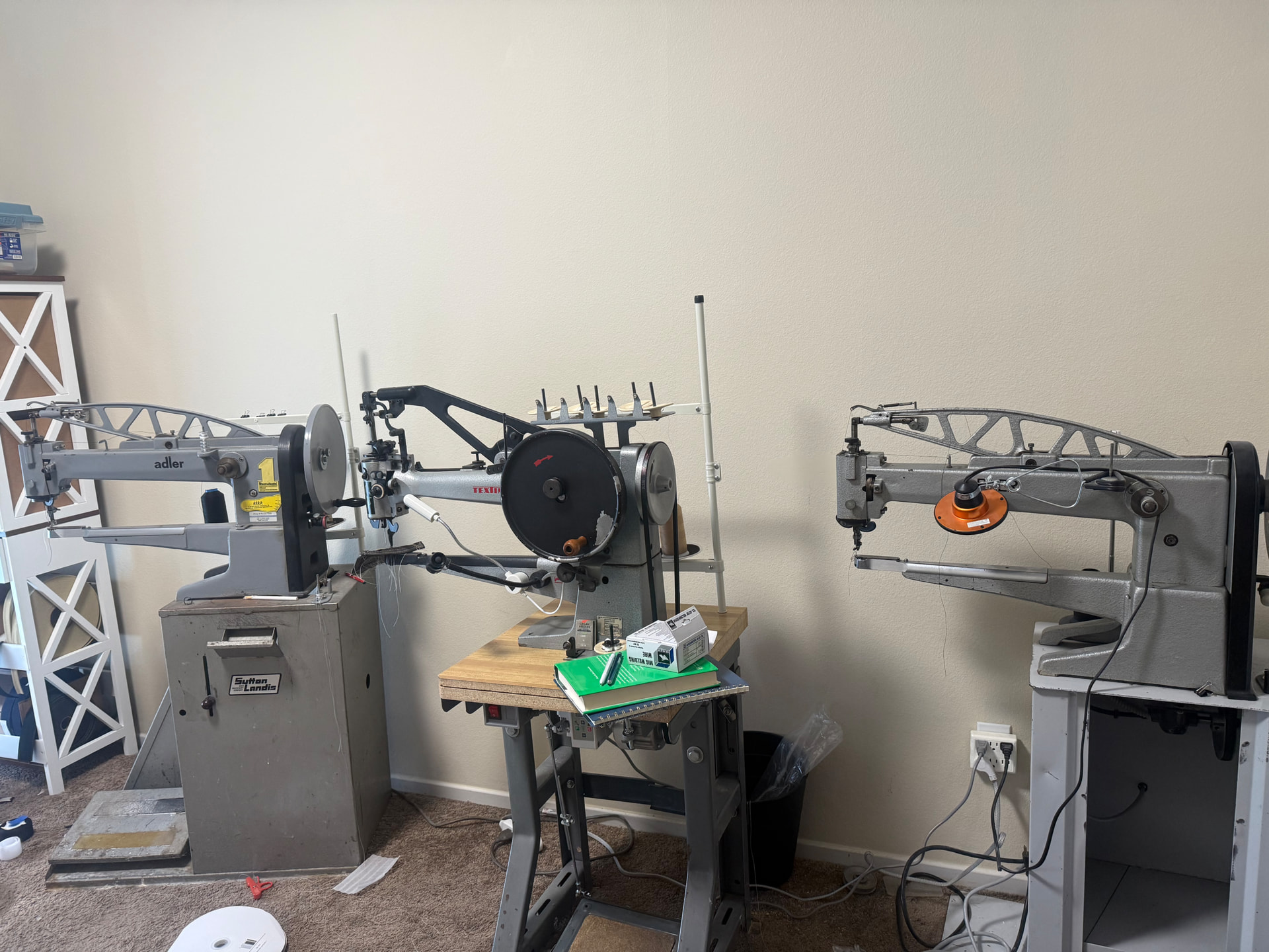

I would recommend looking at the Adler and singer patchers and taking note from those style winders, you can wind 10 bobbins in 10 minutes once you get good, If you switch between bobbin thread colors and weights, you’ll have to keep quite a bit. These are the patchers I’ve acquired and am using or setting up to use.
