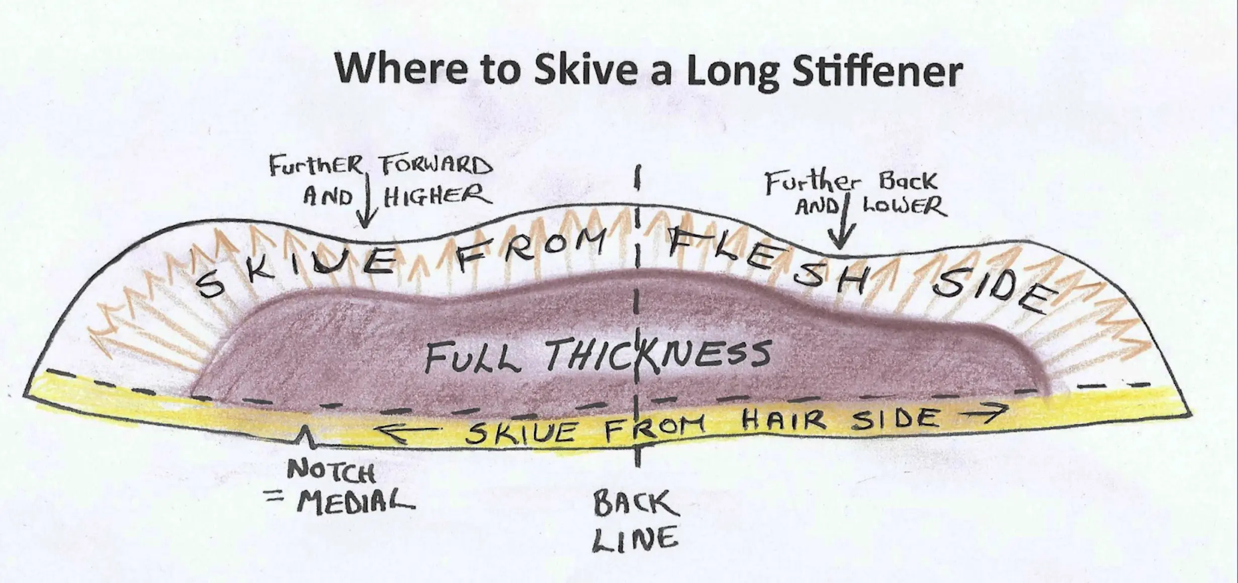

Bill Bird’s excellent video series on heel counter patterns—my notes here—ends with a really interesting tip: Skive the top edge of the counter from the flesh side, but the bottom edge of the counter, below the featherline, from hair side.
He actually gives a really excellent diagram:
What I haven’t been able to figure out, either from Bill’s videos or on my own, is why it might be better to skive on both sides of the leather like that.

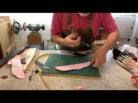

Perhaps a hint in a different video:
And I skive the other side [of a side lining], skive the hair side. This is to give a good gluing surface.
I don’t think he skives the hair sides of the toe puffs or heel counters earlier in the same video series.
