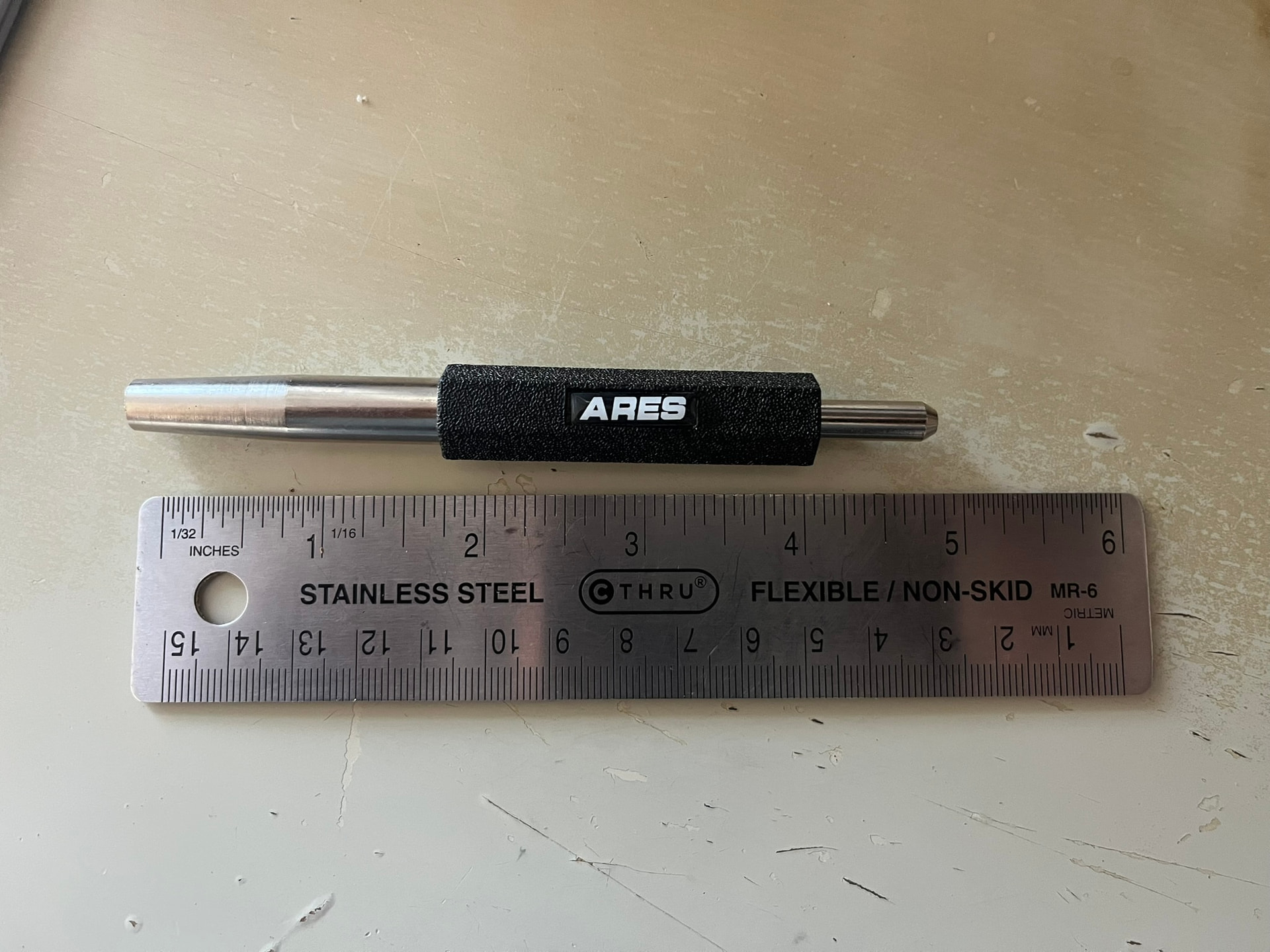

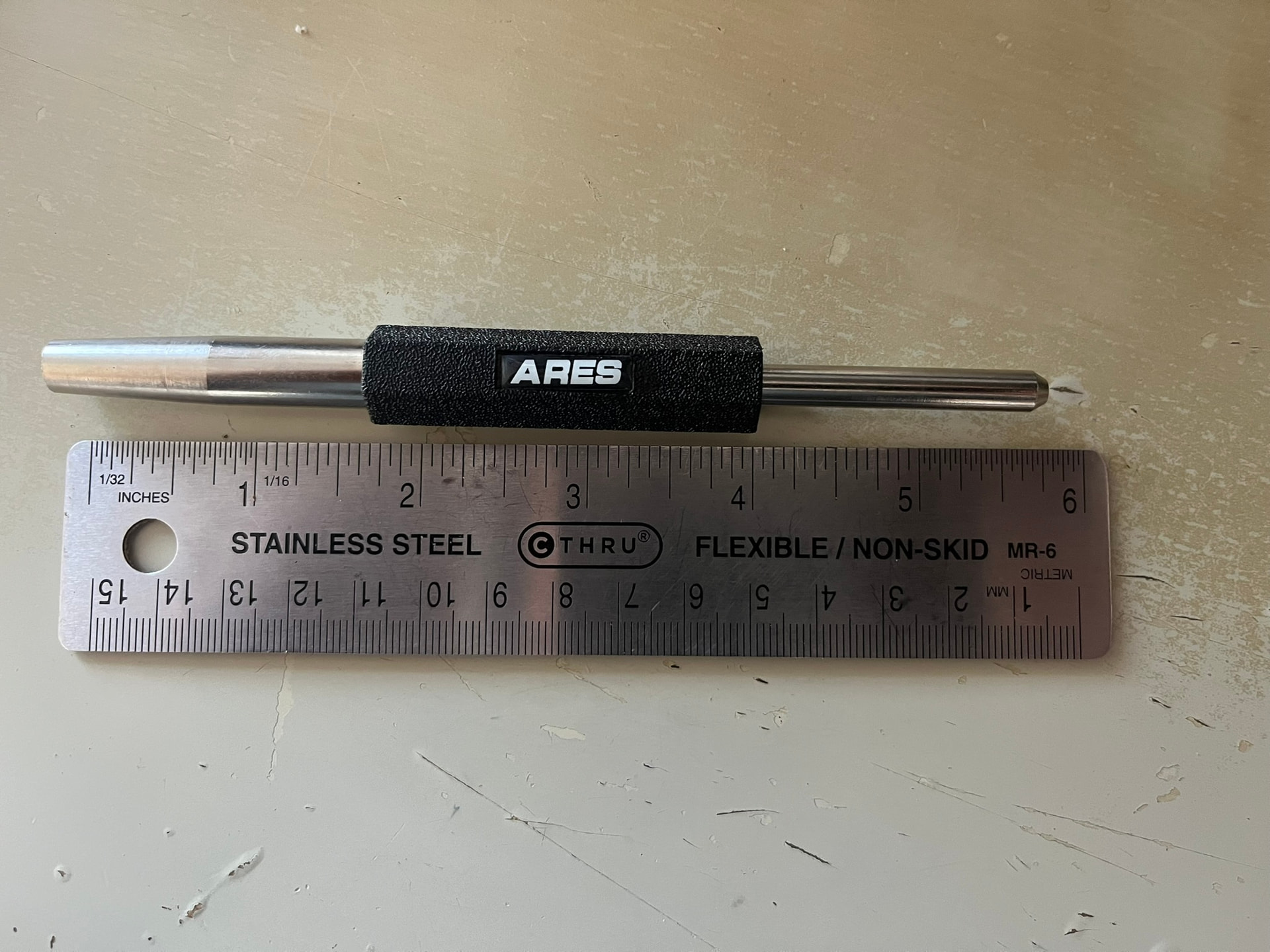

Here is a punch I found that’s marketed for setting trim nails in carpentry, going for less than $10 USD:
The inner diameter of the tube is about 5.5 mm. The travel of the punch is about 25 mm or 1 inch. So it’s a bit wider than common wood pegs sizes, but with enough travel to drive them completely. There’s very little side-to-side play of the punch within the tube.
I’m concerned the mouth of the punch might mark leather as I drive. But I wonder whether I can’t smooth any marks out with a concave faced hammer or burnishing.
Using one of these would obviously be slower than driving pegs freehand, if you’re perfectly accurate with the hammer. But it’s a handy little tool.
I’ll share notes once I’ve had a chance to give it a try. I have a pair coming up to heeling pretty soon.
For notes here, the punch I bought to try is an Ares model 10115 “6-Inch Trim Nail Punch”.
