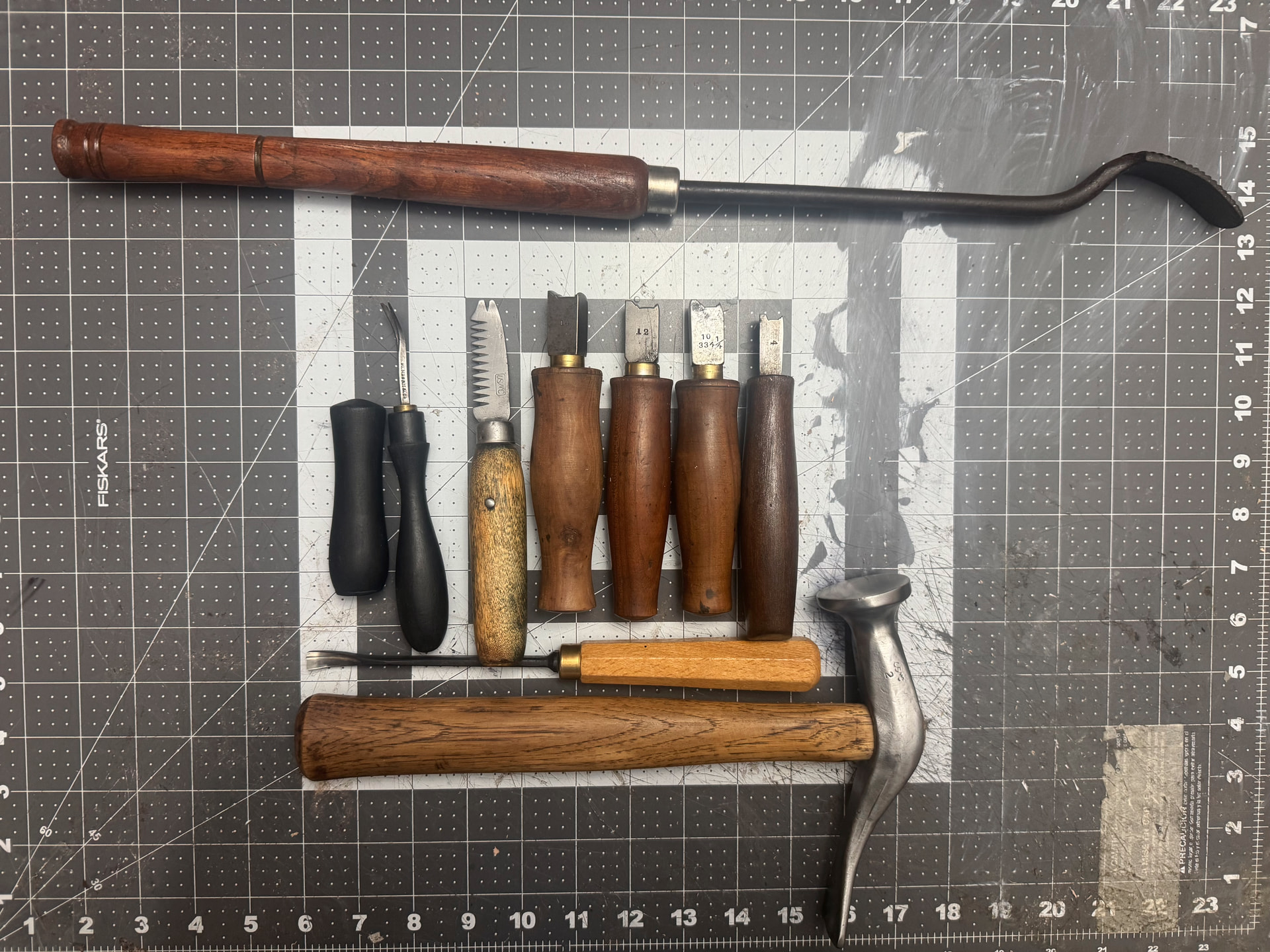

I recently purchased a few vintage shoe making tools and I figured I’d share them here. The tack puller and the hammer are from Bruce Johnson. I only came across him recently and he has some really great stuff, but the shoe tools tend to sell fast. On the hammer is written “ USMC 2” and “40”. My guess is it was made in 1940. The hammer appears in the USMC tool book but I couldn’t find when the book was published.
The rest of the tools were from various auctions on eBay. It seems like months go where nothing interesting appears until someone drops a bunch of stuff they get from an estate. I think I am most excited for the inner rasp and the leather trimmer. I want to make cowboy boots at some point and the rasp should make it much easier. The only place I’ve seen one is from shoemakercraft. I am concerned that the teeth are pretty smooth. If anyone has any experience with using it I’d appreciate any tips.

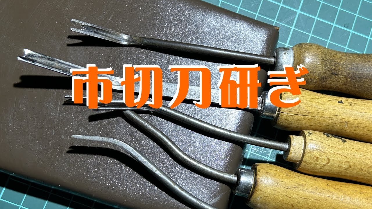

The Japanese shoemakers are my biggest inspiration. In most their videos you can see them use something that looks like a french edger to remove excess lining leather. After some searching I found Mamoru, one of the main shoe making stores in japan. They have almost anything a shoemaker could ever need, at very reasonable prices. I found a lot of tools that the Japanese shoemakers use, including the trimmer. You can see that unlike a french edger there is also groove in the bottom of the blade. The trimmer I purchased has the same shape and grooves so I think it serves the same purpose. Unfortunately, it is completely dull. Mamoru says to use a triangular whetstone to sharpen so I will that a go. If anyone has seen a video or more in depth description I’d appreciate the resource.
The last tool was labeled as a “welt plough” on the eBay listing. It has a completely different look from the other welt ploughs/knifes I’ve seen. Its basically a “V” that follows a spoonish curve. I’m not sure if this is just mislabeled or if it is actually used for shoe making. It is also completely dull. I can sharpen the outside but I couldn’t find a way to remove the burr. I will also try it out with a triangular whetstone.

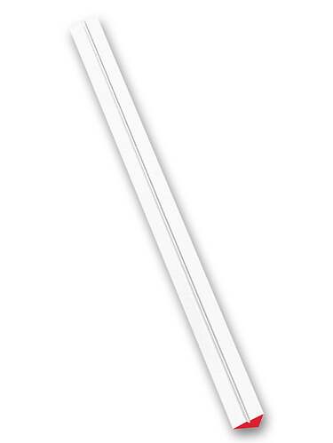

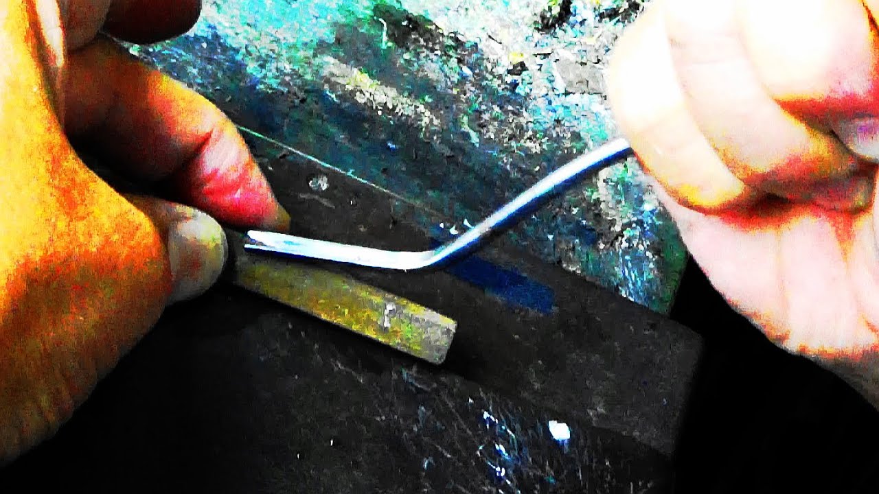

You asked about sharpening the gooseneck trimmer. It seems the product page you linked to has a related-product link to a triangular sharpening rod, dimensions 100 by 13 millimeters:

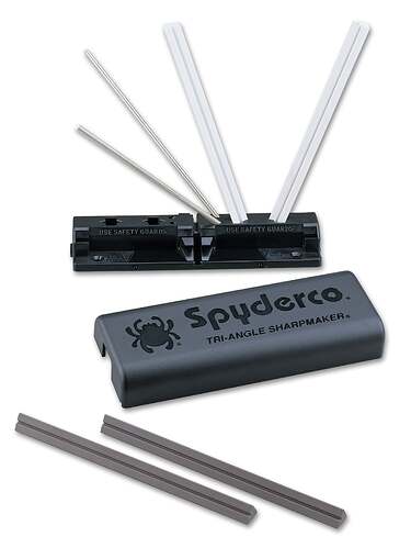

The shape reminded me of the honing rods in the old Spyderco Sharpmaker sharpening kit that I’ve head for years. I just pulled it out, and those rods are indeed about 13 mm across the three faces:
I believe they also sell replacement rods:
There may also be cheaper alternatives without the grooves, and perhaps with sharper corners.
Of course, I don’t see why a fine-tooth triangular file wouldn’t work, as well. Cheap versions are sold at my local hardware outlet:
For really cheap, you might just rub abrasive compound on a chopstick or a thin stick of hobby wood, like balsa or basswood.

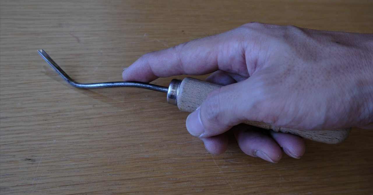

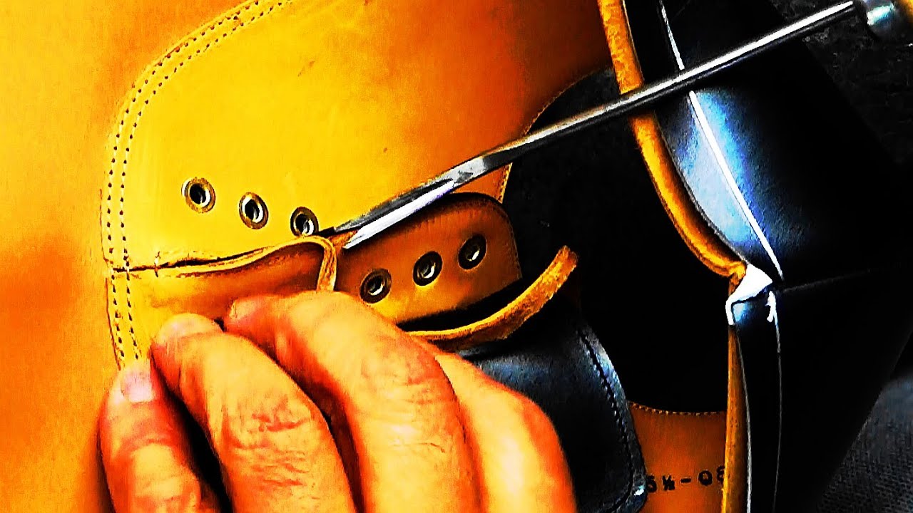

For what it’s worth, I have definitely ogled those gooseneck trimmers watching videos online. But I’ve never had much trouble trimming linings with the kind of edge beveler you can get from Tandy or any number of other places online.
I made some purpose-built strops for mine out of thin strips of sole leather glued to popsicle sticks. Anything to get abrasive compound rubbing on the width of the cutting edge.

There have been a few times while trimming lining that it would be nice to have my hand coming in at the steeper angle the gooseneck would allow. Don’t think it’s a must have, but would be nice to give a try.
