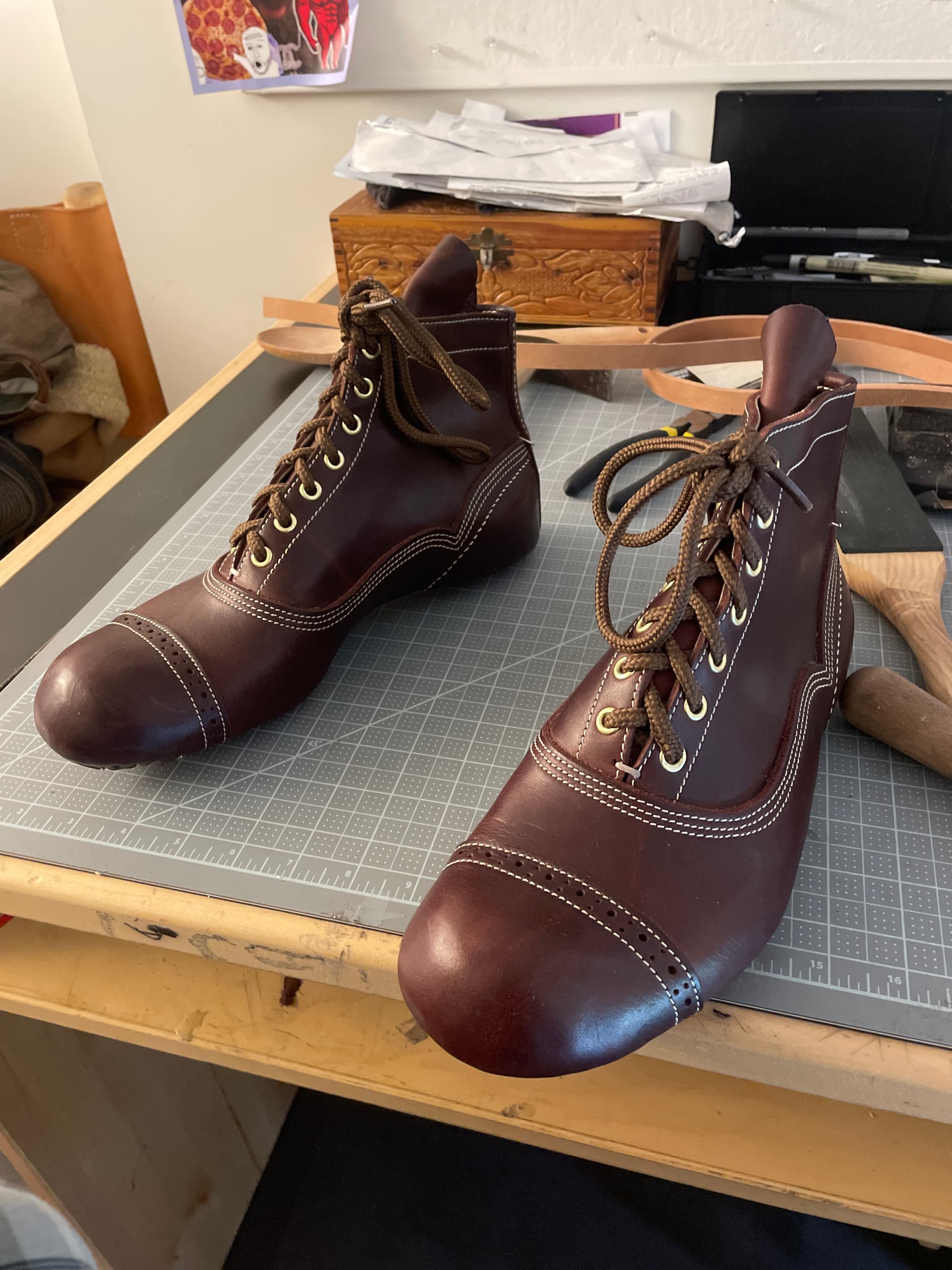

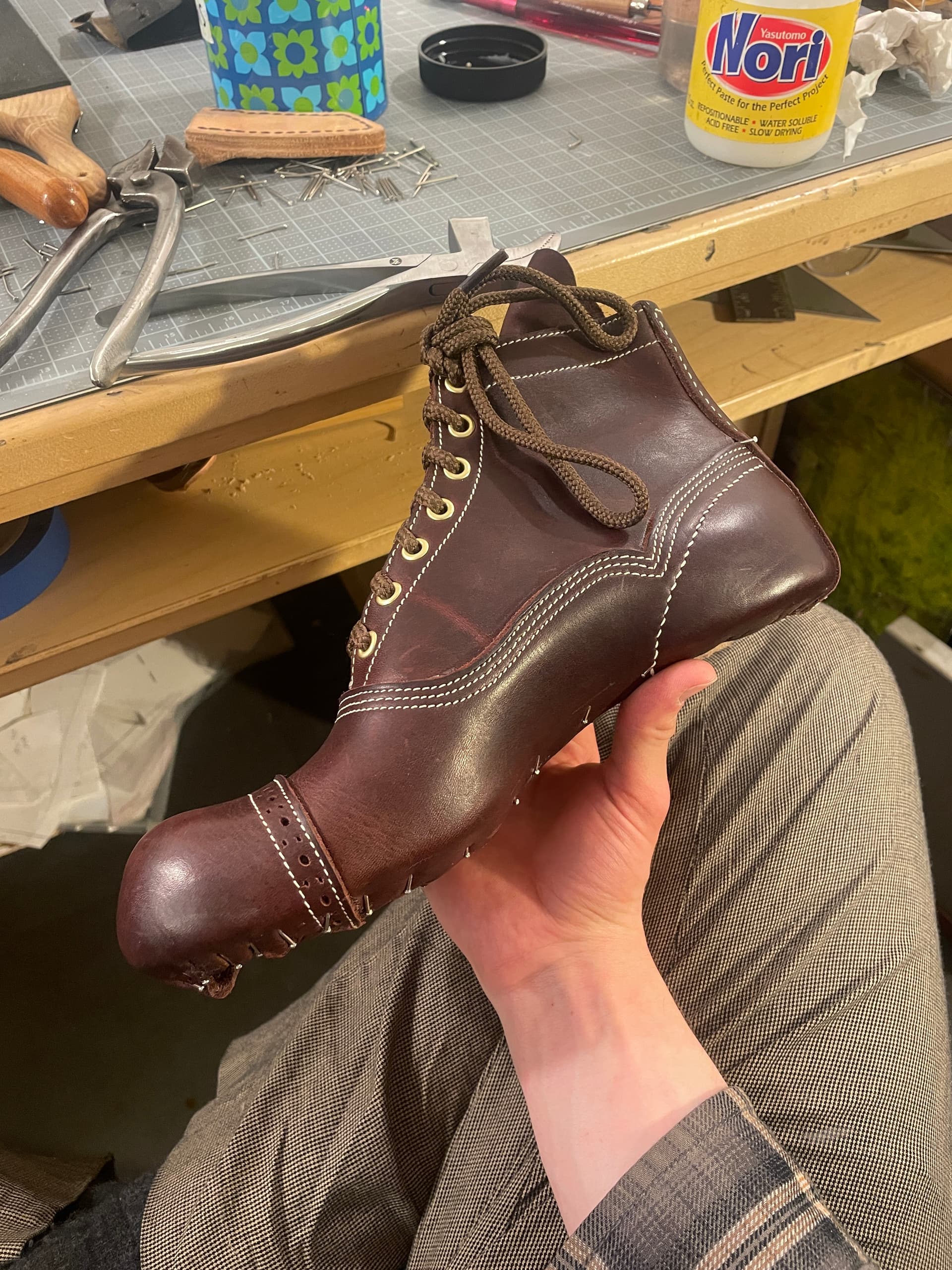

heres what my current project looks like for anyone interested. Kinda unrelated but ill be welting it today. they are inspired by work boots from the 1910s

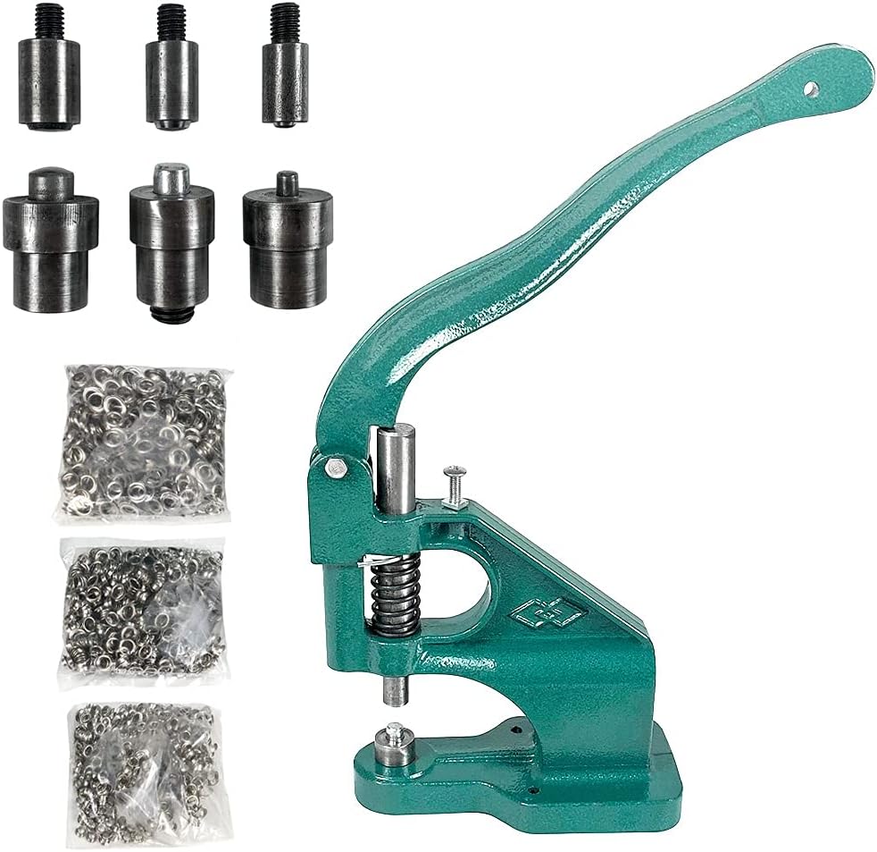

Meanwhile, here’s a whole press on Amazon Prime for $45, which I strongly suspect is M6/12mm:
You would want to confirm the interface before ordering.
I told myself not to look into this, but I couldn’t help it. I suspect that particular QWORK press takes M8/19mm shaft. I’m reorganizing my wiki notes to make it easier to list presses with the various tooling interfaces.
