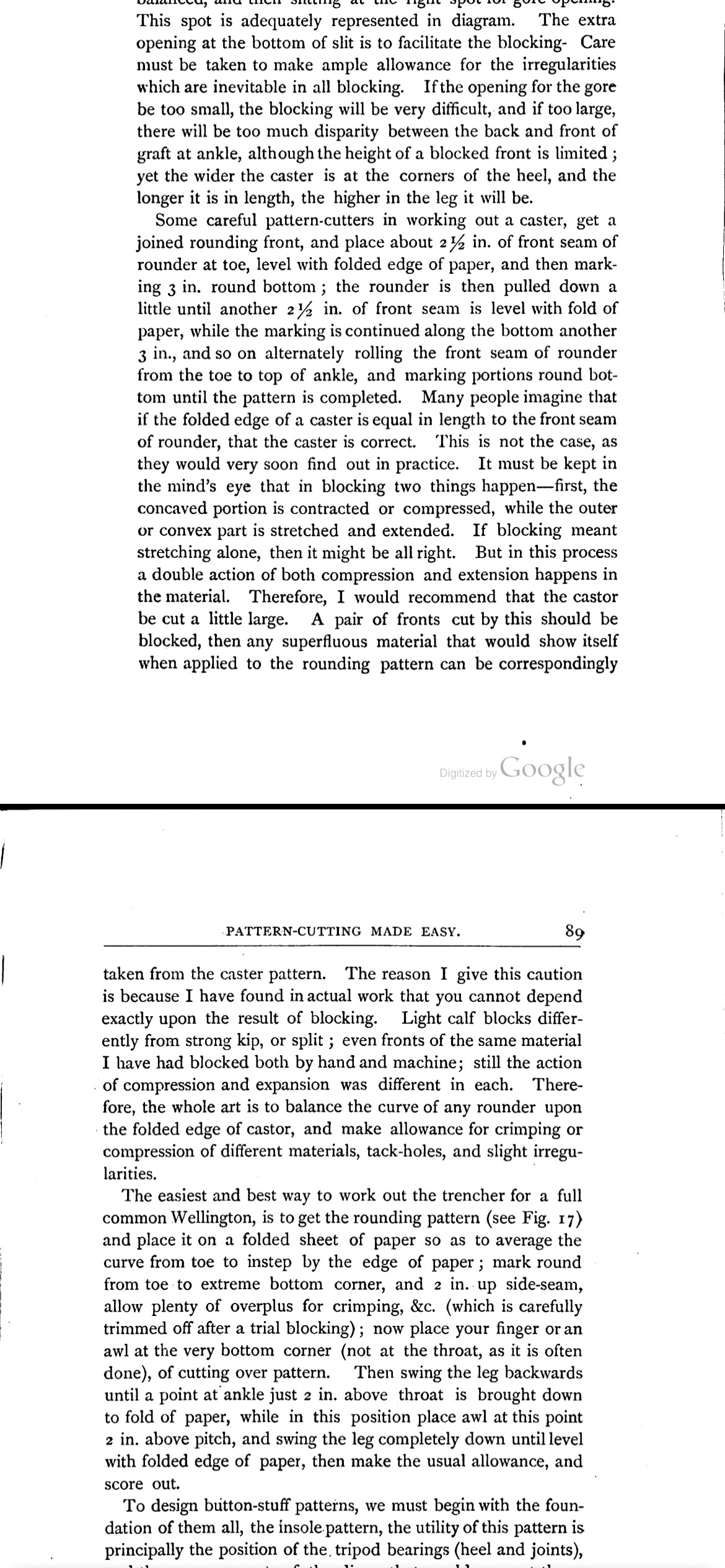

These seems like a relevant passage from Brophy especially around the page break. Using castor instead of blocker.

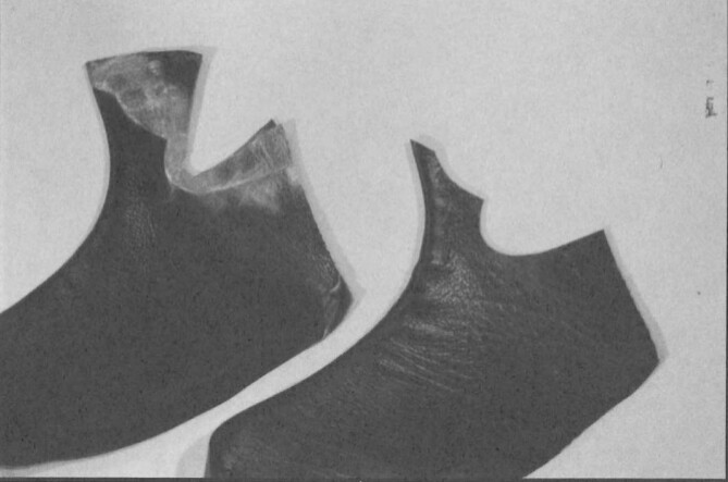

I think the other way around, a blocker or castor is a full but flattened pattern, it’s cut out and blocked/crimped, then in its new folded form a half pattern “rounder” is used to trim it down to final shape. Brophy talks about making the castor oversized because the crimping/blocking process unpredictably warps the castor/blocker so the rounder (Frank Jones calls this a “half vamp pattern”) is then laid over it to mark and cut the precise outline.
