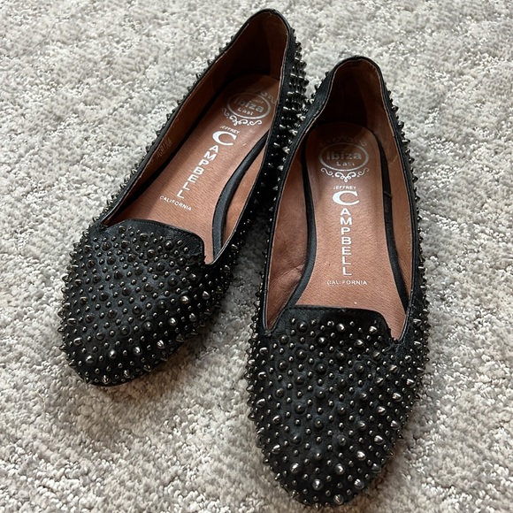

In my relentless pursuit of Fashion, I have gotten it into my head that it would be cool to make a version of a pair of Jeffrey Campbell smoking loafers that I have loved in stingray leather.
The rounded metal studs reimagined as stingray dentin pearls, and the fact that this hide can be used to grate wasabi, just speaks to me. And I’ve got the pattern already made for the lasts I have.

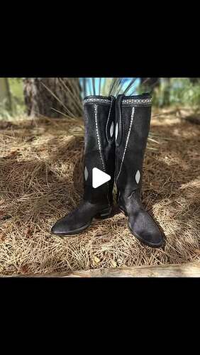

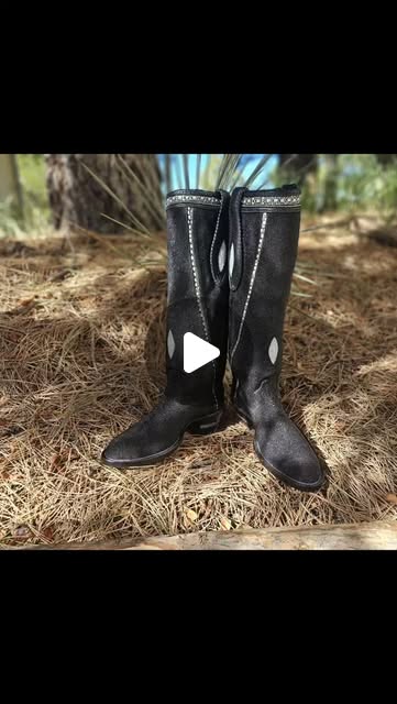

You should message Jim Brainard he just made these and I bet he’d offer good advice.
