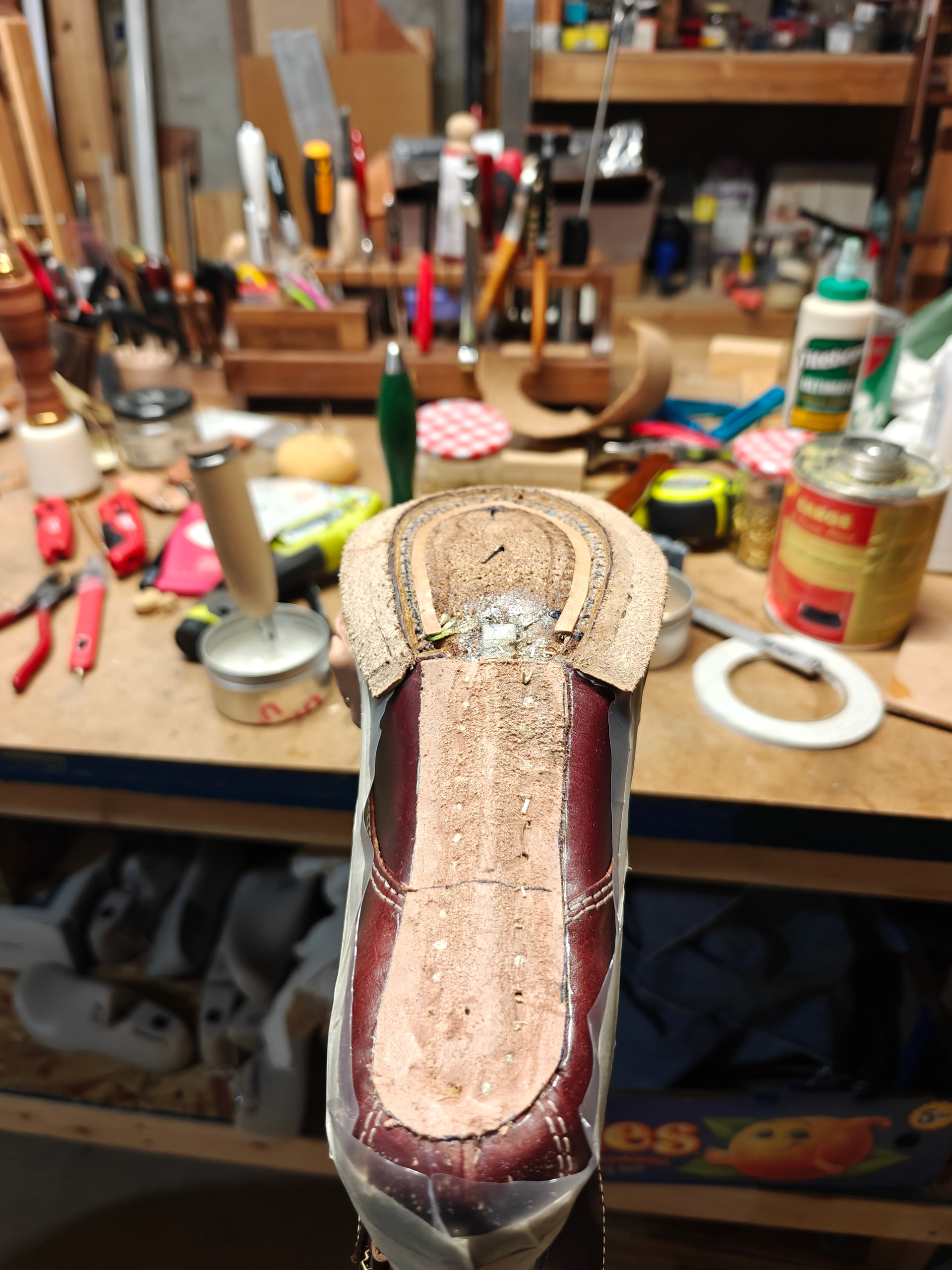

Hmm, okay. That’s food for thought for sure. At least I have not put on any midsoles yet. I can still do a 7500 midsole and just rely on the cement bond to hold it together. It’s not absolutely ideal, but it could work just fine. My worry with a cement-only bond between a leather midsole and the vibram outsole is the edge peeling.
Shanks are wrapped and glue, and shank covers are on. I am going to throw a leather half-midsole over the shank cover, meeting up with the welt. I will peg that midsole, intending to catch the shank cover as well. I am then intending to just do the other half, the welted area, as a 7500 midsole. I have zero desire to futz with hand lock-stitching through ~15mm of leather and vibram rubber. And I trust that rubber/rubber cemented bond better than rubber/leather.
Then the vibram 100 outsole is cemetented on, with the rear part likely intended to be trapped by the heel. I am not sold on that part yet though. Could be more cumbersome than I’d like.
