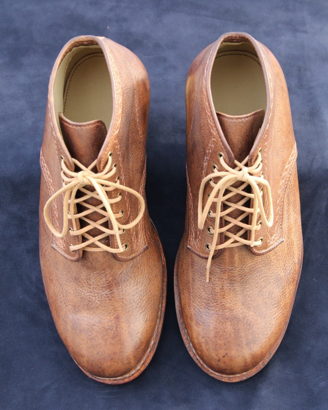

There’s an easter egg in my photos of the last project… the backdrop the boots are sitting on is a hide of CF Stead Repello in midnight. I had that sitting here for the next project.

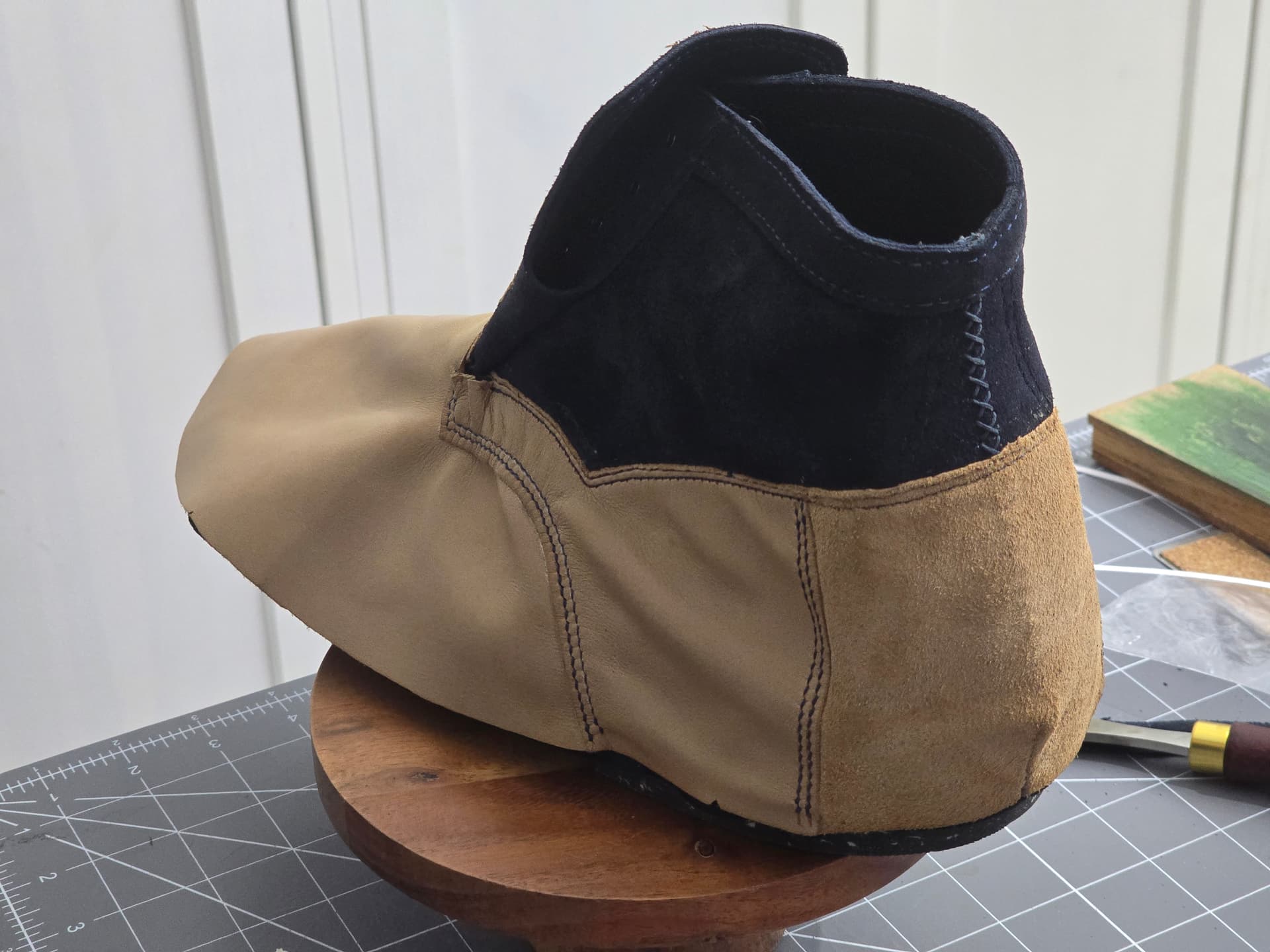

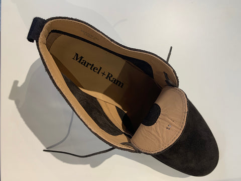

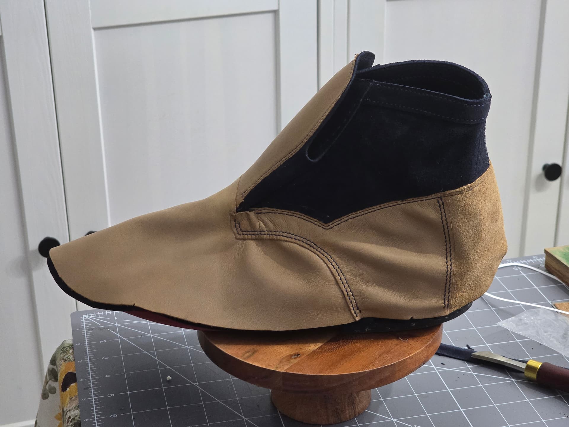

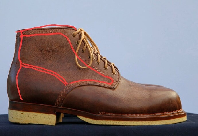

Think of it more as selective lining in places where reinforcement is desired (top line, eyelets, vamp stitching, counter pocket, etc) like so:
It looks like Martel + Ram in particular may have borrowed that term from tailoring:
I have seen it used in other places on shoes too, although struggling to find where now
I added to my wiki, but I’ve only got that one reference.
If i come across another, i will post it up

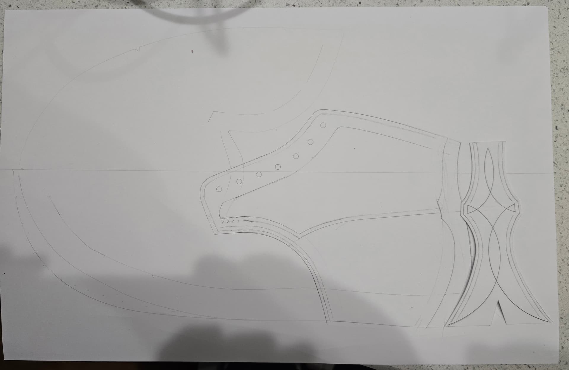

Well, I think I made it about 24 hours before convincing myself to wait to design a new last to do a chukka and instead use the same basic pattern as the last boot. Basically, take the opportunity to further refine the design ideas from the last one before moving on to something new.

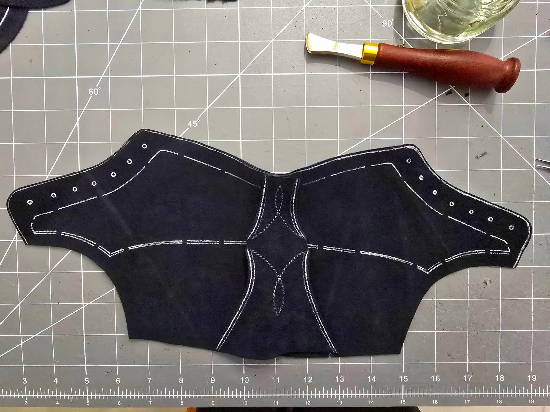

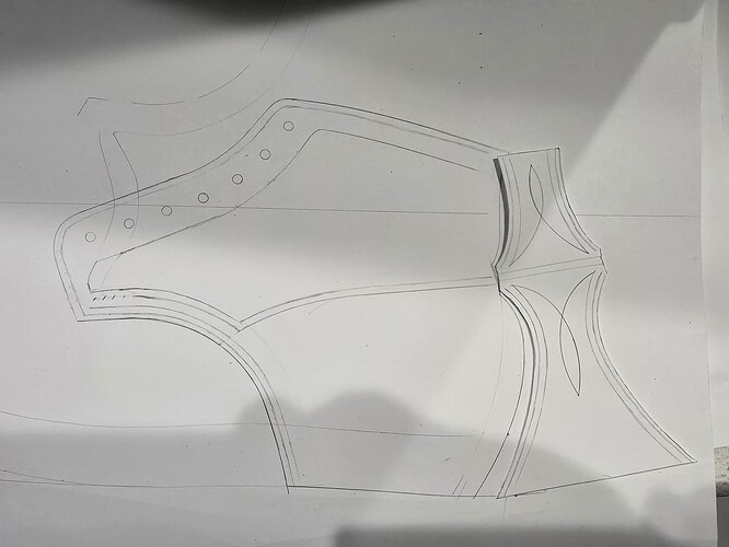

Starting to work out some patterns with some decorative stitching.
Also working on a custom stitching chisel that will do offset double stitch rows to give really clean and even double stitching rows. Hoping to get them on the mill this weekend.
Nice. Reminds me of Allen Edmonds’ Higgins Mill.
I could see that.

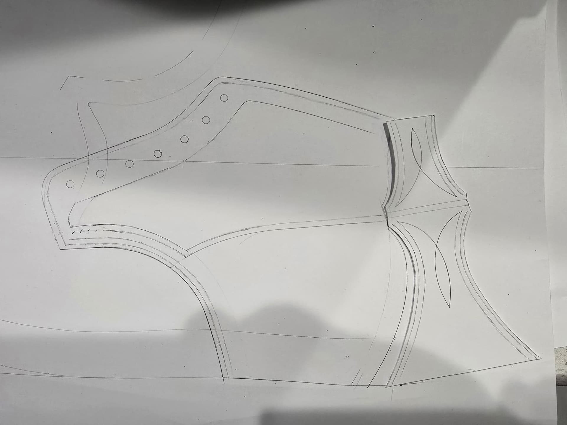

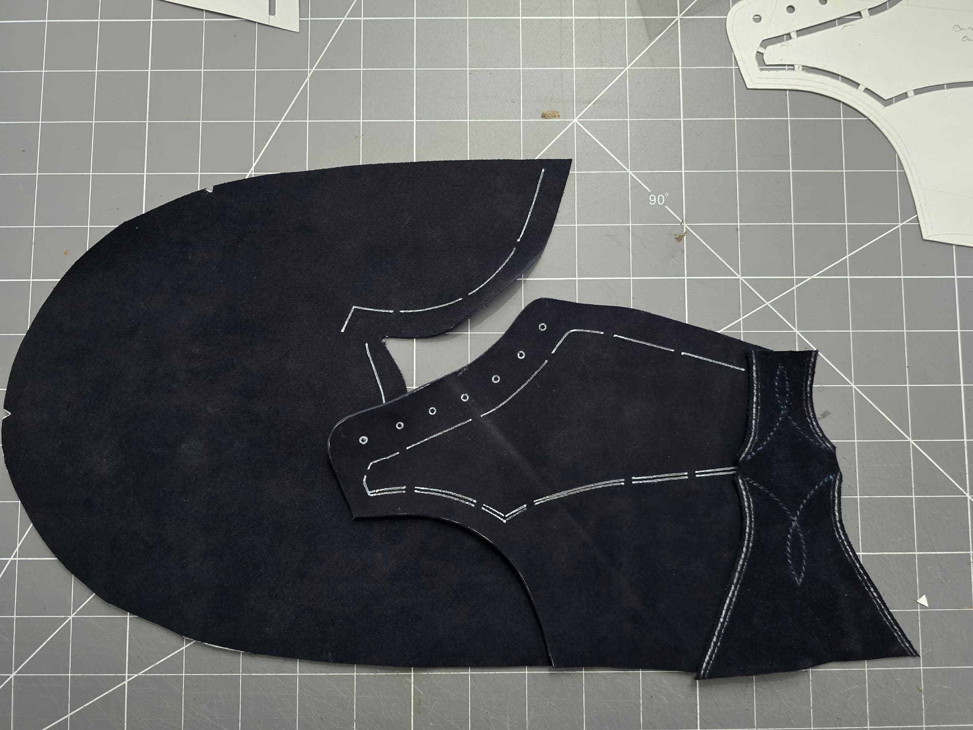

It’s the same basic pattern as my previous boots, but with a backstay instead of a french seam, a little curve added to the topline, the herringbone stitching simplified, and the counter pocket line pulled all the way up to the vamp with it defining that character line rather than it going all the way down go the sole.

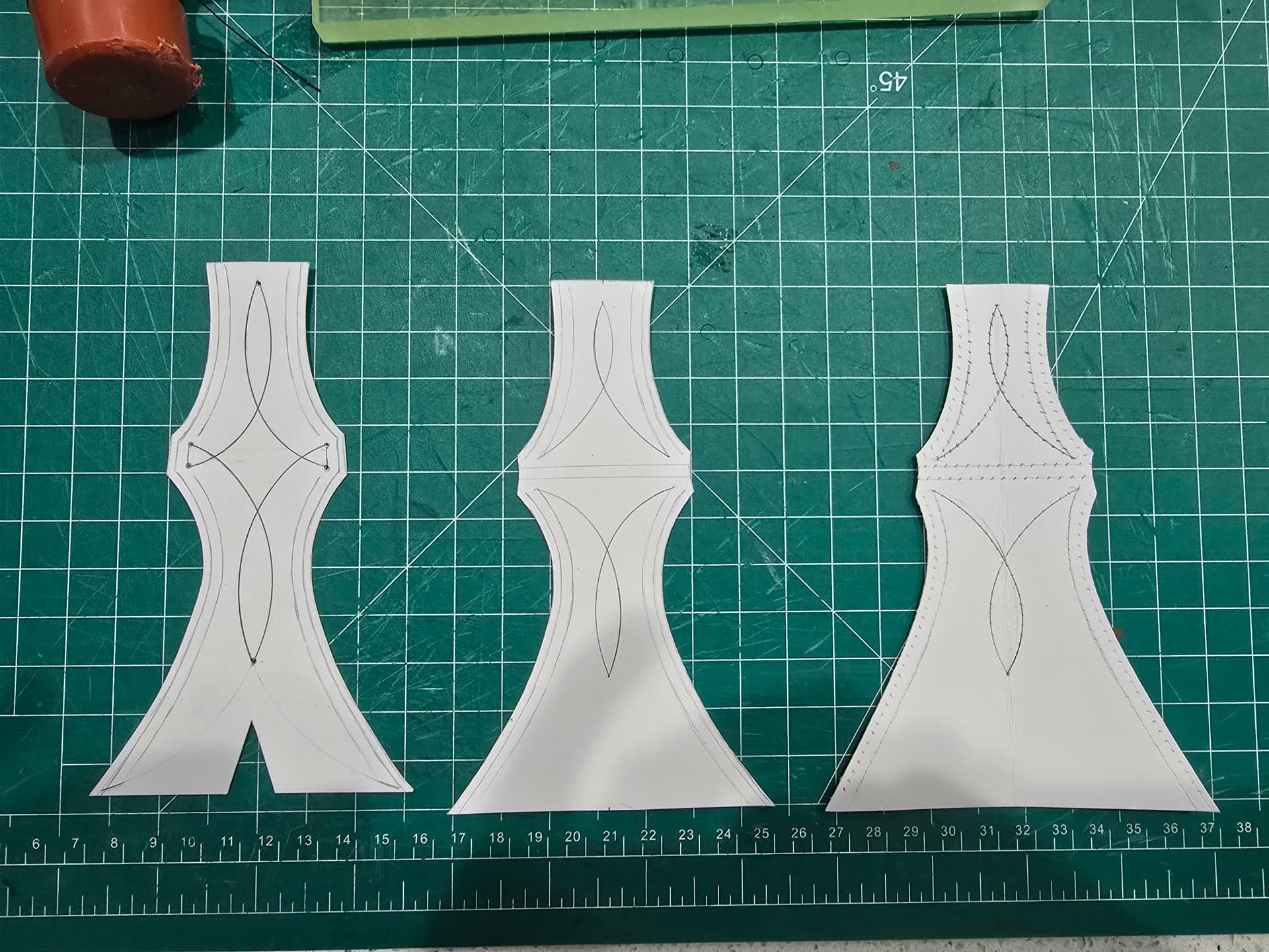

Some iterative improvements to the backstay pattern
This should let the counter pocket line wrap around the back and let me stitch the backstay on before doing the lining (which is retained by that counter pocket line).

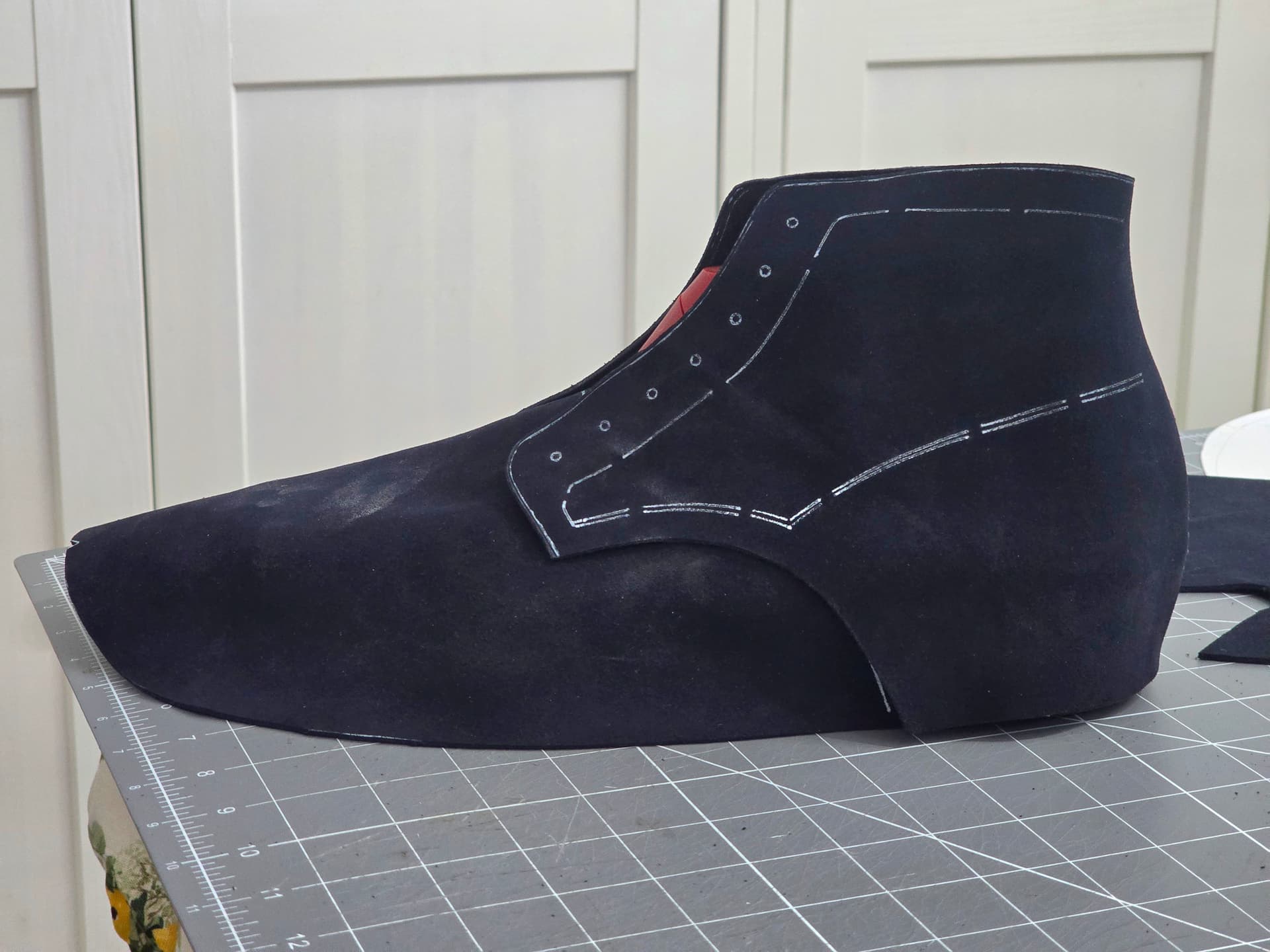

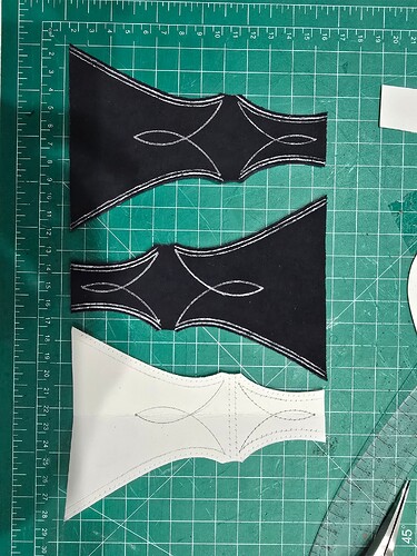

Laying lines out on suede is a huge pain. This heat erasable white pen works ok but takes some effort to mark out the lines nicely.
Patterns done
Started clicking
Suede is a gigantic pain to mark things out on. I am using a white thermal pen for marking things out, which works ok, but often takes multiple light passes with the pen.
One nice thing you can do is run a heated creaser over to give a really crisp line.

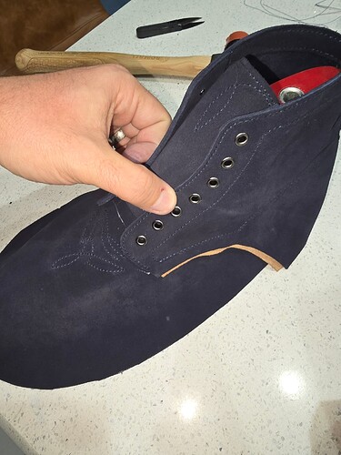

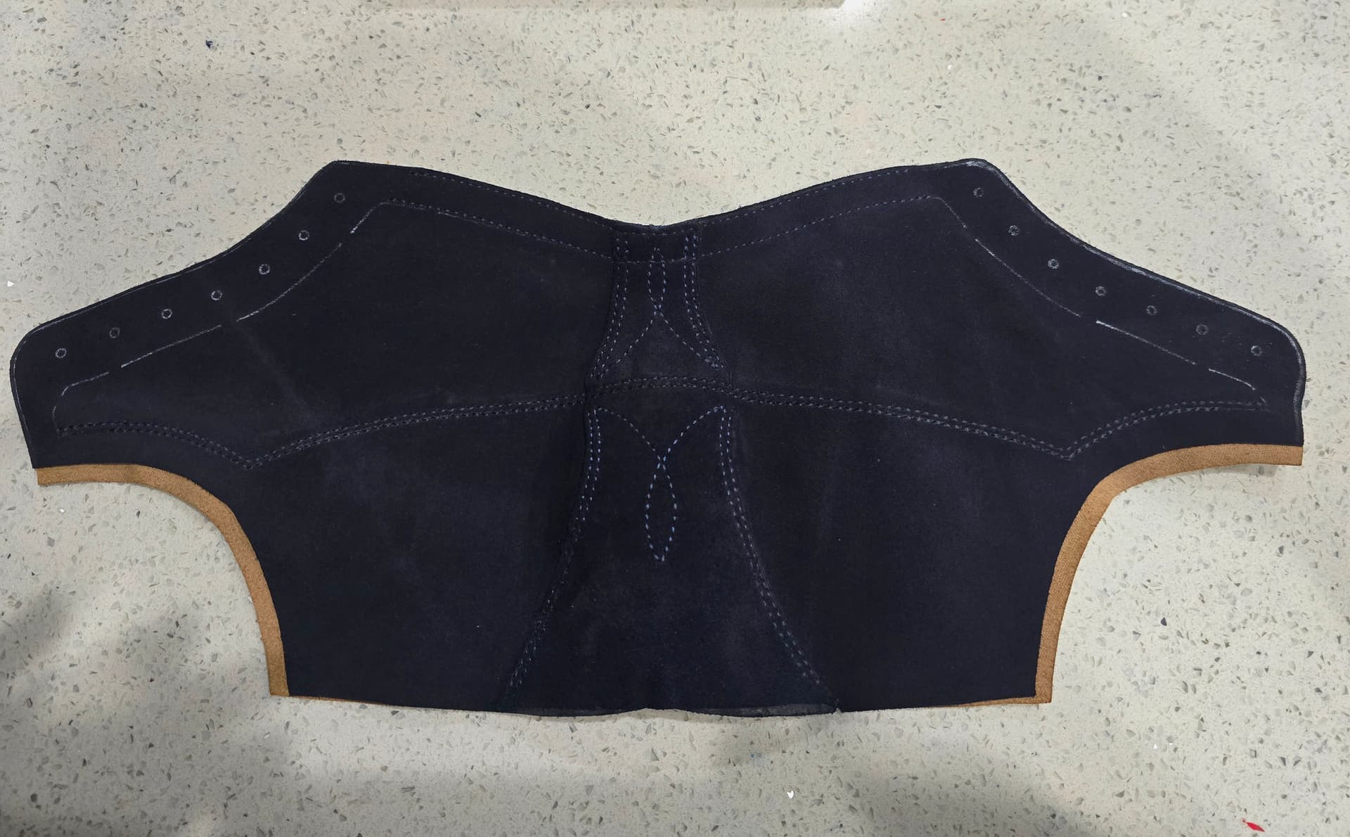

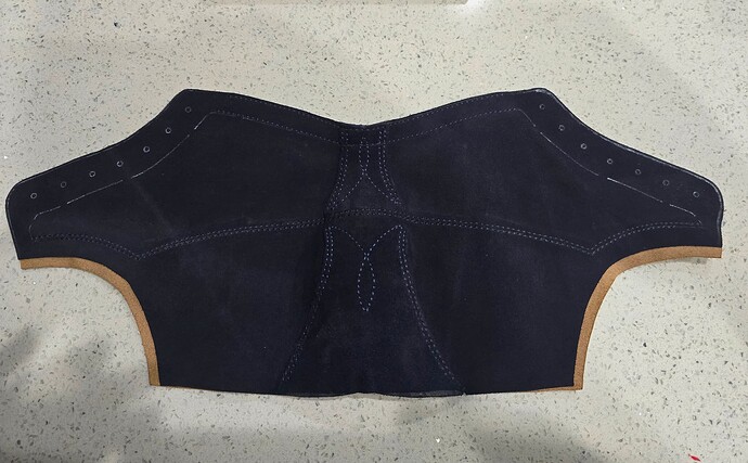

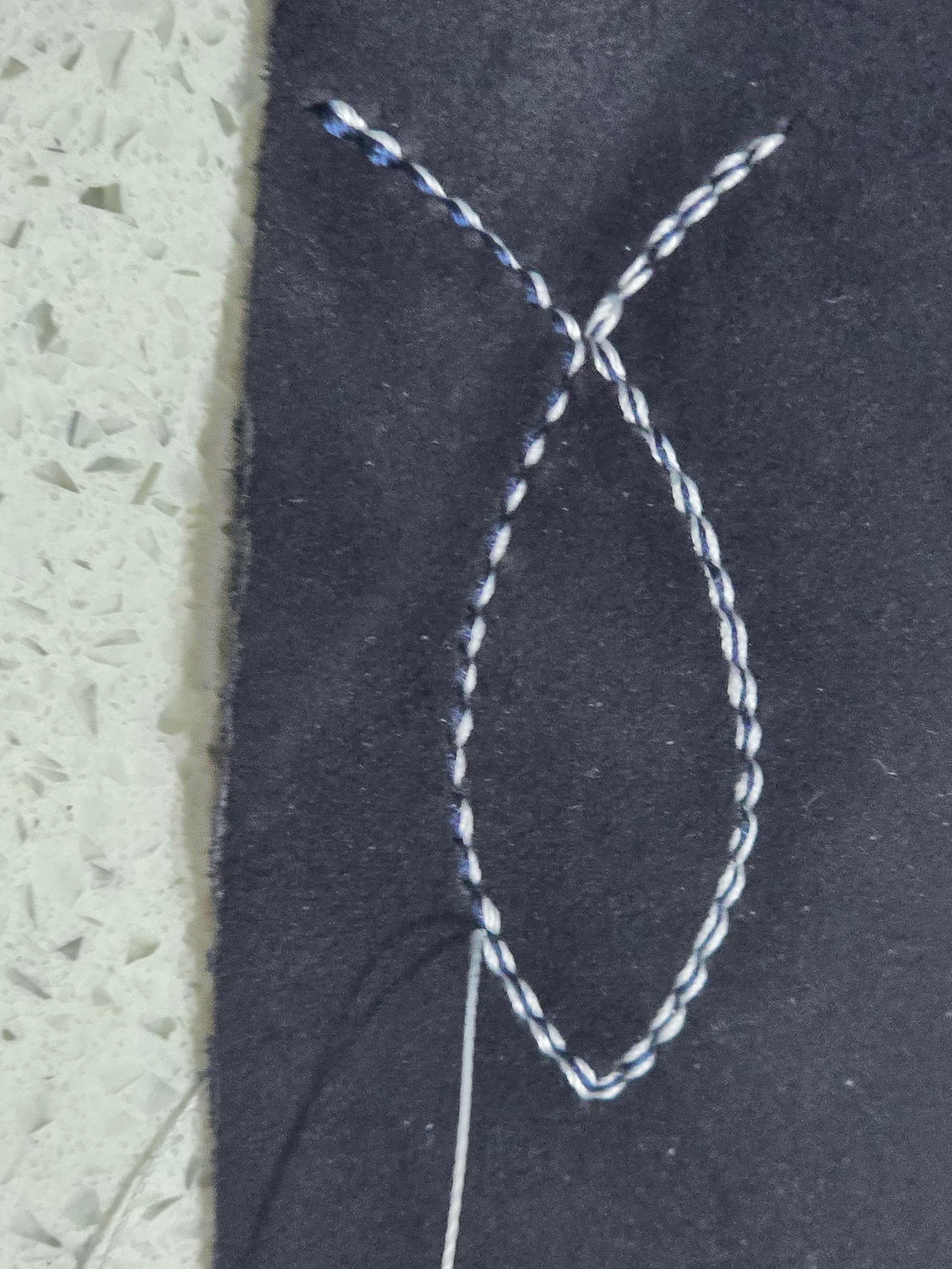

I have started some assembly of the uppers

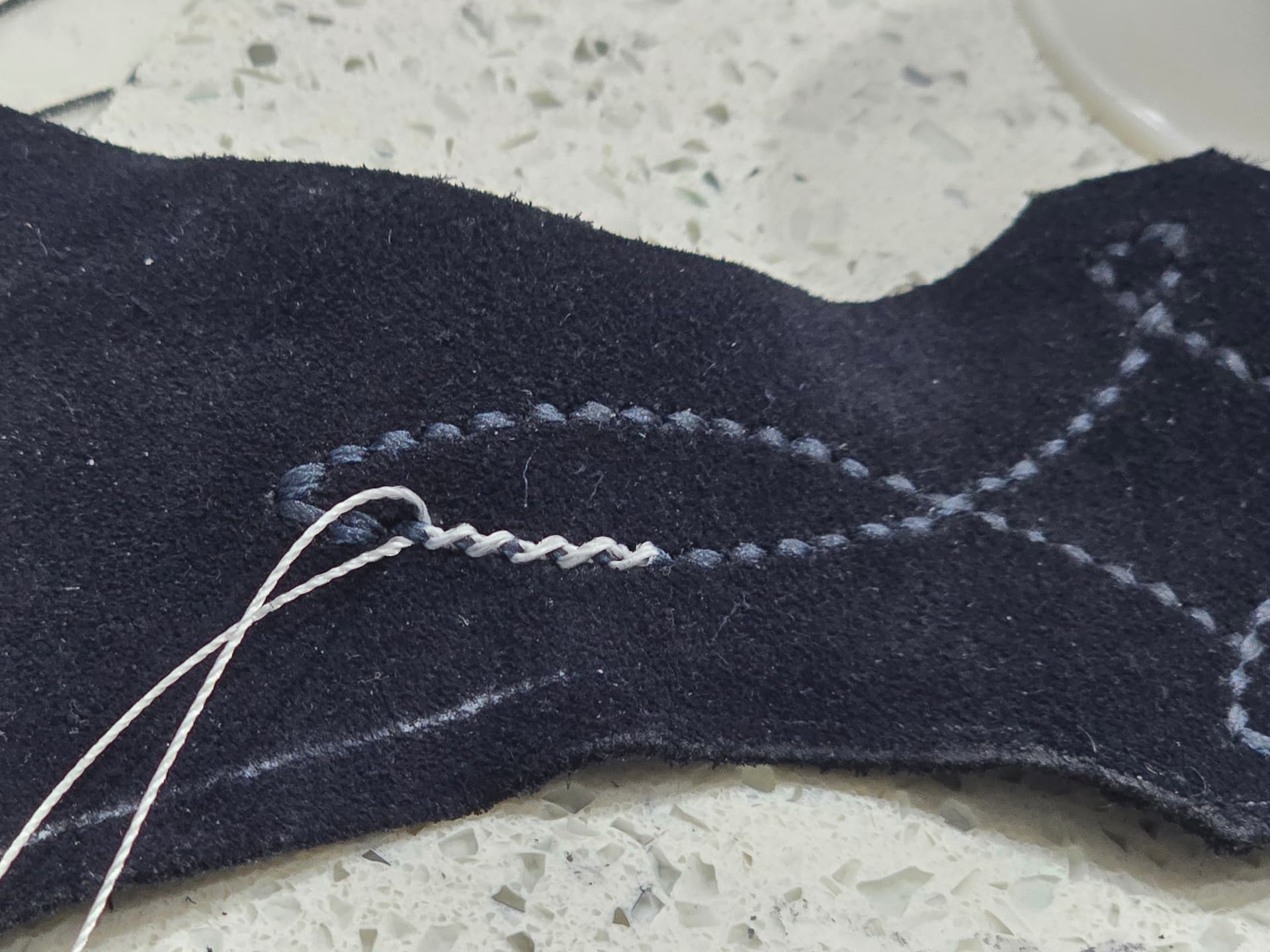

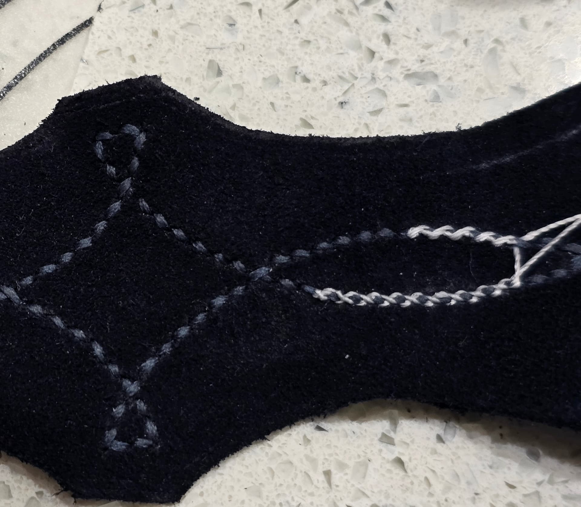

And been playing around with some decorative stitching to add a little contrast here and there

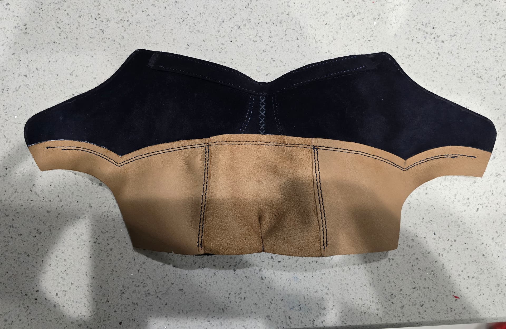

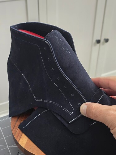

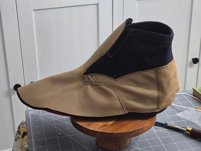

Start to thecskeleton/partial lining. Still need to trim, etc.

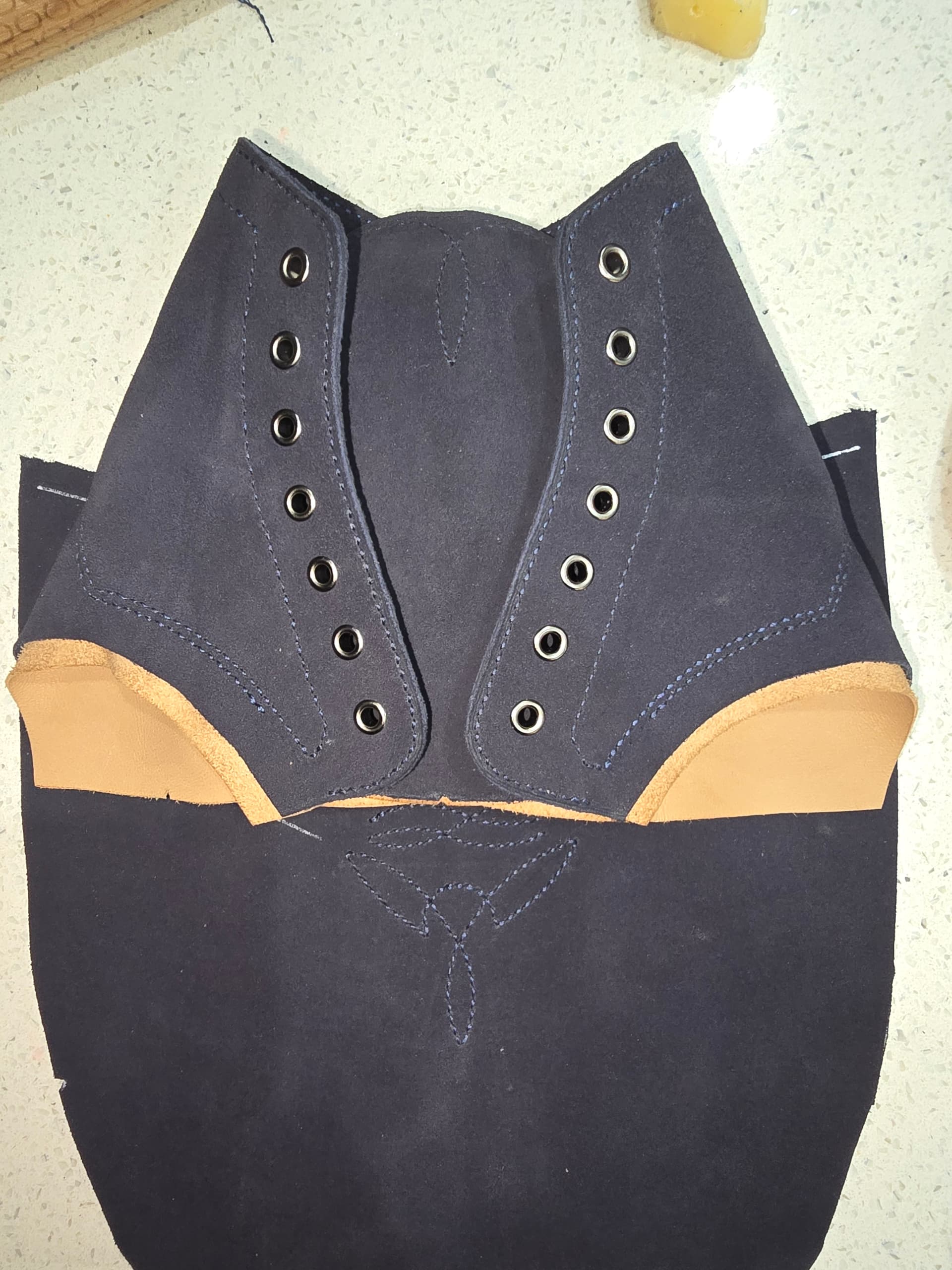

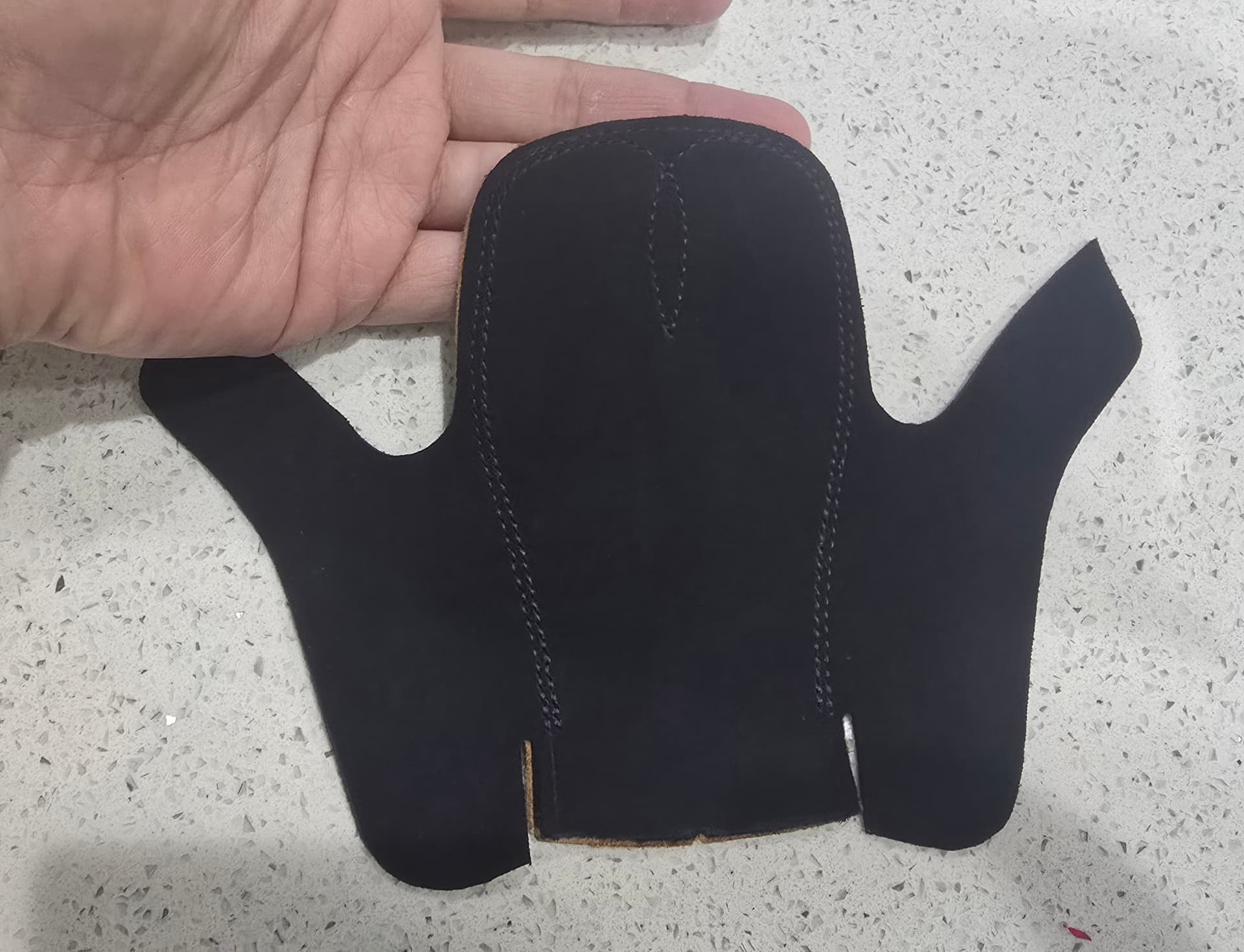

Added a little decoration to the tongue to carry the back strap design over
Slowly coming together
The point down the tongue’s neat. Don’t think I’ve seen that before.
I keep debating if I want to continue further down the tongue with it or carry the motif out onto the vamp.
Realistically, anything else I add to the tongue will get completely lost once everything is laced up. This is enough to peak out above the laces because of the tongue height
If you want the stitching practice, I don’t suppose there’s any problem with continuing down the tongue.
I agree it likely won’t be seen.
I ended up carrying it onto the vamp instead

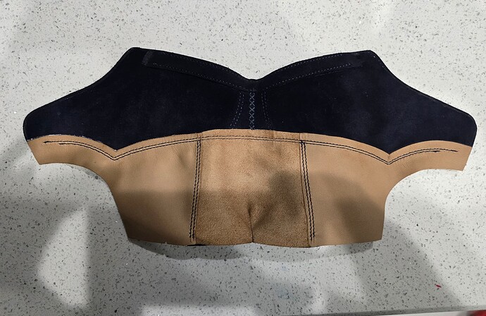

This suede is nice and easy to flip inside out. Makes it easy to show the liner coverage
