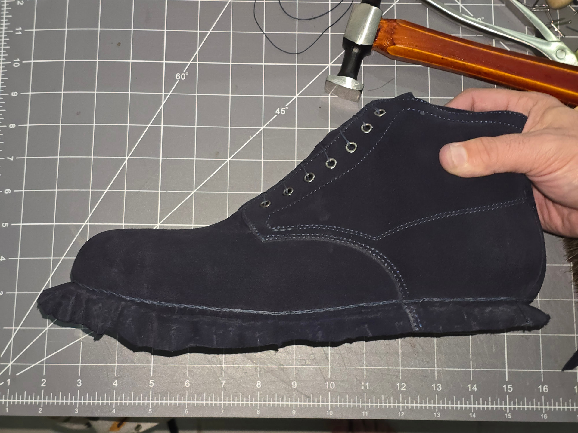

Boot #2: an actual chukka. OK maybe not a chukka

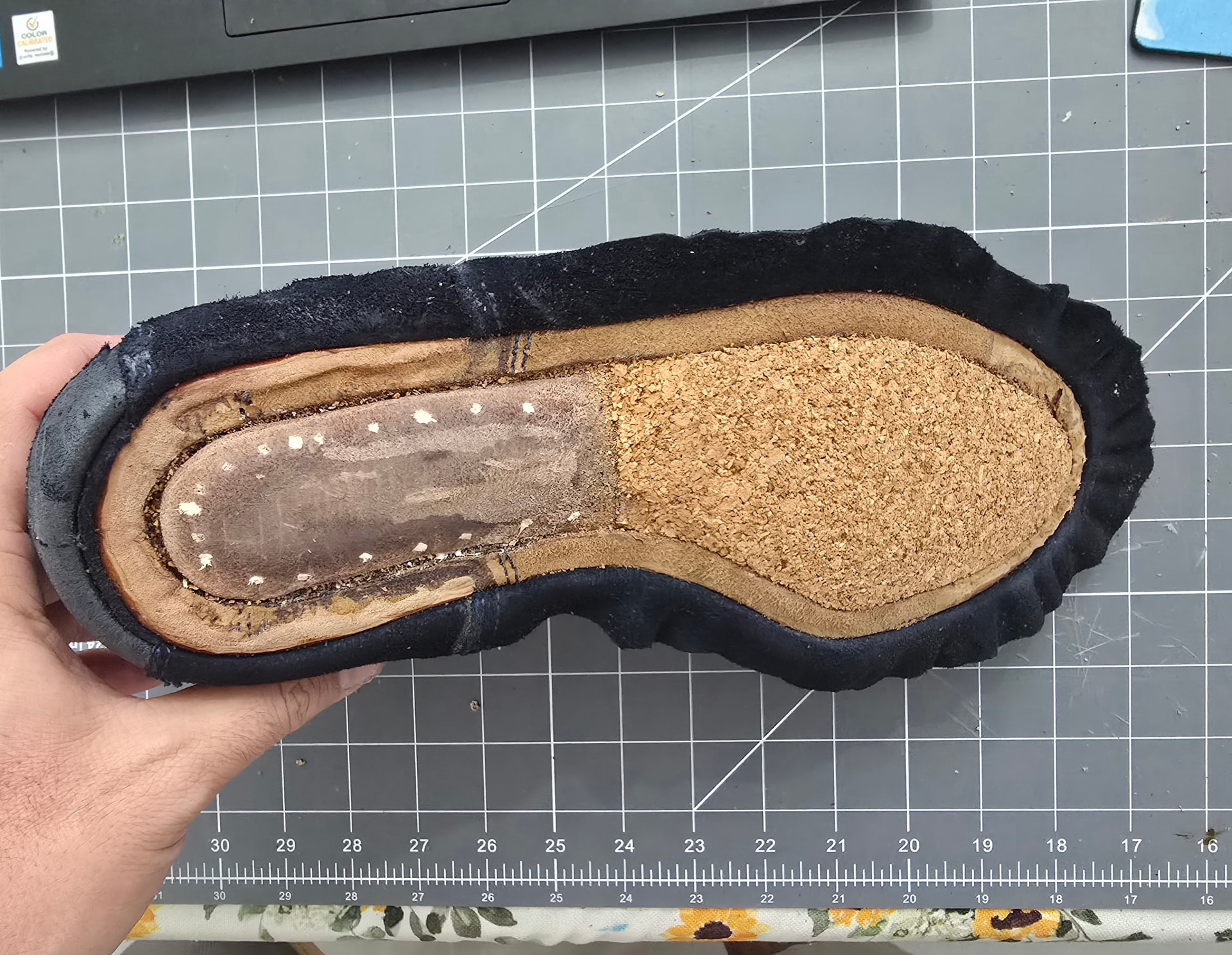

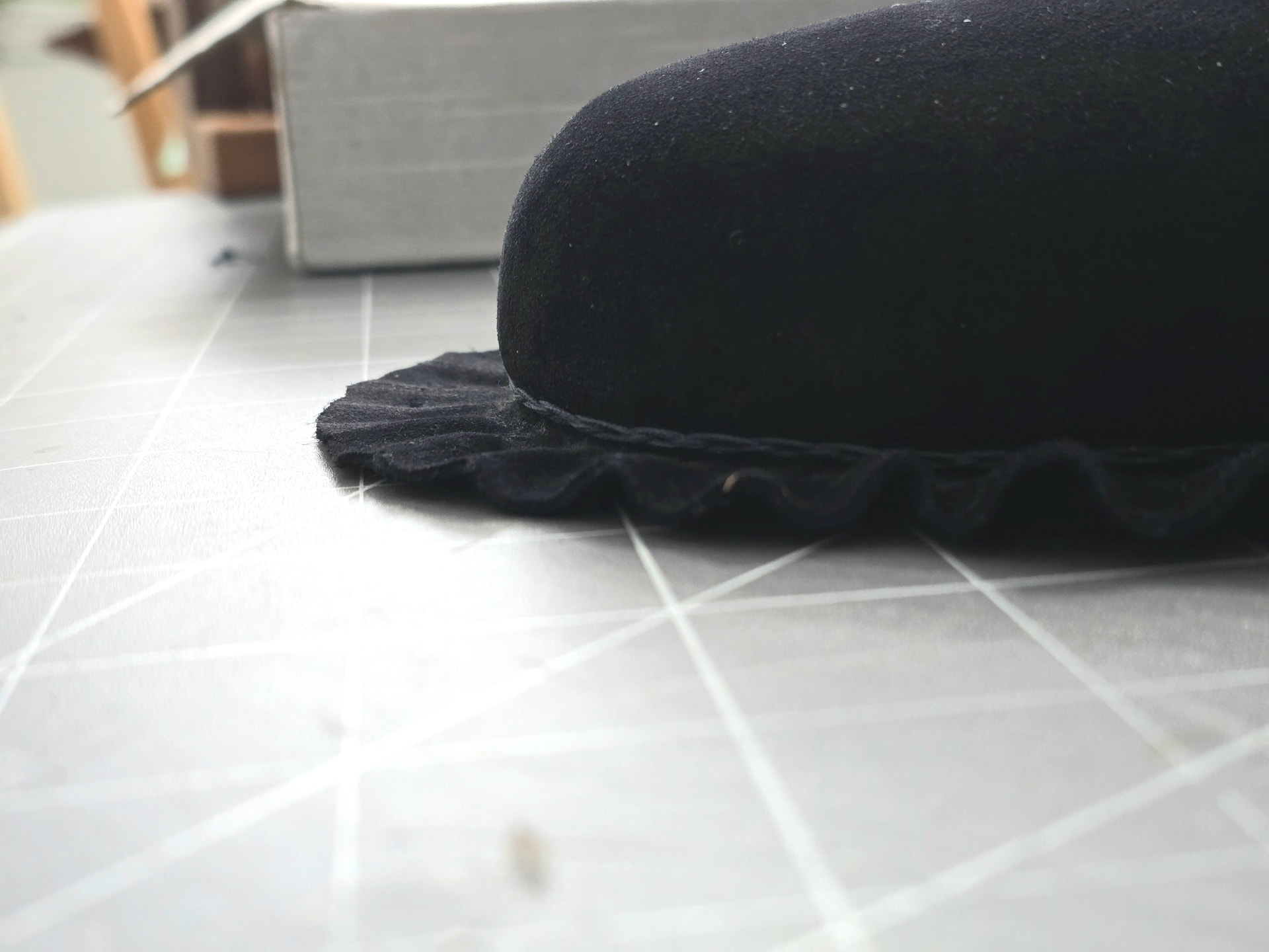

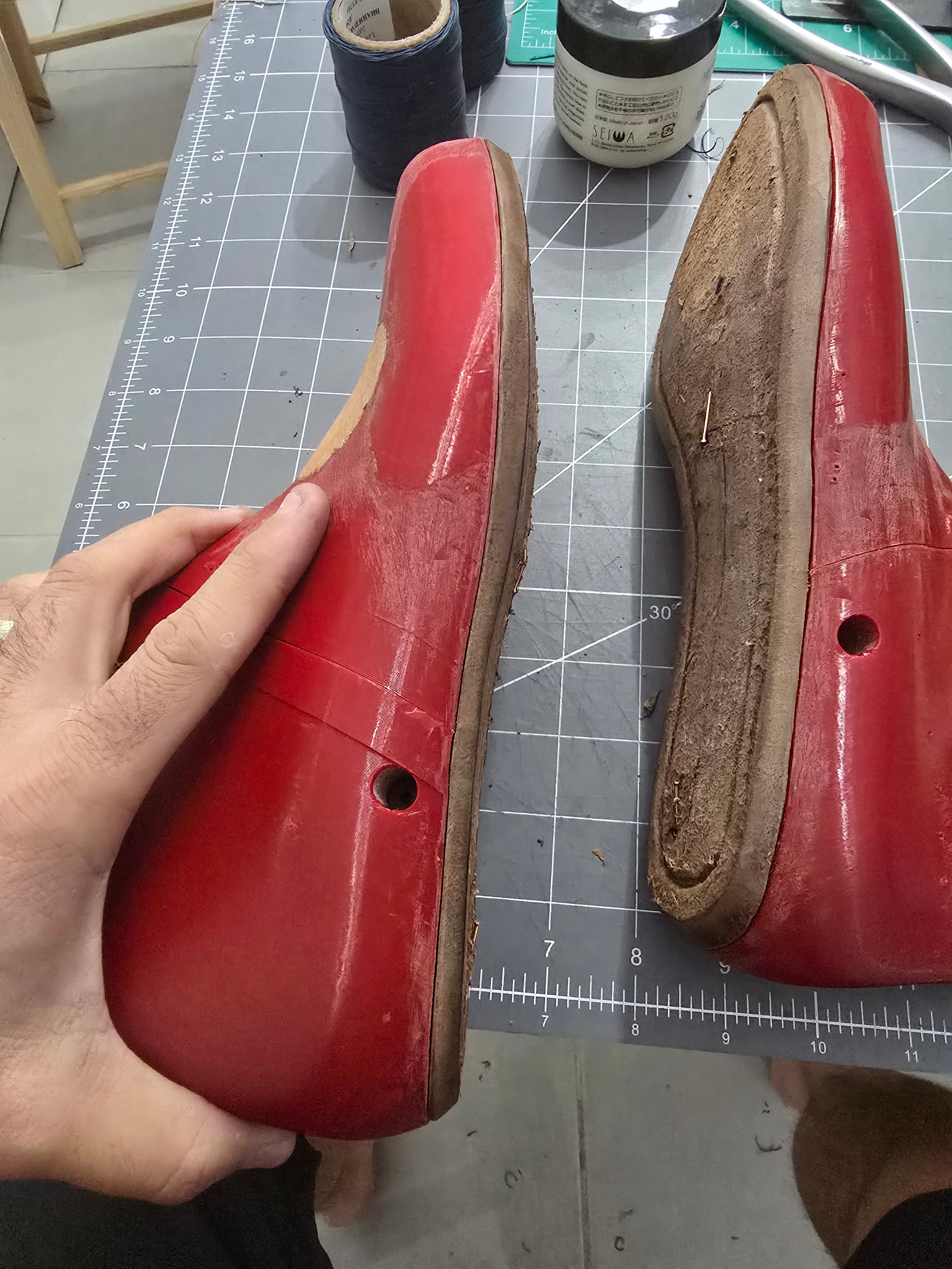

One of the things I wanted to try on these is to do a stitchdown-based construction without the visual bulk in the soles. The info I have seen on norvegese builds usually suggests a vertical sidewall on the insole, which I am sure helps make the chain stitch pop, but it seemed like one could really use the side stitching to pull the upper in really tight on a stitchdown to get closer to the silhouette of hand-welting.
When I cut the insoles, I was pretty aggressive with how much I chamfered under the last.
Seems to be working pretty well.
For your insole prep, did you do anything after trimming with a knife? I’ve seen in videos sometimes they go over the edge with glass or a rasp.
I went over it with some sand paper to even out and then ran a bone folder over it, although that probably wasn’t really necessary
Leather shank in and pegged and cork leveled upfront. I will run some pegs through the midsole into the shank as well to box it completely. Did the same on my last pair and I have been happy with it this far.
Haven’t decided if I want to do some cork around thr shank, kinda like a pseudo rand to level it off a bit more or not.
Don’t think it’s an issue, but I bet you could extend the shank further forward.
The cork overlays the end of the shank by a bit, so it is a bit longer than it looks. I feather it down as it approaches the front. Still probably could have gone a little longer, but it’s deceptive in the picture.

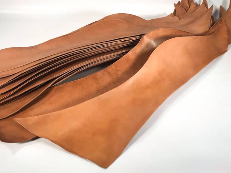

Nice work! Ask what you used for the midsole?
It’s horween russet horsebutt strips. My usual go-to for things like counters since it’s strong and cheap. Not particularly thick for a midsole, but I am trying to go a lot lower profile on this boot compared to the last where I used a sole bend for the midsole.
If horsebutt’s the cheap option, maybe we should talk about your leather supply! Are you tapped into a local shoe repair supplier?
Usually works out to <$5 per sq ft for good quality veg tan. I haven’t seen anything significantly cheaper than that.
I have been trying to get an account set up with Franklin, but haven’t had any luck.
Horween’s horsebutt strips are real cheap! Last I checked they were only about $25 each.
One issue is the thickness is inconsistent. The center may be 5-6mm and the ends only 2-3mm. Not a big deal for things like counters, where you’re skiving away a bunch of the material anyway, but I wish it were more consistent for insoles, midsoles, welts, and the occasional belt.
