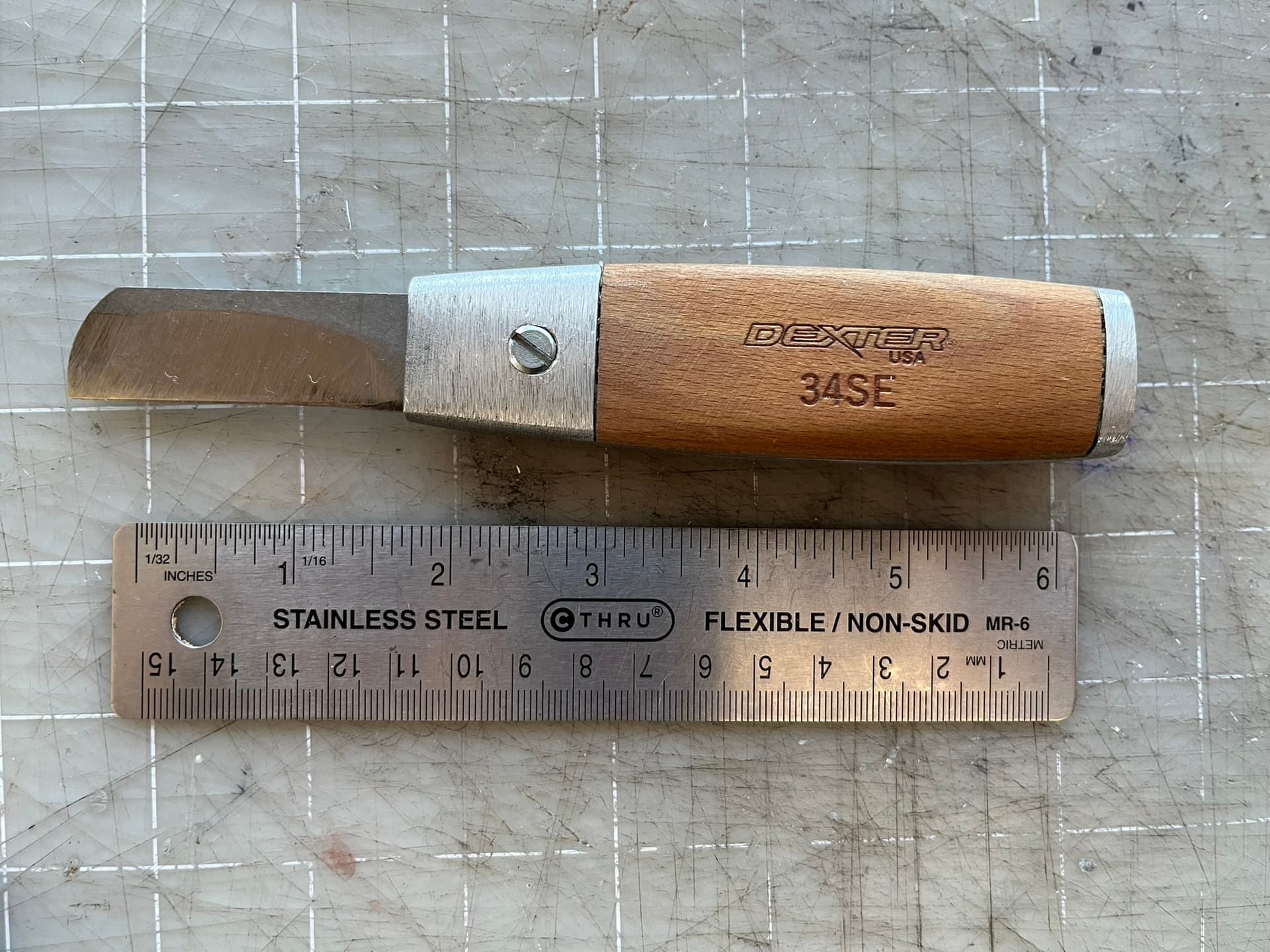

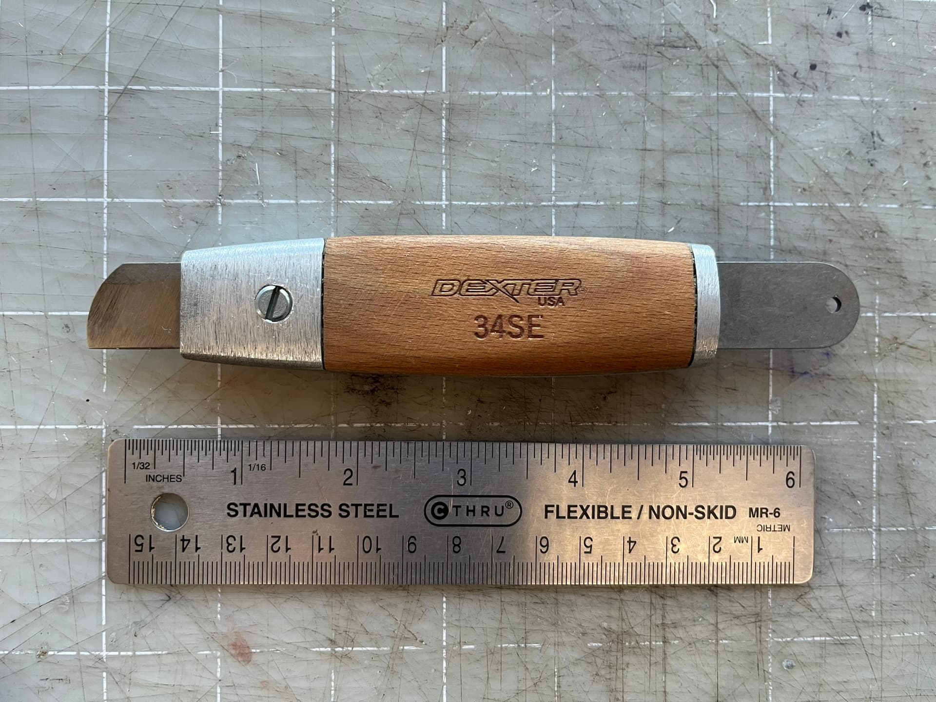

I have a wood handle for thinner extension blades that I use for clicking. I see that Hyde and Dexter make handle holders for mill blades, as well. I don’t think I’ll be buying one. I’ve wrapped the bare blades in hockey tape for now. Perhaps I’ll make scrap leather sheathes for them sometime later.

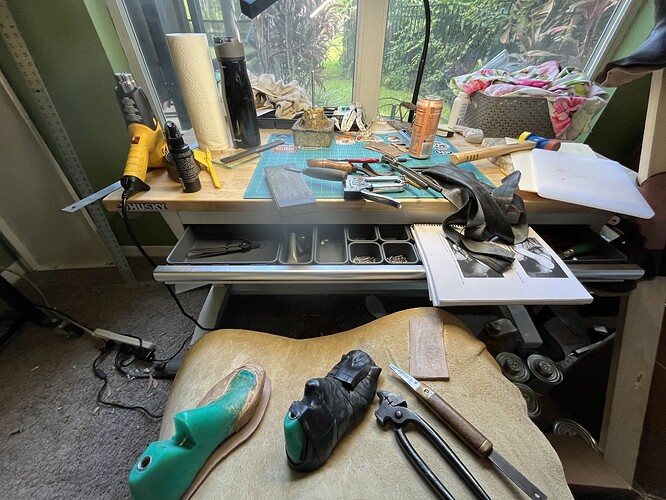

Heres a picture of my set up for my first time. Apologies for mess but the knife is on the lap apron. Also I glued a peice of stiff soling leather to the knee of the apron and put rouge on it and its super convenient for a quick strop between cuts to keep everything like buttah
Great photo! Nice green view out that window.

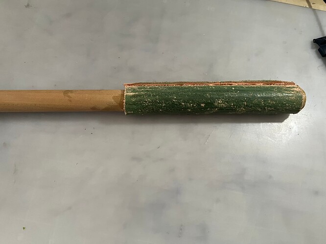

Some folks I look up to just hone on a thin stone or steel. That means they can’t hone right up to the lip, but keeping just the middle sharp works fine for them.

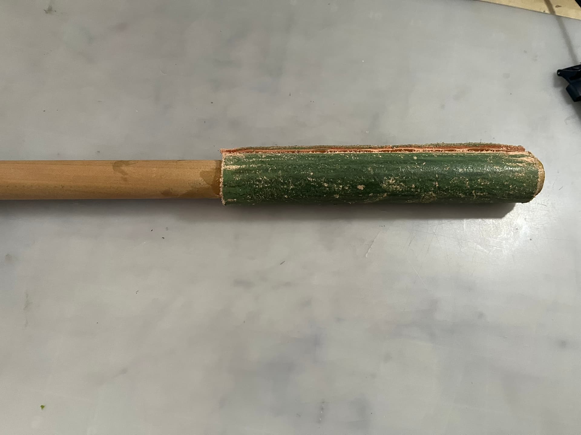

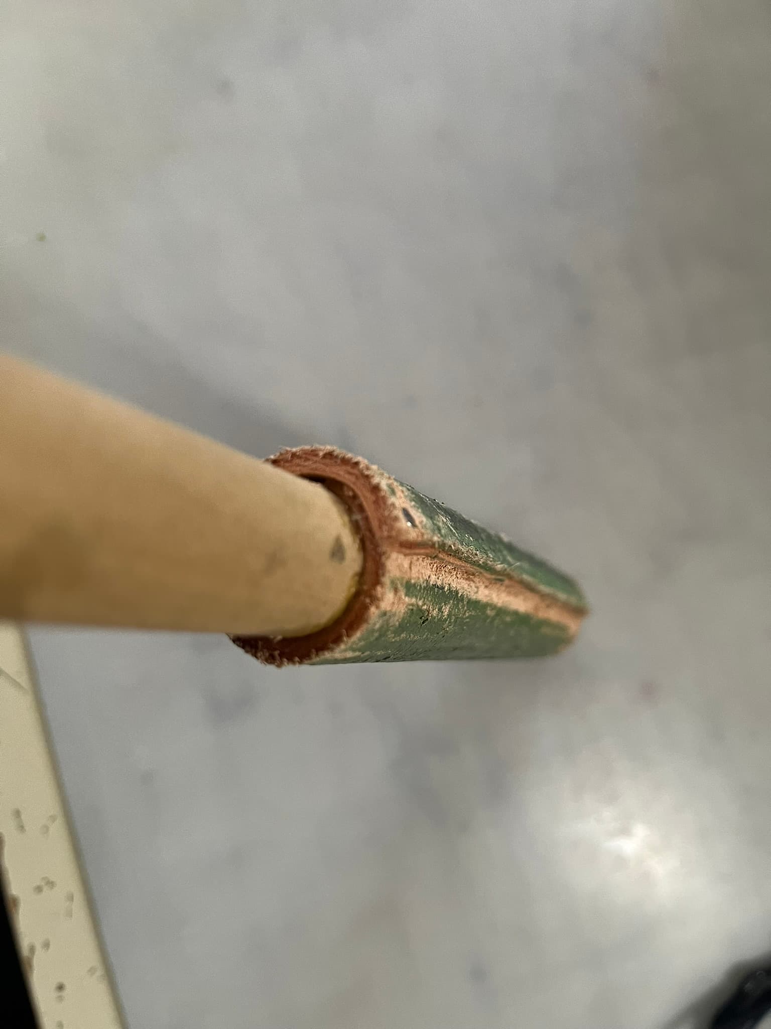

What’s been working for me is a little round strop I made. I wrapped a piece of scrap leather around a dowel, overlapping at one edge like a cinnamon roll and tacking down. Then I rubbed it with my go-to green honing compound.
Having the little ridge where the leather overlaps itself lets me strop right up the lip or the handle.
Brilliant! I’ll try that. I used the edge of my strop but it didn’t really get in that curve

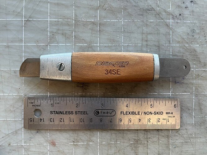

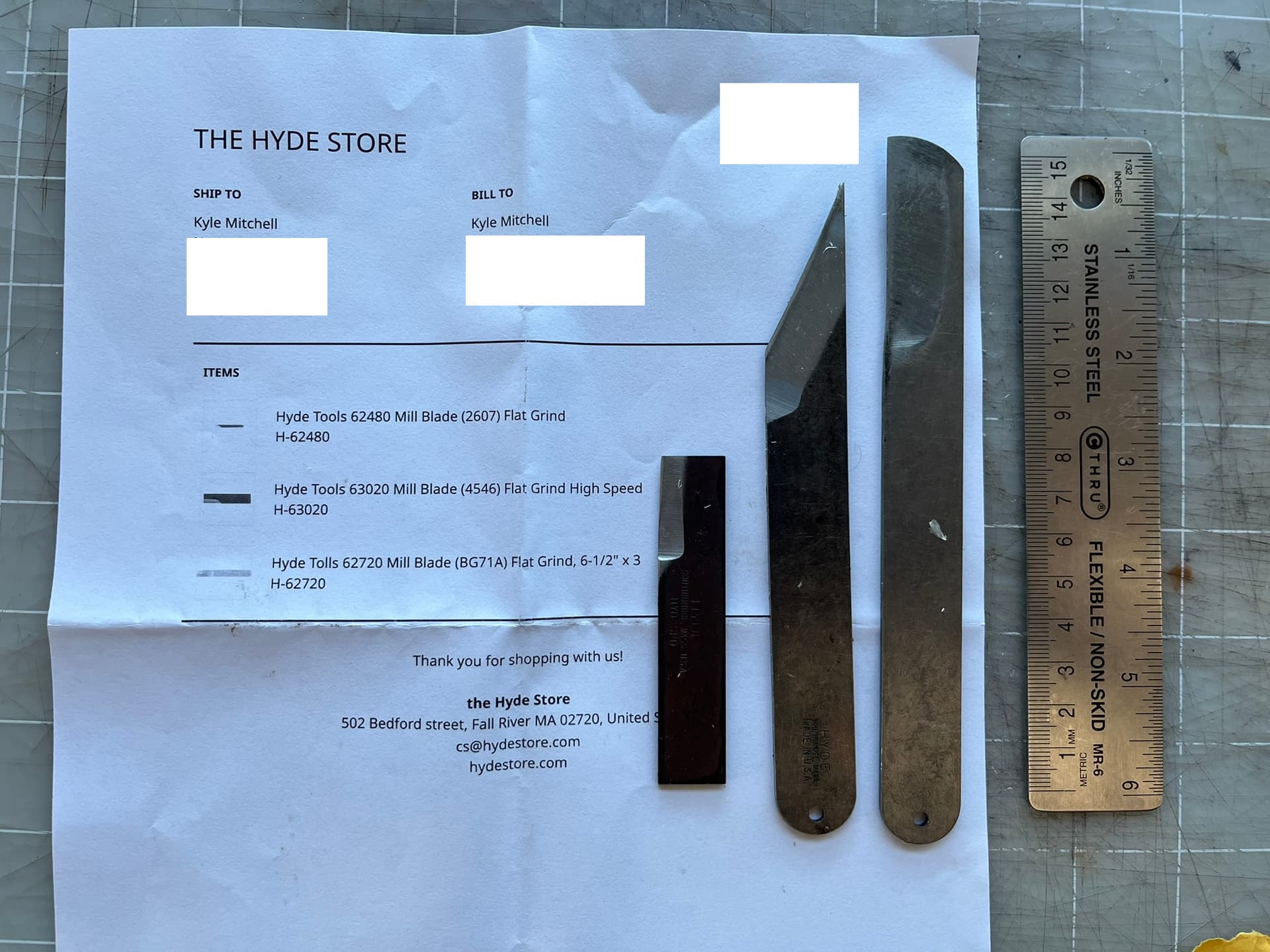

I’ve been so pleased with the Hyde mill blades that I tried, and especially with the trick of using a handle as a depth stop, that I added some more blades to an order:
The pointy 2607 was my clear favorite from the first batch, so I got another for the garage. I had hopes for the little 4546, but I’m most excited about the larger BG71A. I get the feeling that blade in a mill blade handle may replace my lip knife for whittling and trimming, and be much easier to sharpen:
