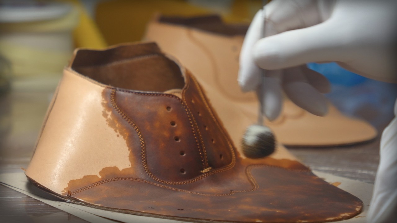

any idea what kind of protective plastic film he’s using in this video?
Also, I love the under-bench workshop at sitting-height, hidden in the cabinet under the work bench.
They are protective shoe covers to avoid marking the uppers. My guess is he is using the ones sold by carreducker.
https://www.carreducker.com/shop/shoe-making/shoe-making-materials/shoe-covers/
They have a blog post on them too:
In the US Lisa Sorrell sells them:

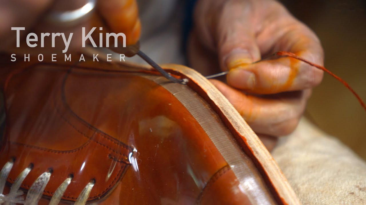

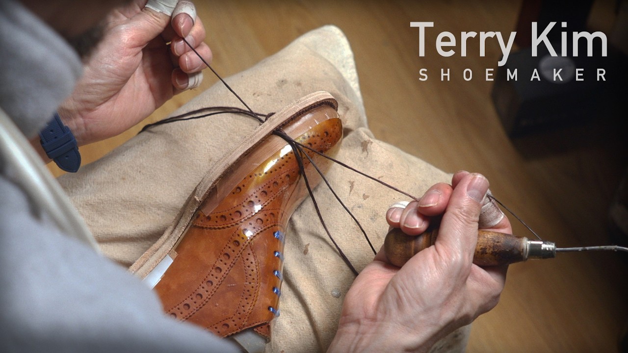

I have made a pair using the covers and one without them. My advice would be not to use a super sharp knife but instead use a knife you don’t care about, dull it and heat it up, pulling the cover as you go. Here is Daniel Wegan/Catella doing it this way:

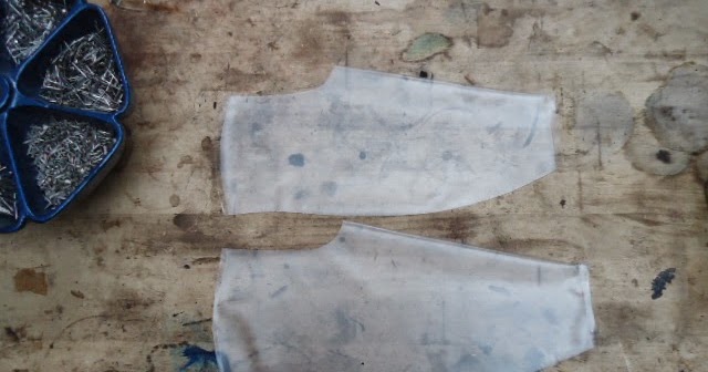

I have it on my to-do list to try making a sacrificial cover from sheet plastic like Terry Kim:
Lisa Sorrel sells plastic covers too if you don’t want to order overseas
