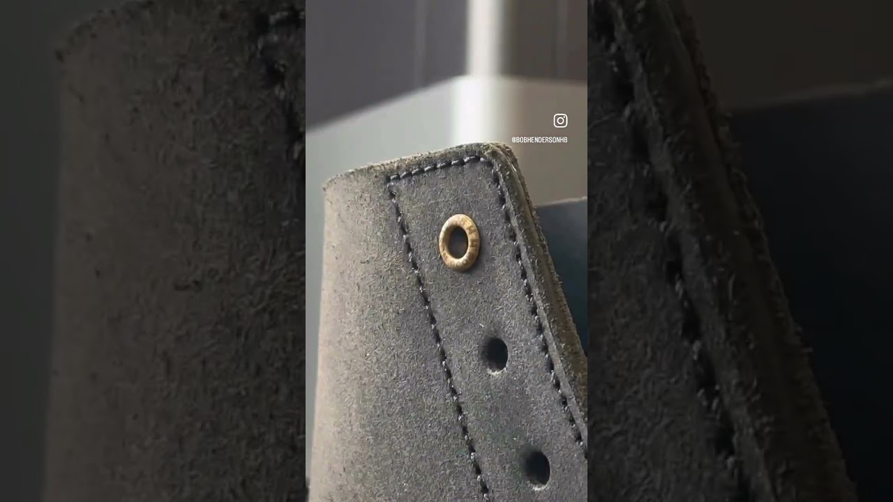

BOB henderson laser engraving eyelets:

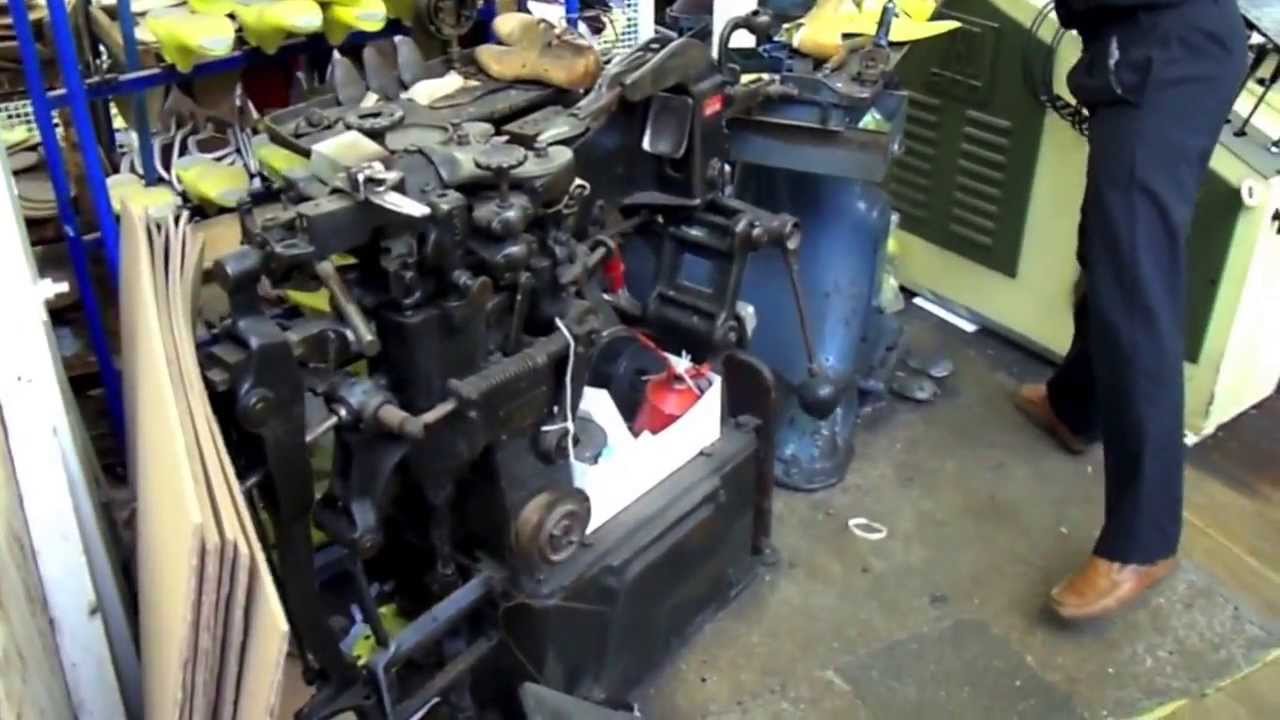

Old video of the line at Cheaney’s working:

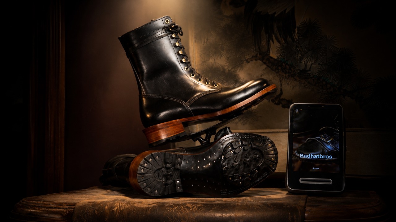

this week’s cordwaining obsession: New England Moccassin boots.
Not Moc-toe. I’m talking the real moccassin construction, lasted “upside down” with the upper wrapping all the way under the foot.
I kind of want to try this for my next pair, since I’m a New Englander. Gotta keep the tradition alive. Can’t let the Pacific Northwest hog all the “regional boot tradition” glory.

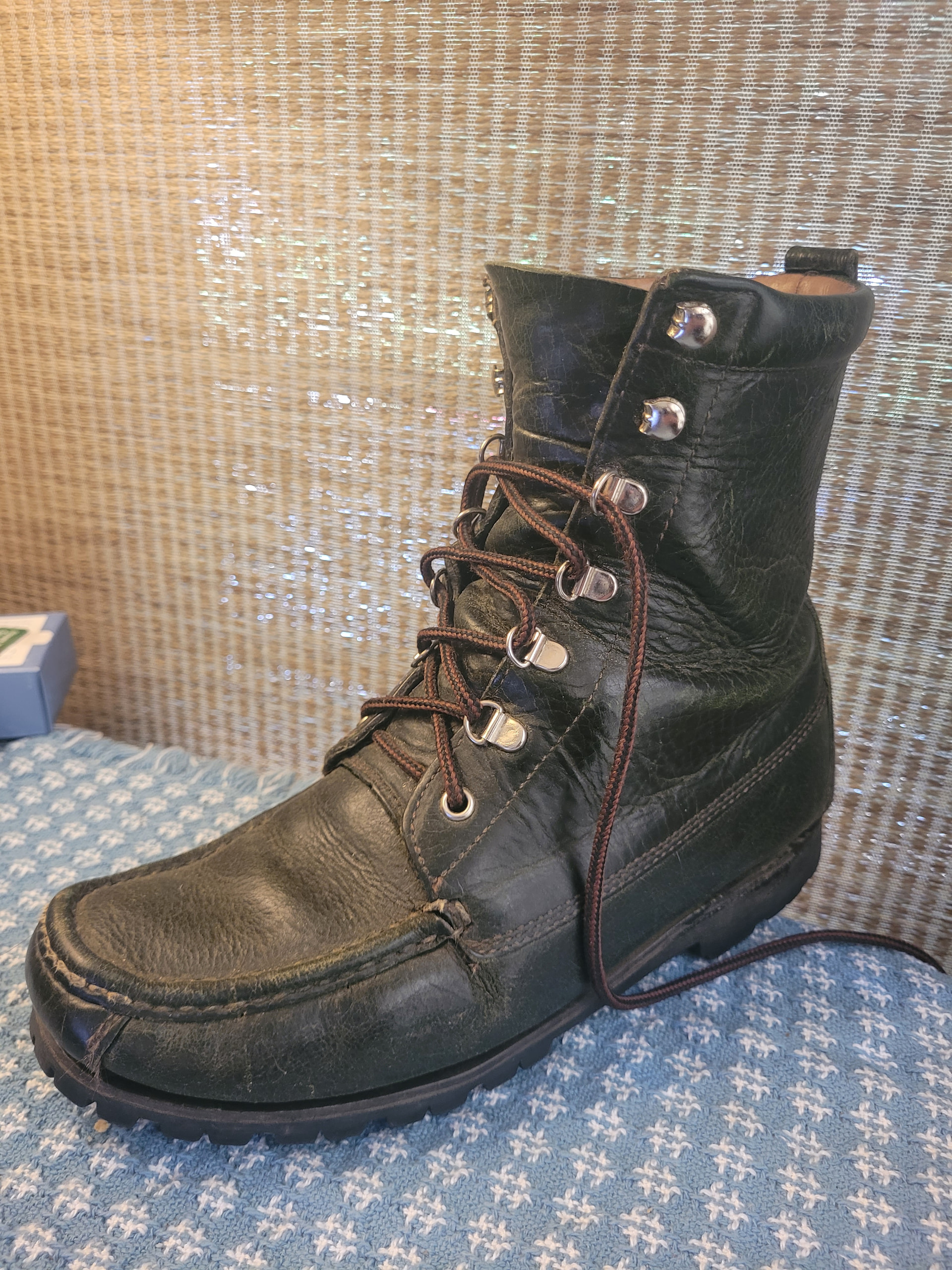

I have a pair of semi-vintage ll-bean boots that are made in the same style and I love them. They were a limited edition “Signature field boot” I got back in 2010 at their factory store on clearance for like $60. Someone had returned them and they had just been discontinued so the ended up in the clearance bin. Apparently an old design they dug out of the archives and did a limited run for a year or two. I’ve never seen them in the catalog since then. 8" tall, Dark licorice green with silver lace hooks. 8" My “gateway boot”.
I peeled up the sock liner and sure enough, there was that midline stitch to close up the almond shaped cutout right in the middle, and the vamp wrapped all the way underneath. But you can see where the cut corners to keep costs low. made in El Salvador. rubber midsole instead of leather. I’d love to make an upgraded version.
They still look pretty good for 16 year old boots that get a lot of use. They’re looking a little worn after 3 resolings. Some of the stitching along the toe is wearing thin, so eventually they’ll either need a complete overhaul or maybe I’ll just dissect them and use them as the pattern.
Nice! That looks like a solid find. As long as the construction is good, I see no reason why El Salvador would be a cut corner, same with the rubber midsole. I tend to prefer rubber midsoles for ease of soling and resoling. Significantly less need to stitch an outsole on when the cemented materials and similar. Even when Russell does a leather midsole, they also do a rubber midsole below it to just glue the outsole on.
I agree. quality seems great, as proven by their durability for over a decade. And they’re super comfortable and flexible. Maybe “cut corners” wasn’t the right word.
At first I thought maybe they had been made by a maine boot maker like Russel or Rancourt, but the price was way too low for that, and then I noticed the writing inside.

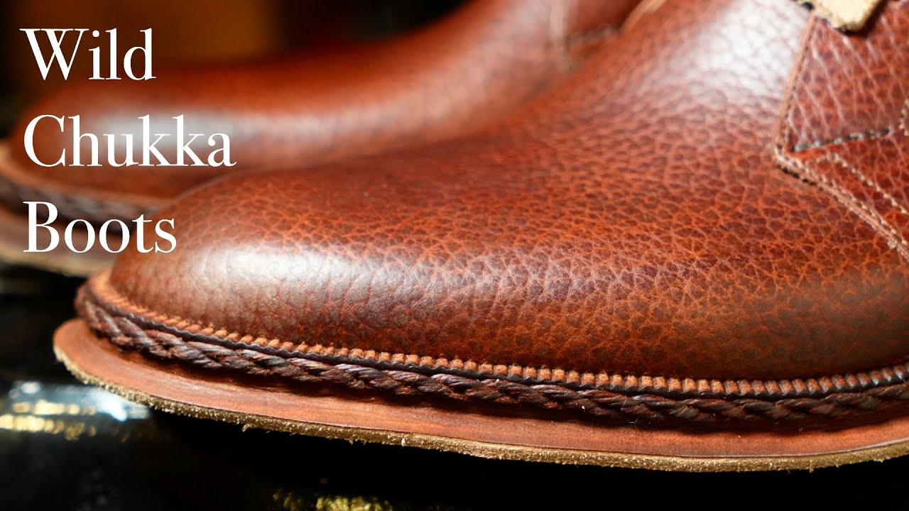

Here’s a great video that shows Norwegian storm welting, with a decorative braided / chain stitch.
Interesting hybrid lug sole: piece of lugged sole cut in a kind of squid shape, inset into a leather sole, and stitched in just around the front of the toe.
