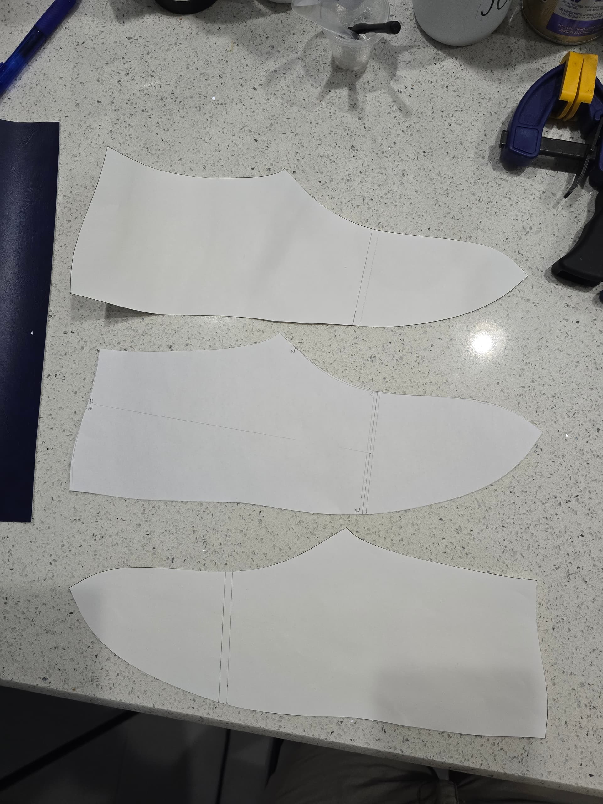

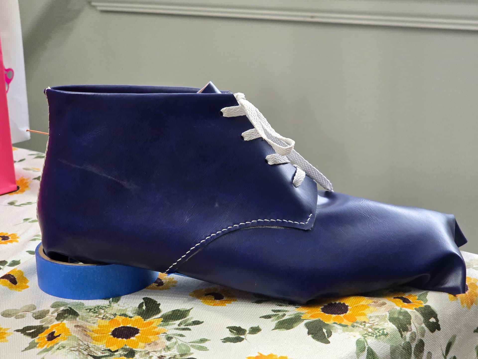

Made some quick patterns and whipped up a test piece using a really cheap roll of pleather off Amazon.
Take away so far is I like the overall proportions but my tongue needs to grow about 15 mm. I also like the exposed back stitch rather than using the big back stay I drew up originally. I think i am going to re-work the design to lose the back stay and move the vamp curve a good bit forward.

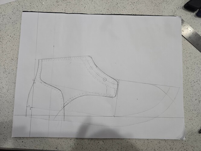

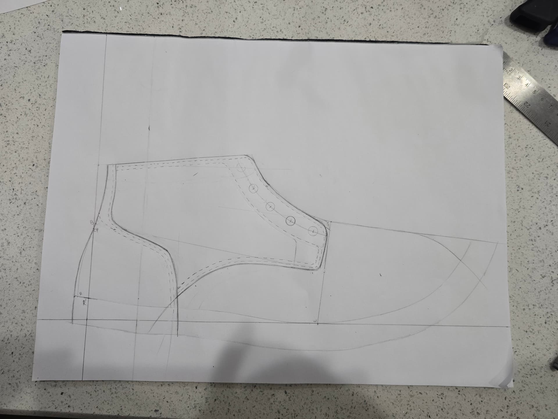

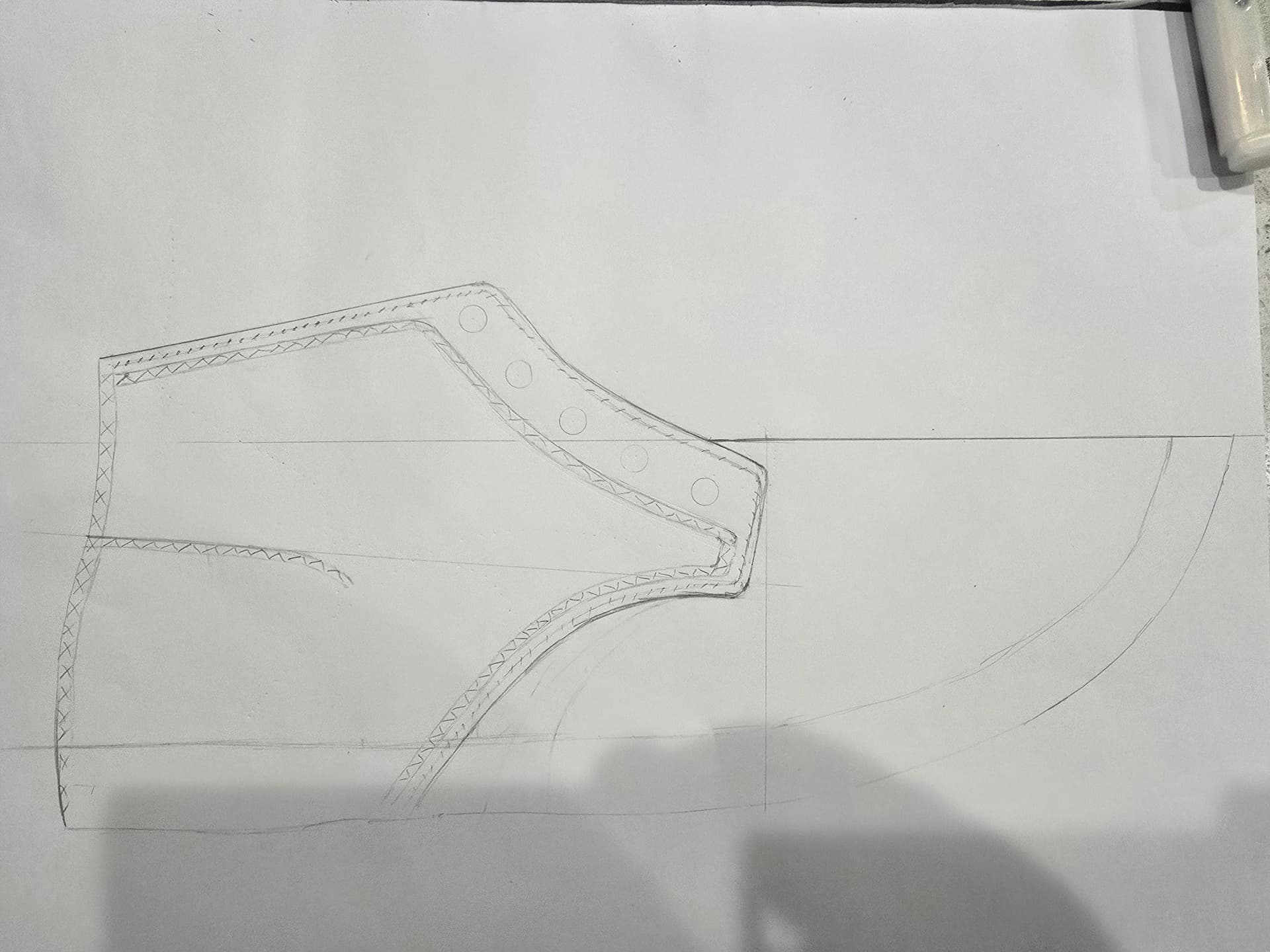

Revised layout with some of the decorative stitching roughed in
Interesting.
I’m seeing enough of a quarter curve that I’d probably call that a Derby if I didn’t know anything about it. But I seem to remember Florsheim in particular has done a bunch of “chukka” boots with more shoe-like quarters.
I can’t tell just from your drawing, but if you’re setting the entry point relatively high up the instep, like a typical chukka, make sure you set the quarter tabs down far enough that it’s easy to get the feet in!
Definitely following more derby-ish design parameters. It probably doesn’t fall into the actual definition of a chukka because of how many eyelets, where the opening is, etc, but at a lowish ankle boot with a sorta chukka-ish silhouette, who knows what to call it. Chukkerby? Derba? Doesn’t quite roll off the tongue.
Drawing is a bit misleading proportion wise because it has the lasting allowance already drawn in and the toe straightened for mirroring the pattern. Probably work sketching it up without those to get the right feeling.

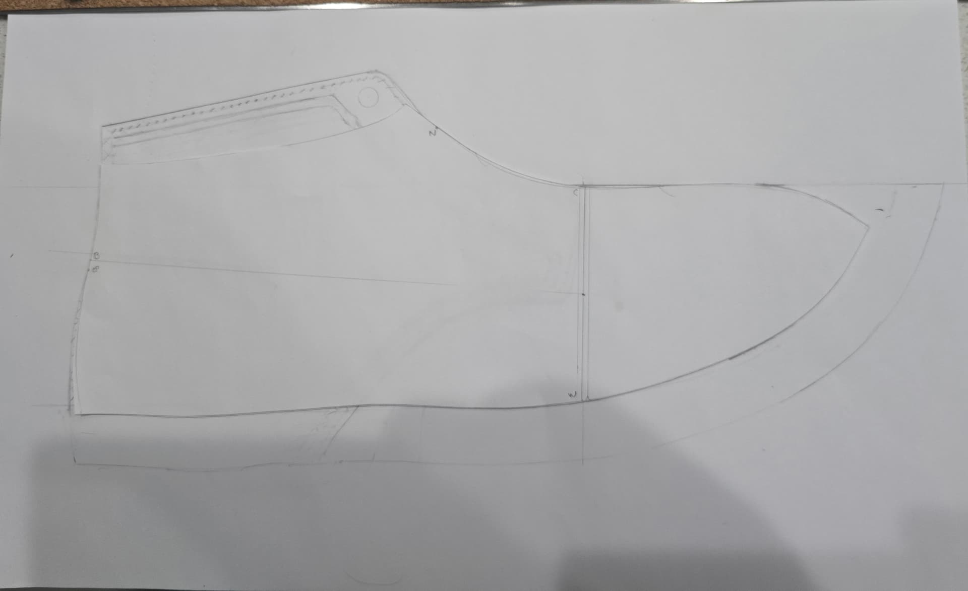

Here is the mean forme overlaid

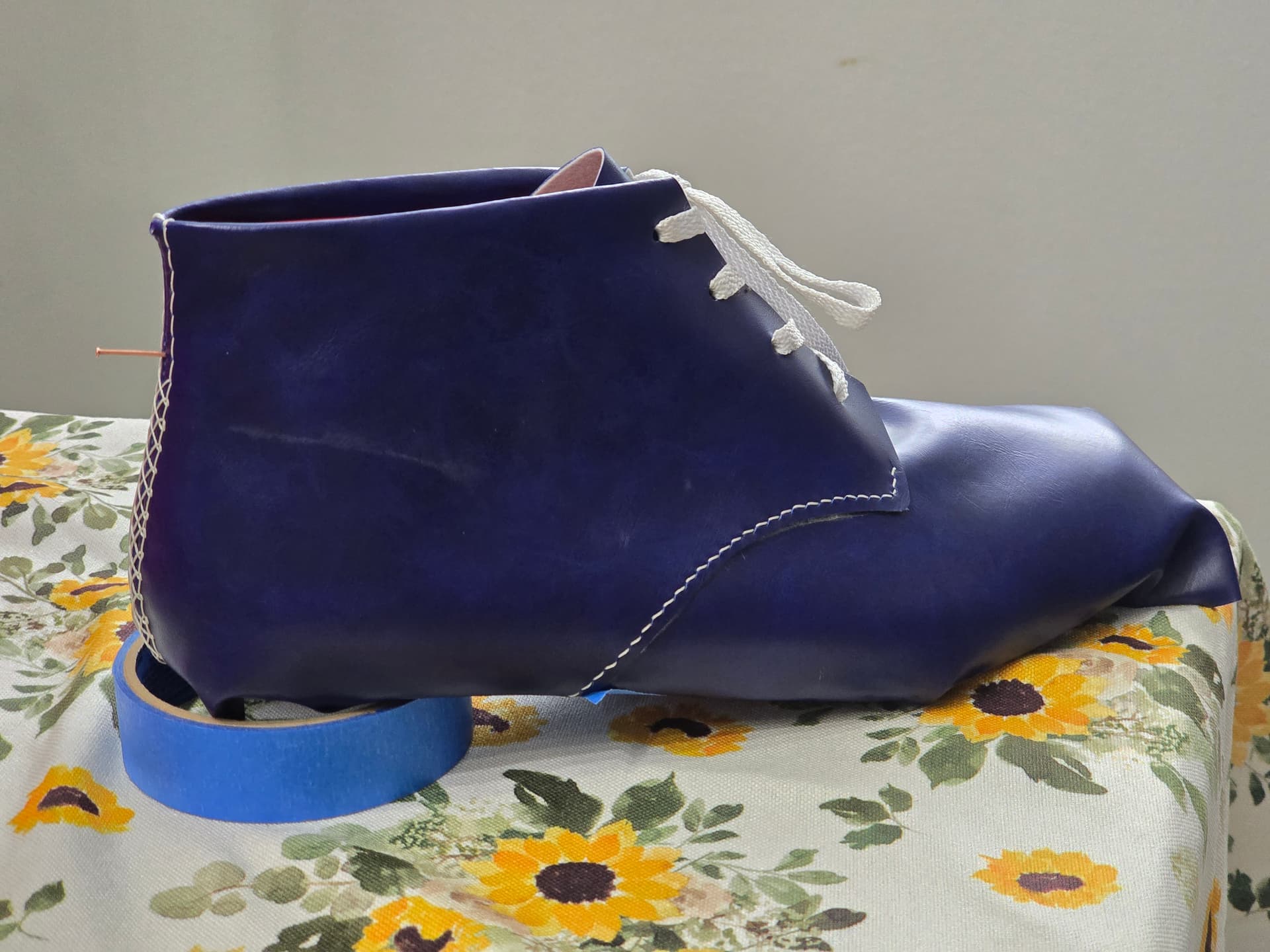

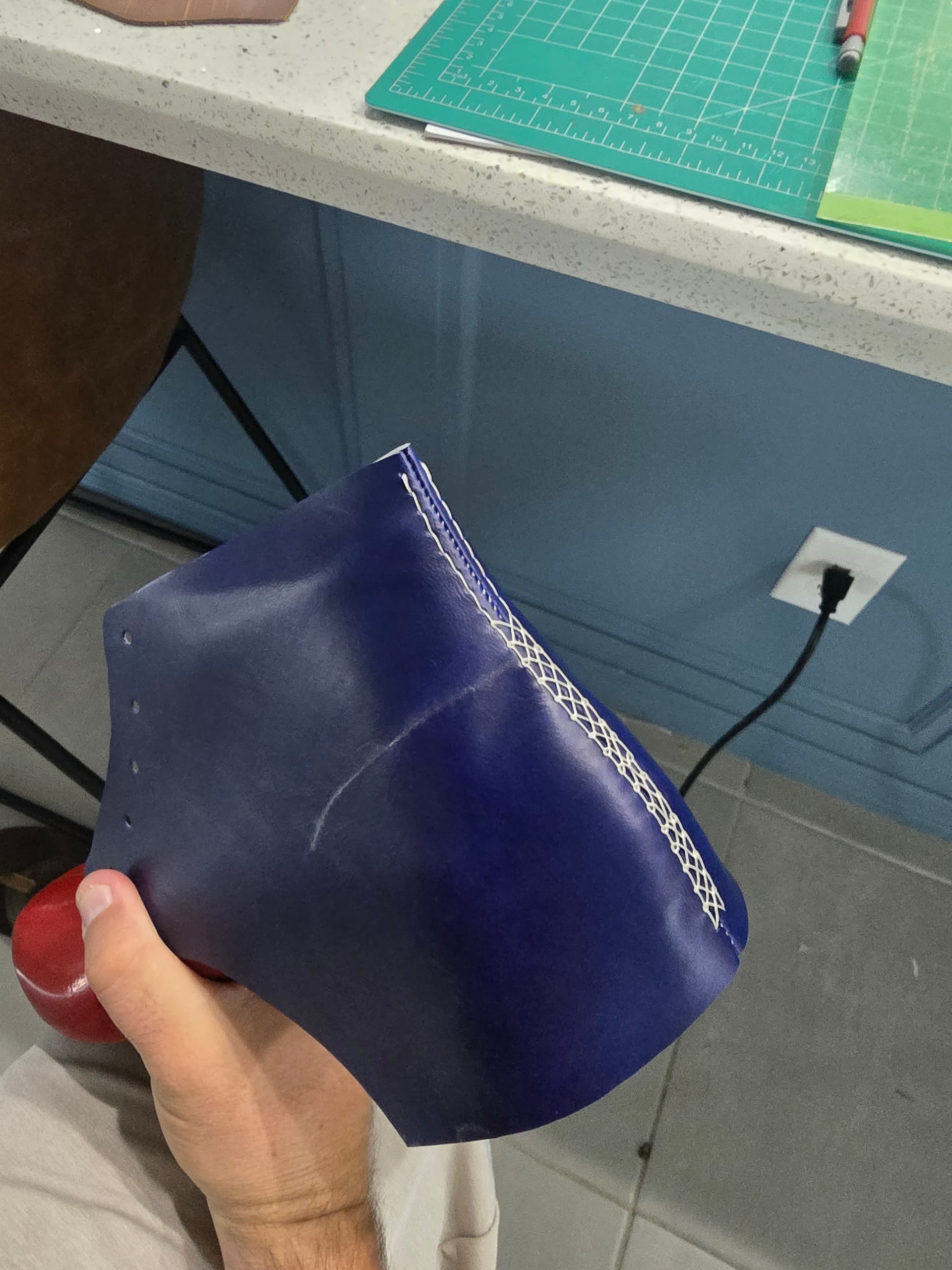

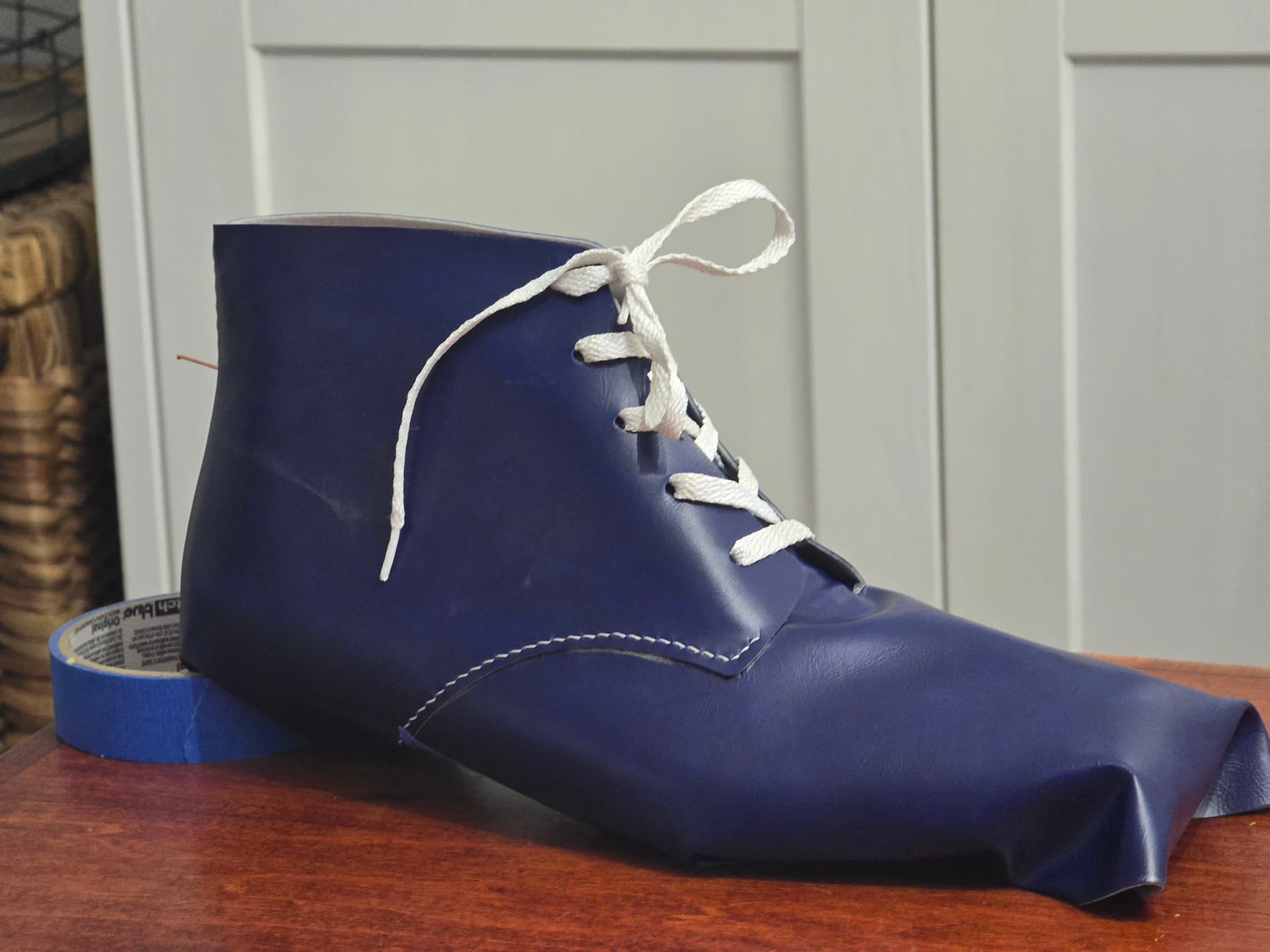

Starting round two of test fit with the pattern updates
Contemplating if I want to shorten the top line a half inch or so, basically removing the upper eyelet.
Definitely like it better a lottle shorter

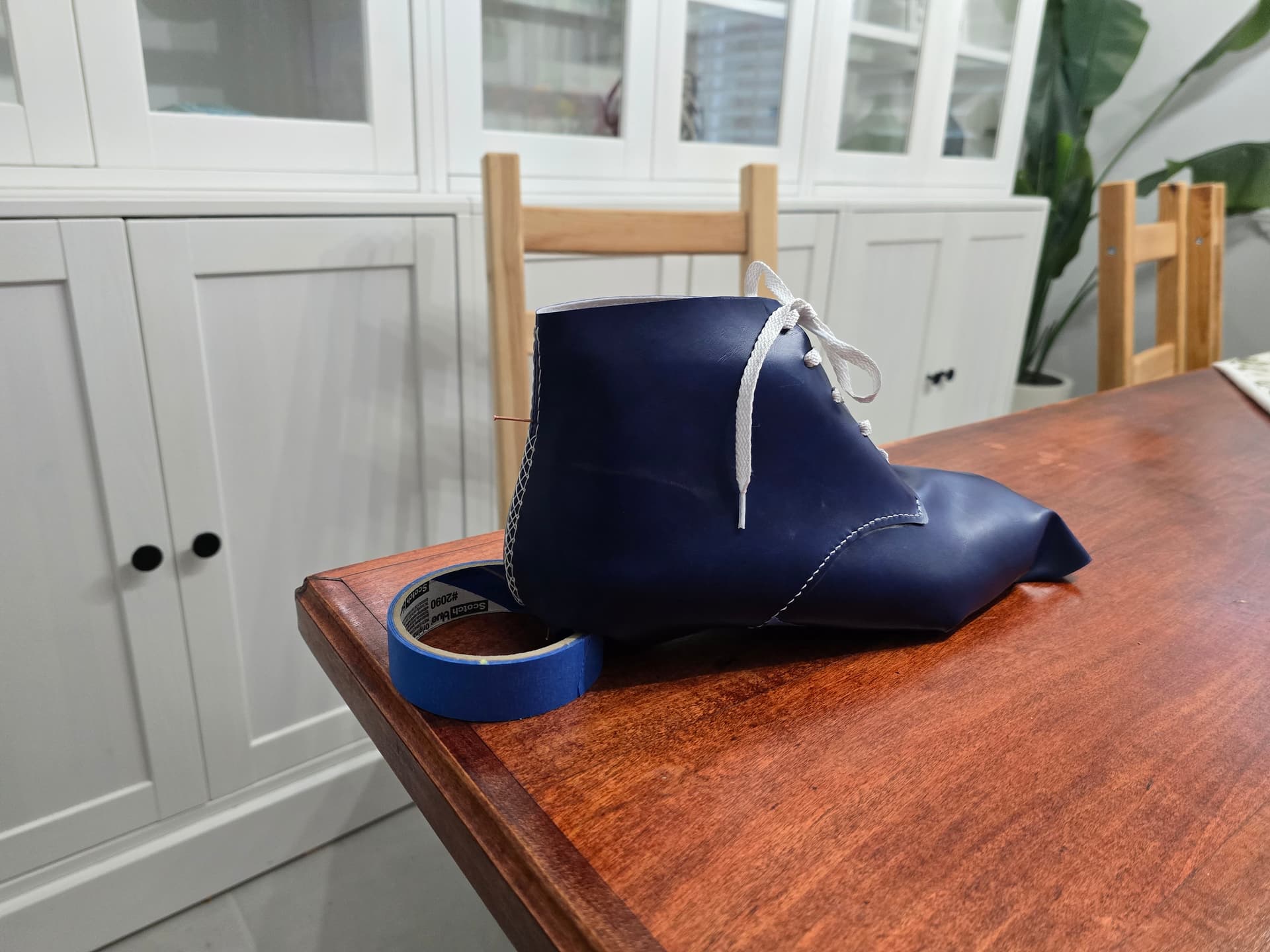

I’d check where the topline crosses the ankle. In my experience, it’s no having it fun rubbing over the malleoli.
Looking good! I’d definitely consider some extra stay stitches inside the corner of the tab.
It’ll get a good bit more stitching on the real thing.

I will physically measure my ankle height tonight, but with it trimmed down, I am sitting at about a 3.75-4" shaft height, which is fairly normal chukka territory from what I can tell, so I am hopefull it will land correctly.
I wish. That’s what I am currently using. Worked well enough to hold things in place while I did the stitching, but falls apart under any tension iver thr last.
Apparently my shaft height is higher than I thought. Measured my ankle at just around 3.75", so thought I was out of luck, until I measured the mock up and it’s sitting at more like 4.75" to the top line where i have it folded over for the low height.
Failed successfully at getting the height I wanted?
