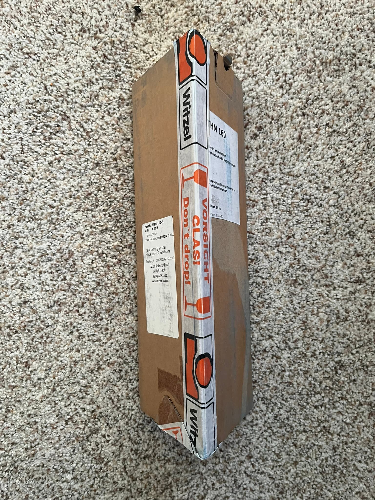

The material comes as hard chunks, a bit like small blue rocks, in triangular cardboard tube-boxes. Some of the material becomes dust, and seeps out a bit from the packages, so I decided to go ahead and melt it down into bricks for cleaner storage.
Here’s two kilograms melted down and poured into a loaf pan over wax paper, with two more kilograms melting down in a 5.3-liter pot from IKEA. I’m heating over an induction burner set at 285F, near the lower end of the melting range of 140-160C:
Based on the packaging of the THM 160 and some notes from Signature Plastics, the manufacturer, it seems like the packages I received were distributed through Witzel Acupress in Essen, Germany:
