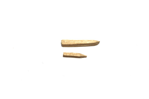

Barnsley offer pegs in Small (16 mm) and Large (26 mm).
https://www.georgebarnsleyandsons.co.uk/product-page/wooden-square-pegs
