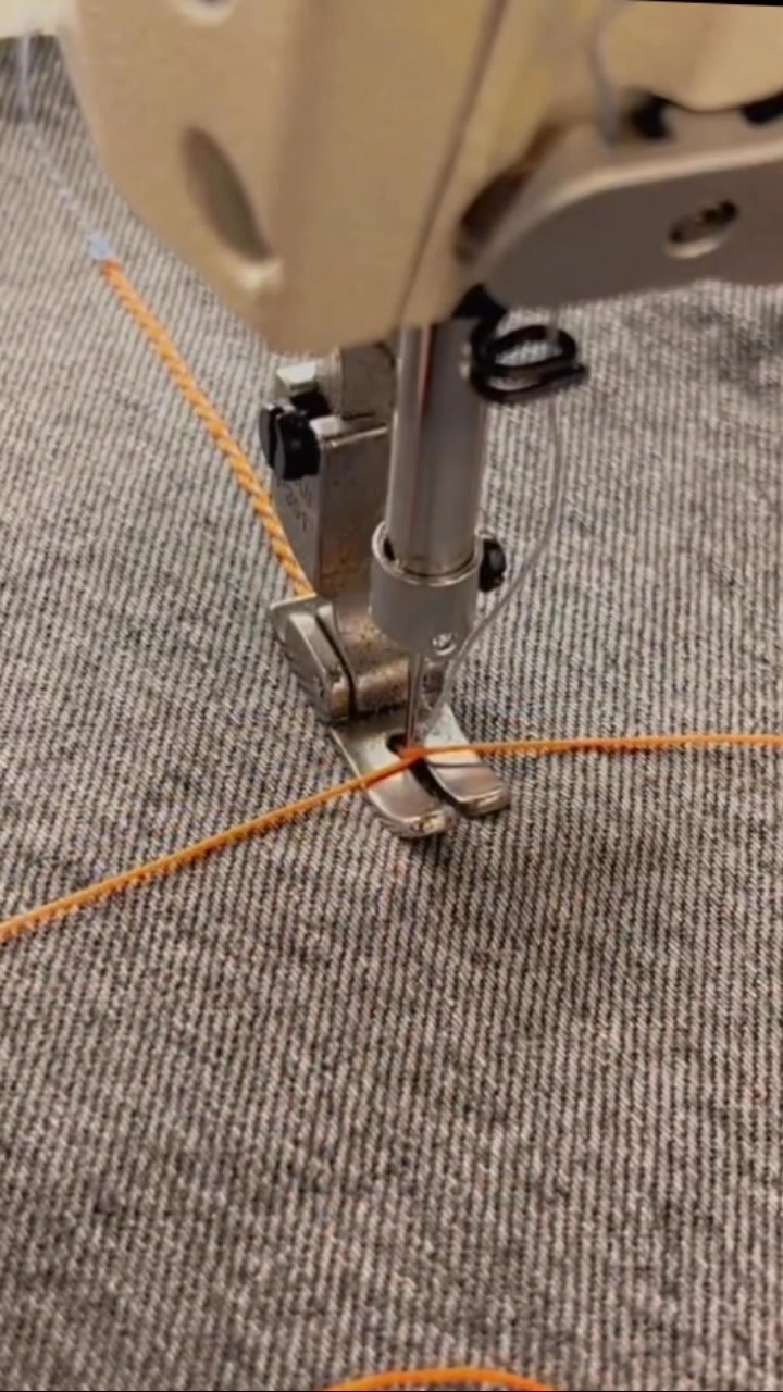

On the topic of mixing machine sewing and hand techniques, this popped up in my feed:

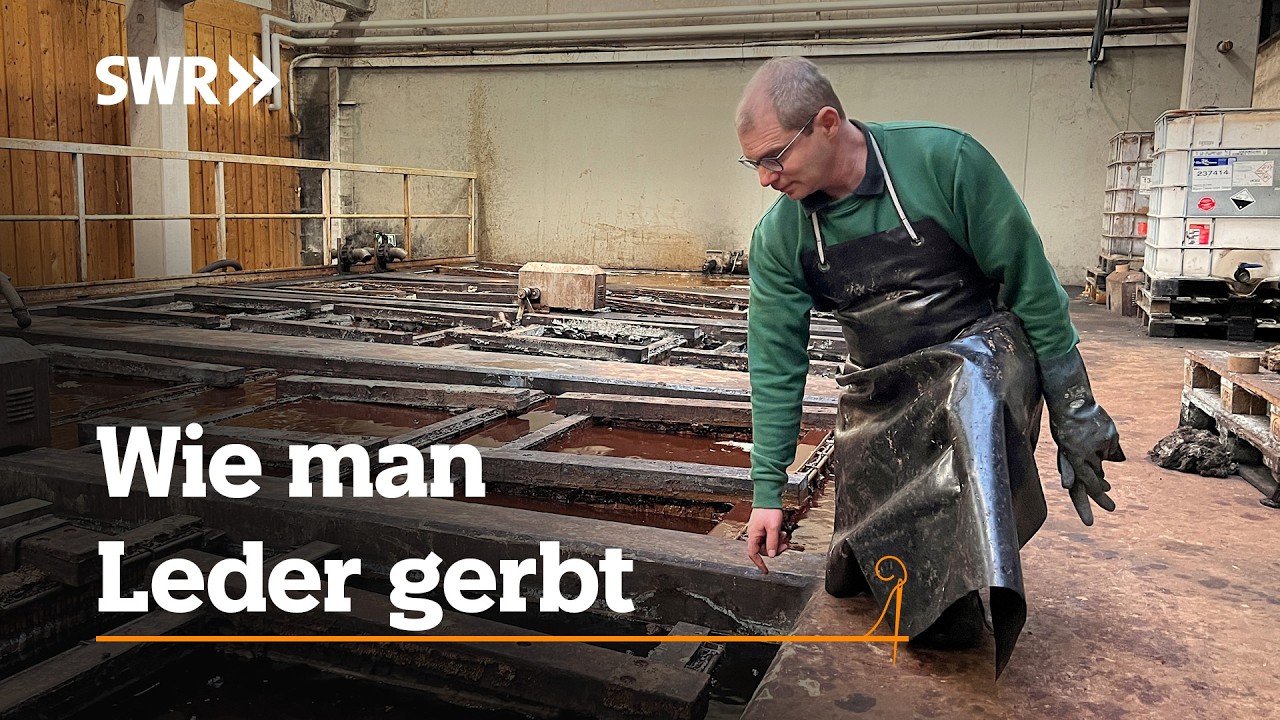

Not a shoemaking video, but a video about Gerberei Martin:
@thenewreligion, I think you’ll enjoy this one. Lots of discussion of different tannins. Even some camera footage inside a rum while it’s turning.
Those swr videos are great

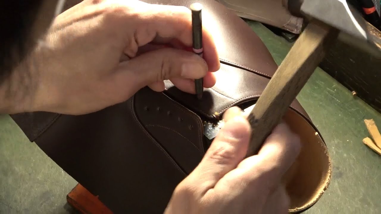

I think So Tsuchiya has folded a few toplines in his time:
That marching line of cuts is impressive. Like watching a chef with really good knife skills.
The waffle pattern reinforcement he is using is interesting. Reminds me of shelf liner.

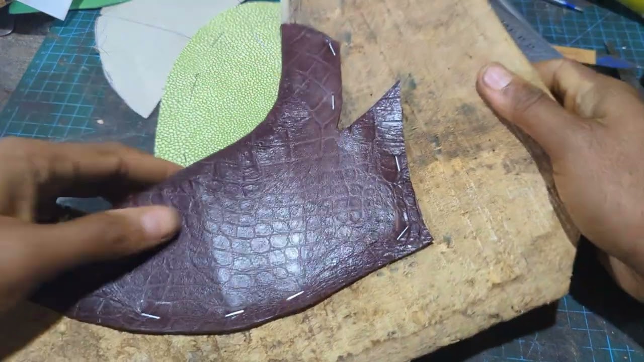

Came across this last night regarding techniques for crimping
Victor’s great! His patterning videos had a big influence on me.

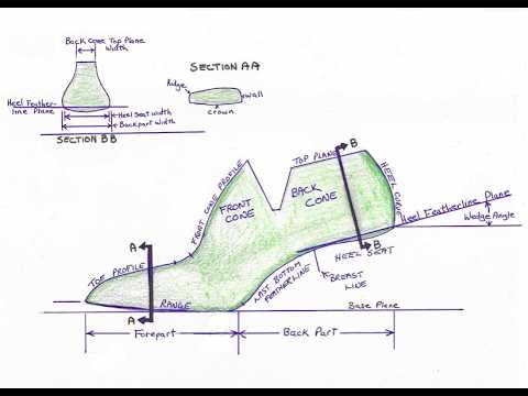

Notes with screenshots of diagrams and document pages: The Anatomy of a Shoe Last | shoemaking.wiki
Bill proactively chose the Creative Commons Attribution licensing option on YouTube. A real gift!
