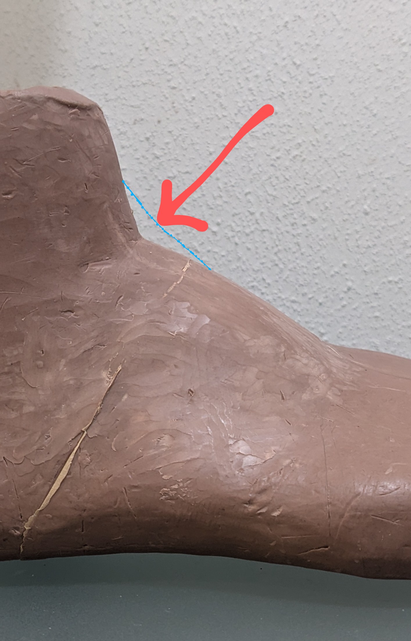

There are many ways that feet and lasts differ. The particular question I have now is about where the ankle meets the foot at the upper instep. Most feet have a pretty dramatic change in angle as their shin meets their foot. But last don’t have this.
Additionally, as I’m trying to make sure that the short heel measure and upper instant measure are correct, I also get this “kink” at that point (red arrow). Should I be filling it in and accepting larger measurements than what is accurate to the foot at the upper instep, small heel measure, and ankle?
In what way are lasts different than feet at this point?

Last shapes do differ from foot shapes. You’ll see that even comparing boot-height lengths that model the transition from foot up through the ankle to the lower leg. For one thing, lasts usually have a pronounced “cone” shape with sharp ridges up the insteps. These are really handy for patterning, pulling over, lasting, and delasting, but not direct copies of any structures in feet.
On the other hand, I think your clay model might be exaggerating the differences a bit. Did you sculpt or cast your model based on a foot without any heel elevation?
Even if you’re planning to make a last without any heel spring, you may still want some changes around that area. If you put your foot flat on the floor and wiggle your toes even a little bit, you may see tendons rise and fall in that area, like the fingers of a puppeteer pulling strings. It’s easy to cause pain binding too tight around that part of the foot.

I see what you mean about not being too tight at that point. Would you recommend adding a transition at that point as the blue line shows, and not being too strict on those measurements being larger than the foot’s?

I took a peek and it seems that they don’t do that transition to the leg.
So I’ll either leave it as is and see what happens, cut the leg part off, or add material at that portion of the last. Given it’s a low boot, maybe it won’t matter too much on the end. Even though you don’t have experience with zero drop, I’d still be curious which one you would choose.
