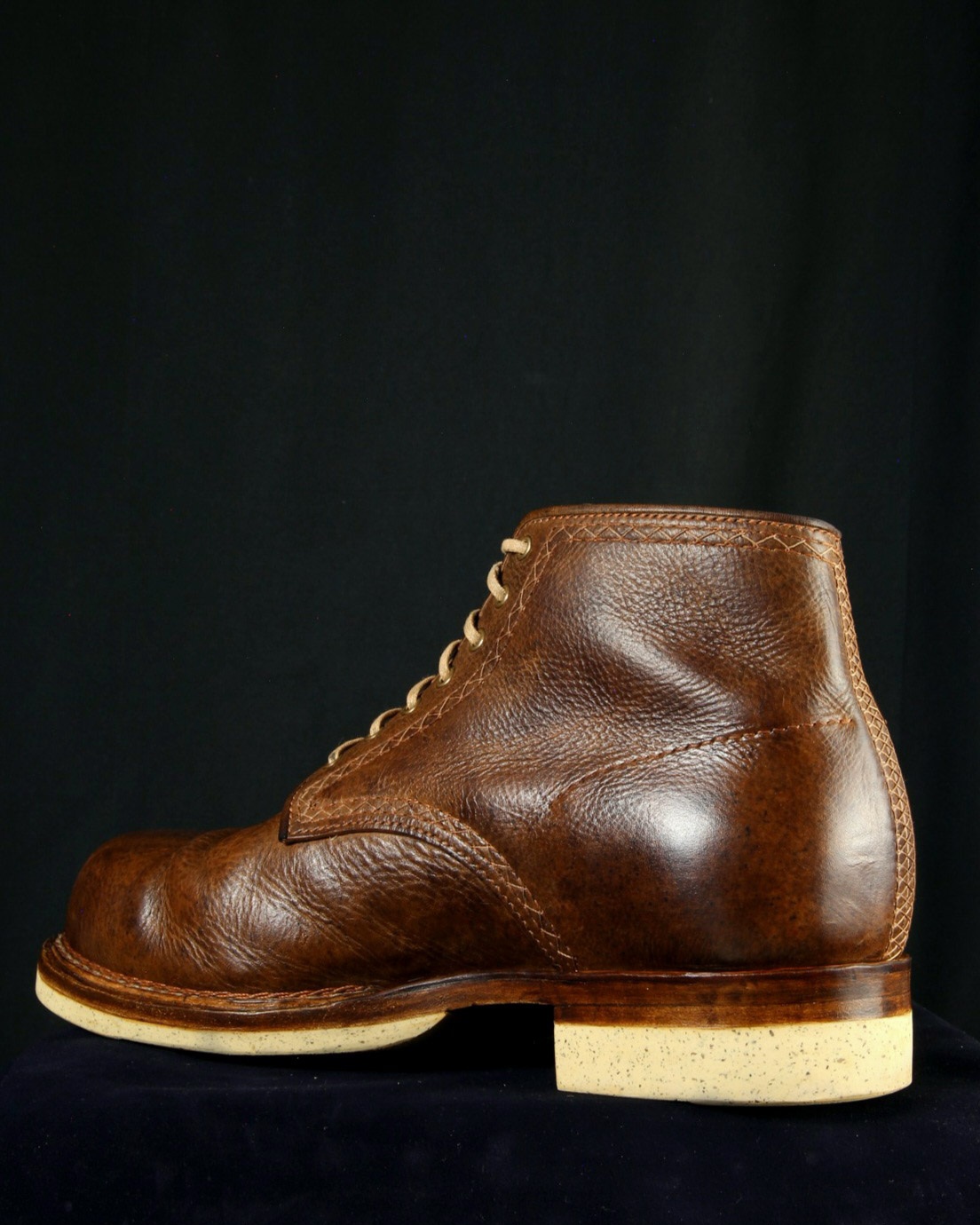

Also, working on this whole “taking boot photos” thing. Couple weeks of wear on these and they’re picking up some nice rolls.

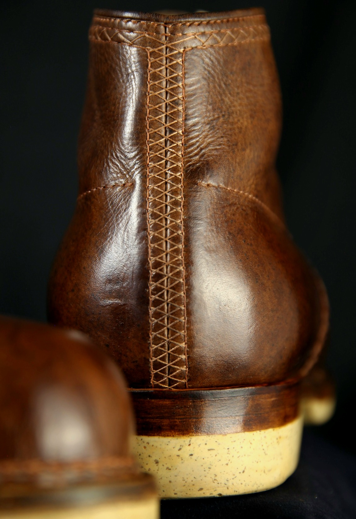

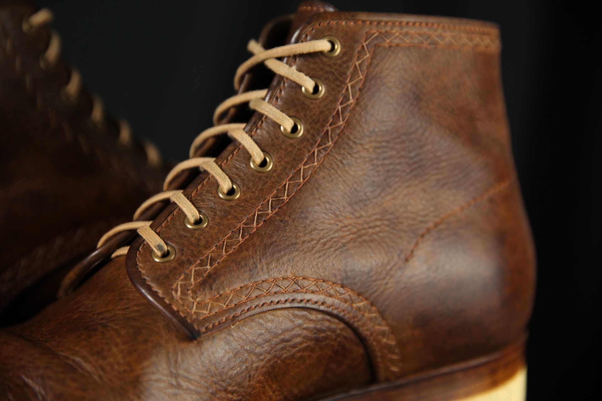

After a month of 5-6 day per week wear, this leather is developing a lot of really interesting textural differences. Surprisingly high gloss too
Very nice!
