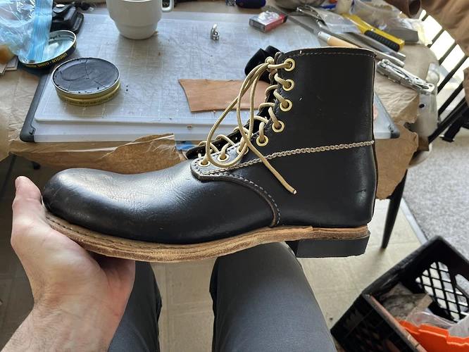

I created a little Web page about the first pair of boots I ever made, which I’d like to copy and paste here.
I really benefited from taking a little time after finishing the project to pause, gather notes, reflect, pull together photos, and post somewhere that I could share with others. I also find it really encouraging pulling together a list of thanks: I was already feeling very encouraged and supported by lots of shoemaker and fellow hobbyists, but seeing even just some of those people all in a list only made it more clear what a welcoming trade I’d bumbled into.
Overall
| Design | Ankle-Height Work Boot |
| Last | Built-Up Munson 11½A from Sorrell Notions and Findings |
| Pattern | Original, From Tape Last Forms, Fully Lined, Symmetrical |
| Closing | Hand-Sewn Saddle Stitch |
| Construction | Hand-Sewn 270° English Welt |
| Timeline | January to March, 2024 |

Thoughts
An enormous learning experience. My hands hurt and my apartment is as disaster. I’ve a whole stack of notes to pull together for the next pair.
In the end, these aren’t going to be wardrobe champions. The creasing—I should really say folding—of the loose vamps over the balls looks horrific. But the fit elsewhere was a revelation. I think I said “oh, Lord” three times in disbelief right after putting them on. That’s not a thing I usually say.
I spent weeks and weeks looking forward to this pair. But more or less as soon as I got far enough to call them “made” and try them on, my mind shifted entirely to the next pair. There’s a massive number of relatively small, clearly doable ways to improve from here, and doubtless more that I can’t yet see. I’ve taken the leap from watching others prove bootmaking is doable on video to living through actually doing it, and getting close to an end-product I would value.
